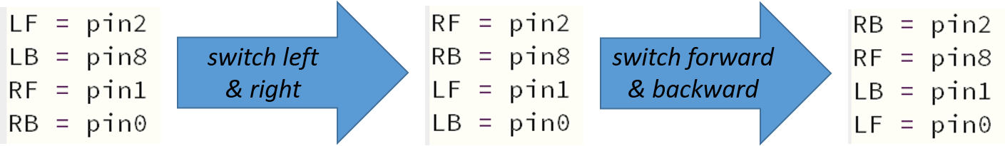

SETTING-UP THE MOTOR DIRECTIONS
This program will turn the motors on in different directions when you press the 'A' button on the micro:bit.
What you want to happen is:
- When 'A' is displayed, left motor forwards
- When 'B' is displayed, left motor backwards
- When 'C' is displayed, right motor forwards
- When 'D' is displayed, right motor backwards
This will probably not be the case, as it depends on how you have wired up your robot!
At the top of the code, you will find a list of variables, which determine which pin on the micro:bit control which motor direction.
If you are using one of our robots (files), swap the variable names around to make the robot move in the correct directions:
If you are using a robot of your own, check which pins the motor driver is connected to before editing the code.
