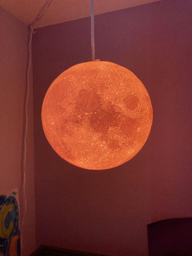

Step 5: Modelling Sphere Lamp Like a Moon
Ok, we have very good map data now, then how can we 3D modelling a sphere lamp like a Moon?
When the lamp turned off
The Moon lamp should be able to show the Moon actual surface details. It is relatively simple, most 3D modelling software can use bump map data to make it.
When the lamp turned on
The Moon lamp should look like the Moon we can see in the sky, i.e. the details of color map. Yet we can direct 3D print different colors easily, fortunately Moon nearly look like in grayscale. We can use the shell thickness to adjust how much light goes out from the shell, so that we can project a grayscale image on the sphere lamp. This technique is called Lithophane. It is not a new 3D print invented technique, it already appear nearly 200 years.
Combine Together
The sphere modelling with bump map is a solid object with surface details. As a lamp shade, we need to make it hollow. The shell thickness on each point depends on the color map value, thicker means dimmer (darker).

Step 13: Material Light Transmittance & Color Variance
I print all my Moon lamp with white PLA filament. However, not all white PLA are the same on light transmittance and color variance.
The above picture show 1 plain PLA and 5 white PLA filament from different vendors. Which one is the best is very subjective, but lesser color variance should be better. Higher light transmittance require thicker shell but have better grayscale level; Lower light transmittance require thinner shell and can save much printing material and printing time. The Moon lamp printed in this instructables is using the bottom right one, no notable color variance and lowest light transmittance.
Note: if you have more than 1 type of white filament, you can make a similar test with the attached STL.
Step 14: Shadow Factor
The generation script I written in BanateCAD have some parameters that can adjust, e.g. height and shadow factor.
The shadow factor is very depends on the filament light transmittance attribute and also depends on what light source you use. Higher light transmittance require larger shadow factor value; brighter light source also require larger shadow factor value.
The above 2 pictures use same white PLA filament, the first one set shadow factor 6 and the second one set shadow factor 8. Larger shadow factor value make higher contrast level but at the same time you can see more filament color variance.

Step 19: Ornament Lighting
This Moon Lamp is very high detailed even 1.5 / 2 inches in size, it is very good make it as an ornament. E.g. Christmas ornament on the Christmas tree or a keyring you can bring every day. You only require a tiny LED to light it on.
Note:
I have prepared the STL from 1.5 to 3 inches that can fit the above tiny LED, you can find the STL at Thingiverse filename tailing with "_Y170_Ornament.stl".
Ref.:
