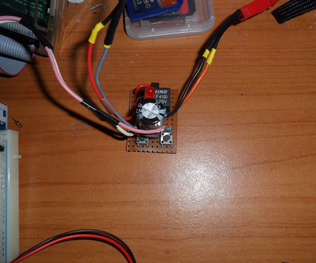

Step 2: Assembly & Testing
Put it together as per the schematic.
Start with the power supply and voltage regulator, test it to make sure you got it right and you have an output of 5V
Assemble the TCRT5000 next, test to see that you have an output of some voltage (around 1.2V) between the resistor R1 (4700Ohm) and the collector of the TCRT5000. It should drop significantly when IR light is reflected onto the sensor.
Assemble the Transistor connecting the Emitter to ground and the collector to the -ve of the LED strip. Connect +12V to the +ve of the LED strip.
When the TCRT5000 is "open" the LED strip should light up. Put a flat (ideally reflective) surface close to the TCRT5000 and it should turn off.

I held my circuit board in place with a plastic bracket I 3D Printed and some hot glue. Any non conductive material will work however I am attaching my work should anyone want to use it.
