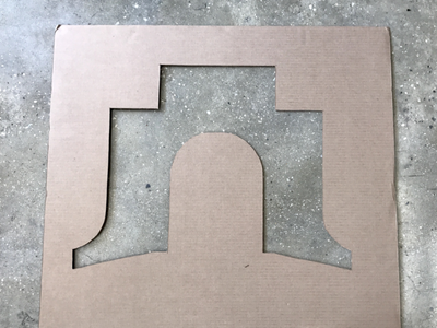

Step 4: Construction of Cardboard Head (bottom)

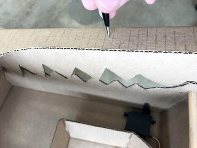

The lower jaw:
- Cut out a pattern for the lower jaw, keeping dimensions in line with the upper jaw. (Image 2)
- Unlike the top part, this one must include a large cutaway space to allow room for your head and neck while wearing it.
- Add teeth to the bottom jaw. (Image 1)
- Fold and glue the flaps of the jaw in place.

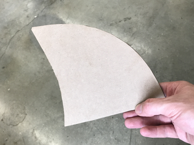

The Fin:
- Cut out a large shark fin and glue it to the top of the mask. (image 3)

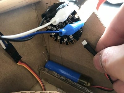

Step 6: String and CPX Additions to Helmet
Attachment of string to Shark head:
- Thread a piece of string or fishing line through the bottom edge of the lower jaw.
- Tie off one of the line ends with a knot and tie the other end to the servo arm.
Connecting motor to Shark head:
- Get the servo connector with the circular part and one arm. Attach it to the servo motor. You may need to make adjustments as the horn can fit in different positions.
- Glue servo motor inside the mask. A large dollop of hot glue or a piece of double-sided foam tape works well for this.
