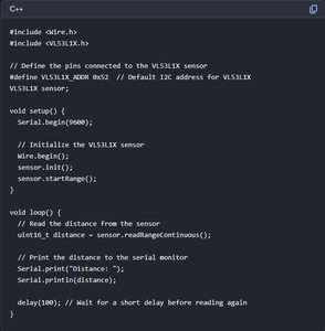

Step 1: Test Your Parts
Before getting started on soldering all the parts together it is important to test them.
Loosely connect the Time-of-Flight Sensor to the Arduino Nano and connect the board to a computer with Arduino IDE installed.
The sketch attached to this step came from Copilot (the Microsoft AI tool) and works well enough to test the sensor and readings.
Make sure to download the necessary libraries on Arduino for your sensor.

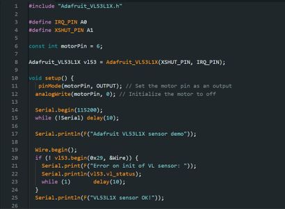

Step 4: Test Your Circuit Pt. 2
Now you should have your circuit connected and (hopefully) functional.
Use the sketch attached to this step or write your own to test your circuit.
In the "Loop" you can see the conditional statements for the reading and their outputs to the motor. Feel free to change these values to suite your needs. I have the vibrations pulsing, but you can set it to be a steady output instead.
The image here is from an earlier version of Project: Blindsense using an Arduino Uno.
