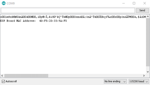

Step 2: Get the MAC Address of the Receiver Board
To get the MAC address of the board upload this code to the board.
#include <ESP8266WiFi.h>
void setup(){
  Serial.begin(115200);
  Serial.println();
  Serial.print("ESP Board MAC Address:  ");
  Serial.println(WiFi.macAddress());
void loop(){
Then open the serial monitor, and reboot the board.
If done correctly, you should see the MAC address in the console.
The MAC address of this board is 40:F5:20:33:9A:F5

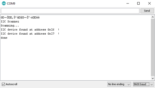

Step 7: Get the Displays' Addresses
To get the displays' addresses, upload this sketch to ESP.
https://playground.arduino.cc/Main/I2cScanner/
Then open the Serial Monitor, and set the baud rate to 9600. If you've done everything right, you should see the display's addresses.

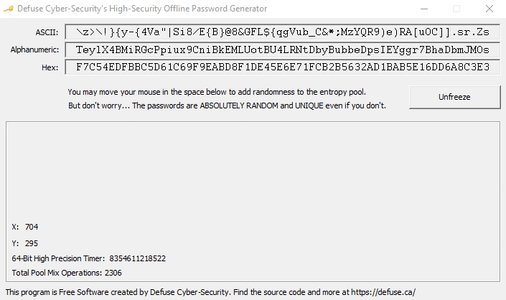

Step 8: Generate the Keys
Triple DES requires three 56-bit keys. You can generate the keys by any means possible.
I can only suggest a program to do so https://defuse.ca/passgen.htm

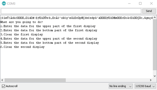

If you did everything right you should see the menu.
Step 14: Run Some Tests
Now it's time for a little user's guide.
Choose the option in the menu, enter its number to Serial Monitor and press the "Enter" button on your keyboard.
If you've chosen to enter the data for some part of the display, then enter the data you want to encrypt and send to the receiver and press the "Enter" button on your keyboard.
