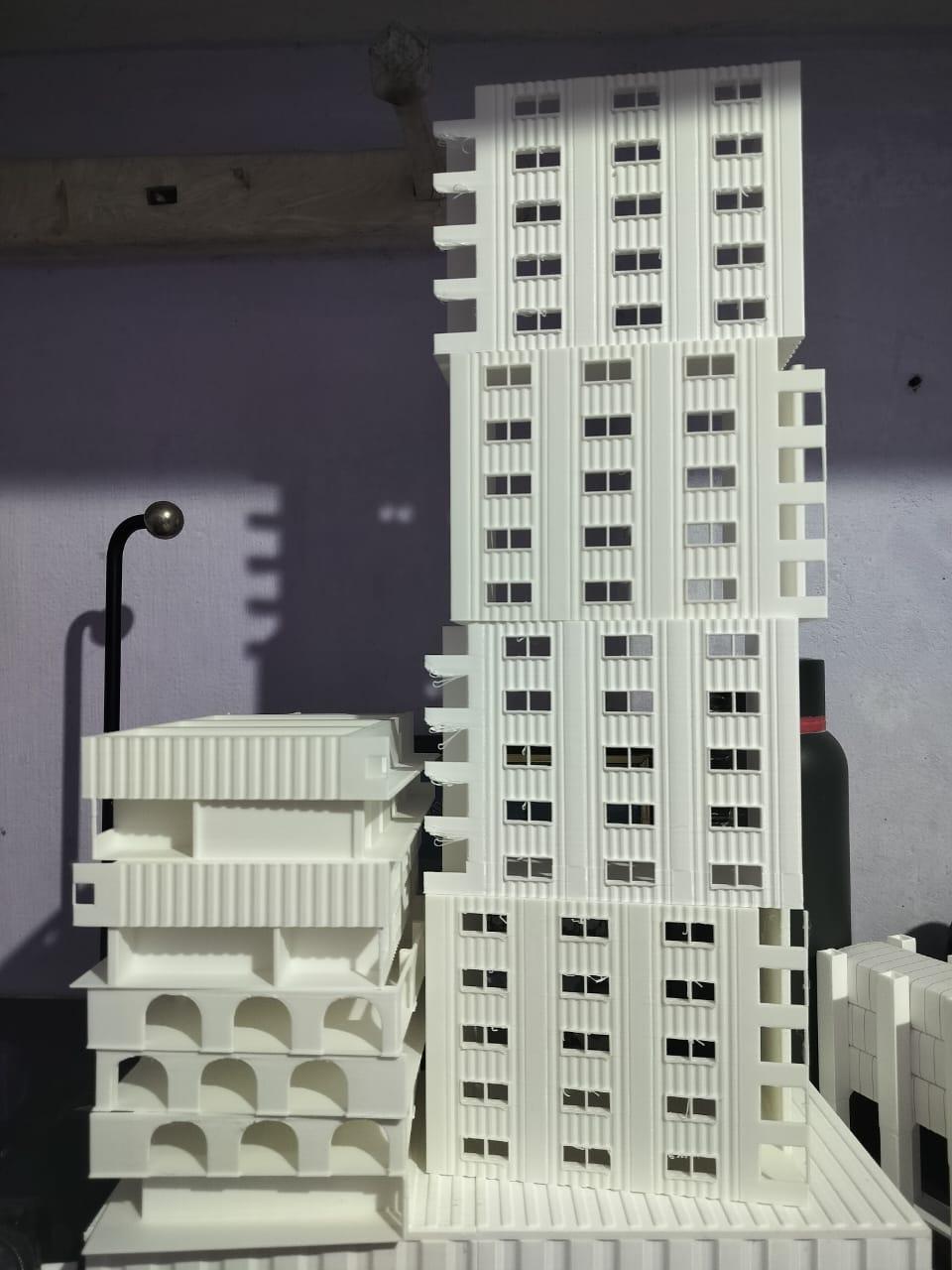

  1. Revit (for architecture planning)
  2. Fusion 360 (for creating 3d models of the prototype)
  3. blender (for animating)
  4. and a chunky PC!
  5. 3d printer

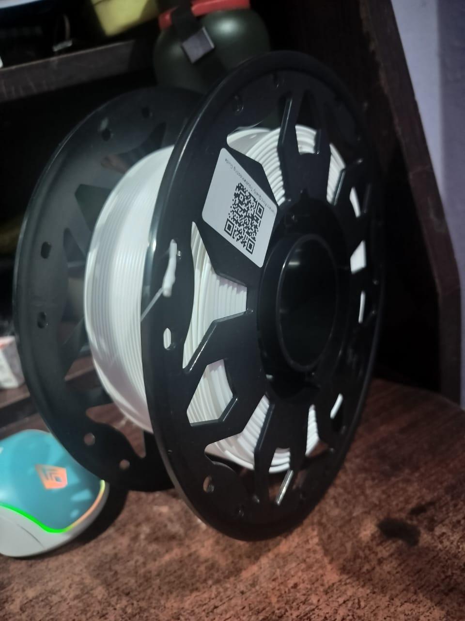

  6. 1kg pla filament (or more).

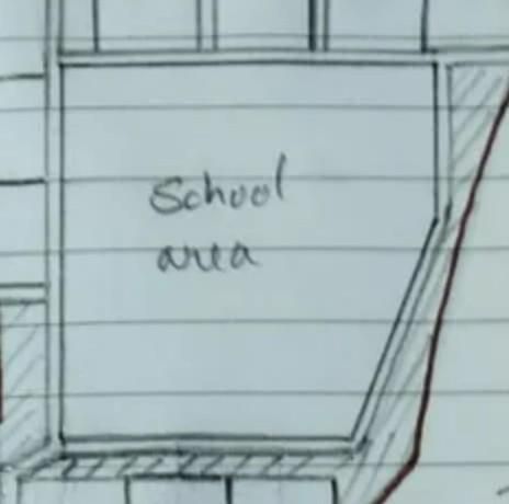

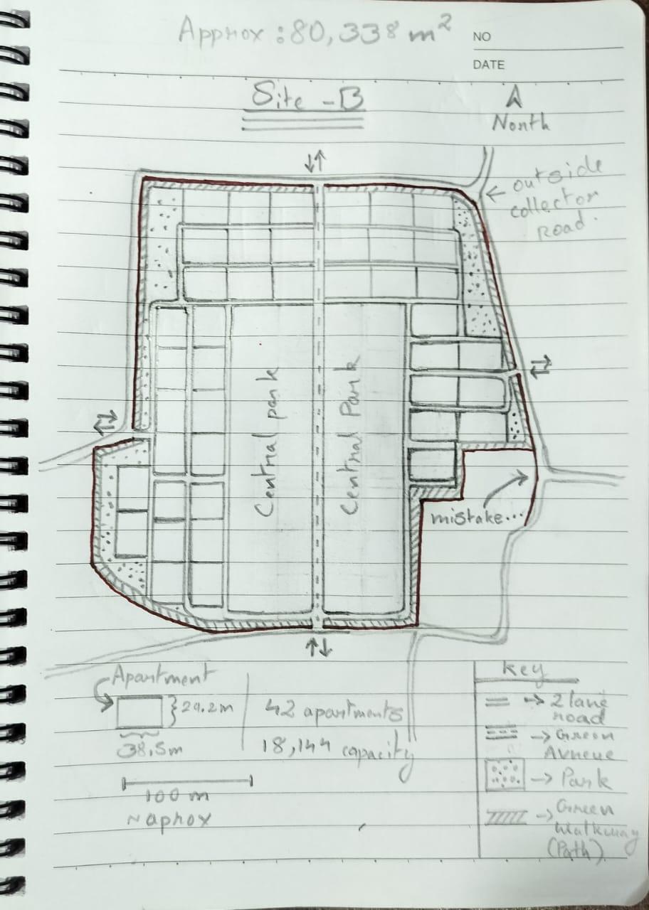

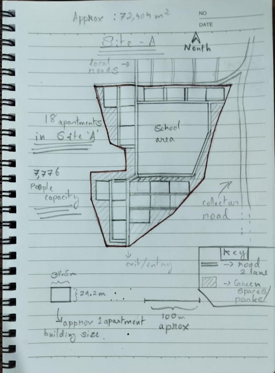

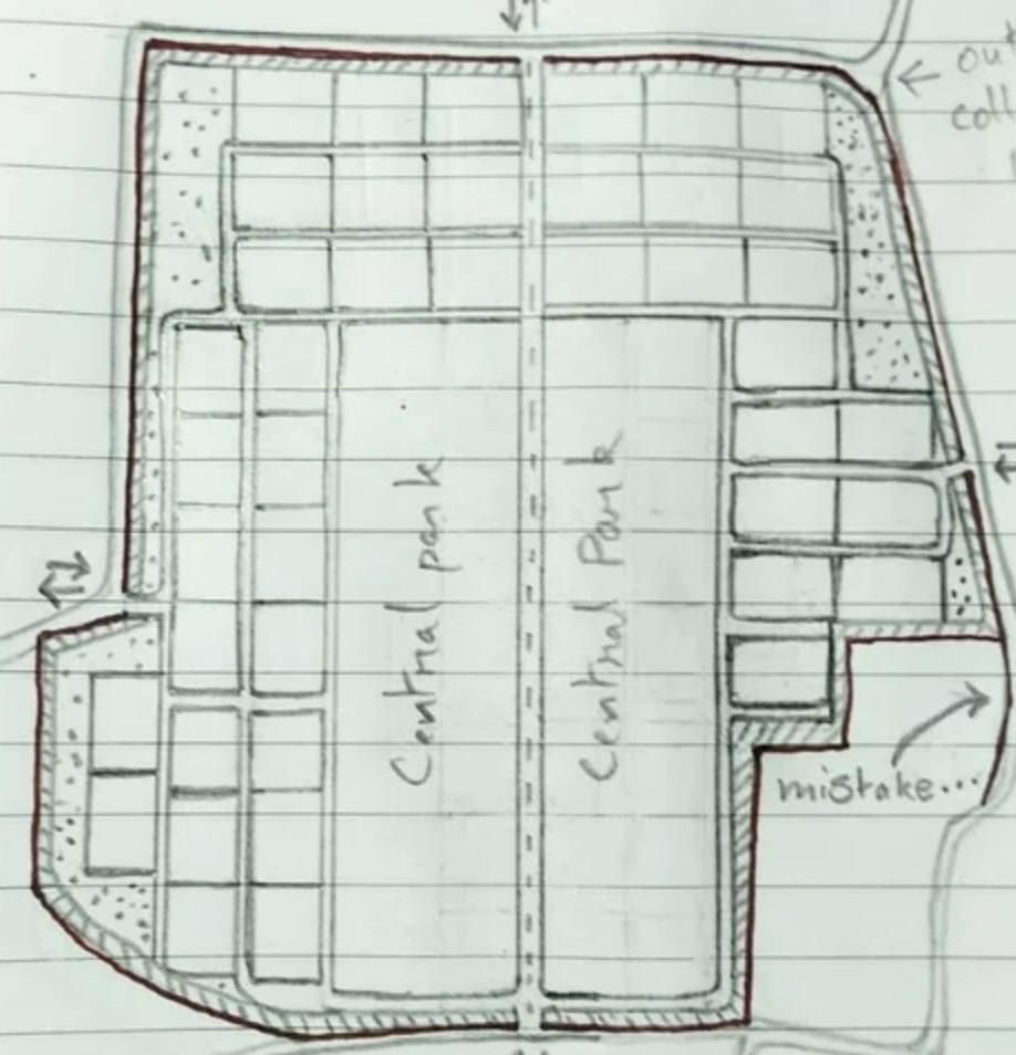

Step 2: Site Analysis
As we can see, there is 2 blobs of land that the slum occupies. The left-hand side we shall refer as Site A and the right-hand side as Site B
Site Analysis:-
  1. Has an area of roughly 145~150 thousand sq. meters and a population of 25000+ and a population density of 2000/hectare.
  2. Has urban amenities near the vicinity as it is near the centre of Pune(within 3km radius).
  3. In between the 2 areas of the slum there is a hospital.
  4. Land is mostly level throughout the area.
  5. Soil type is mostly shallow, well drained, clayey soil with mild erosion.
  6. Not much free space available near the site. There is a 'Pune race-course' at 2.5km to the east of the site.
Overview:-
  1. Area is limited, hence we shall focus on maximising vertical space usage and efficiency.
Location is highly valuable as it is near the Pune city centre and proper development of the site can increase the household property value of the residents.
  1. Need to integrate mixed use of spaces.
  2. Level terrain allows for easy deployment of pre-fabricated rooms and installing them on site.
  3. Clayey soil can cause sinking, hence deep foundations need to be built.
  4. Erosion is minimal, hence slope stabilization is not a major concern.
  5. Due to limited space, the Pune race-course can be leased (part of it) to temporarily house the inhabitants while their respective area is under construction.
  6. Construction must be done in phases to ensure minimal displacement.
This project focuses on well-planed housing redevelopment rather than forced eviction.

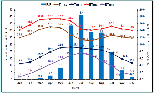

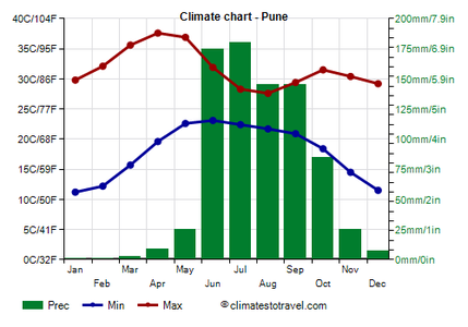

Step 3: Weather/Climate
Since Pune is near landlocked region, it would be quite hot in the summers and cool in the winters. In India, monsoons are usually heavy. (honestly I feel the monsoons are the only time it gets cool here)
Weather Analysis:
Tropical: Hot and dusty in the summer, monsoon with heavy rainfall. winter is cool and pleasant.
Rainfall: average of 721mm of annual rainfall.
Temperature average (highest/lowest) in degrees Celsius:-
  1. March 35/16
  2. April 38/20
  3. May 37/23
  4. June 31/23
  5. July 28/22
  6. August 28/21
  7. September 29/21
  8. November 30/15
  9. December 29/12
Average Humidity: 69% (That is real...)

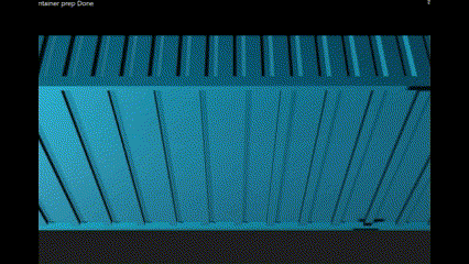

Step 5: Preparing the Container
Preparing the Container before turning it to a space to live in is a very important step, hence from here, I prepare the container to make it a more comfortable space.

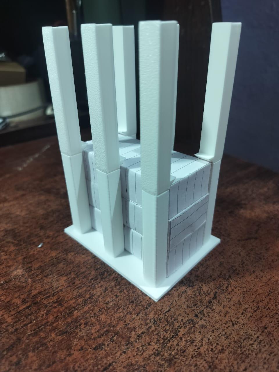

Step 6: Specifications
For this project I shall be using the two '40ft high cube container' as it the perfect size for the density in hand.
With a total living space of 66msq it is spacious enough for up to 4-6 people.
Dimensions:-
Ext: Length- 12.19m, Breadth- 2.44m, Height- 2.89m
Int: Length- 12.03m, Breadth- 2.33m, Height- 2.69m

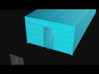

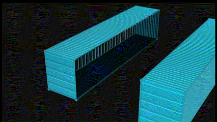

Step 8: Joining the 2 Containers
The 2 40ft containers shall be joined along their sides to make it more spacious.
Steps:
  1. For each container, the respective sides that will be joined, at the mid section underneath the container, a steel plate is welded so that it will act as a stand like the 4 corner foot of the container. It is made sure that the height of the steel plates matches the gap between the ground and the foot's height. This prevents the container floor sagging in the middle over time.
  2. Now before the respective side walls are cut open, a small section of the container's wall is cut first to install the temporary support so that the roof of the container does not sag.
  3. Once the temporary support is installed, the respective walls are cut and dropped opening the containers at the facing sides.
  4. Add struts at every 2nd corrugation in the container walls so that it will form a rib to strengthen the container.
  5. Join the struts and weld shut the containers together to form a water proof seal at the welding.
The 2 containers are joined!!!

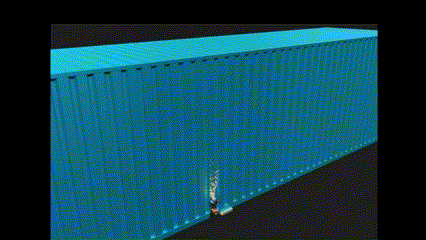

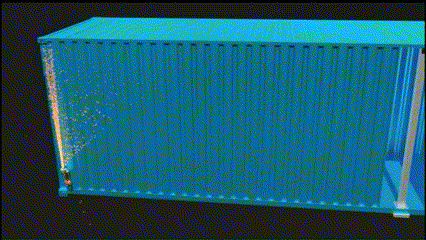

Step 9: Cutting Out the Doors and Windows
The doors and windows are cut out according to the design or floor layout.
The windows are on a fixed position in the container (At the door end. I plan on sealing the door and using the rear end as the new entrance)
We have doors and windows!!!

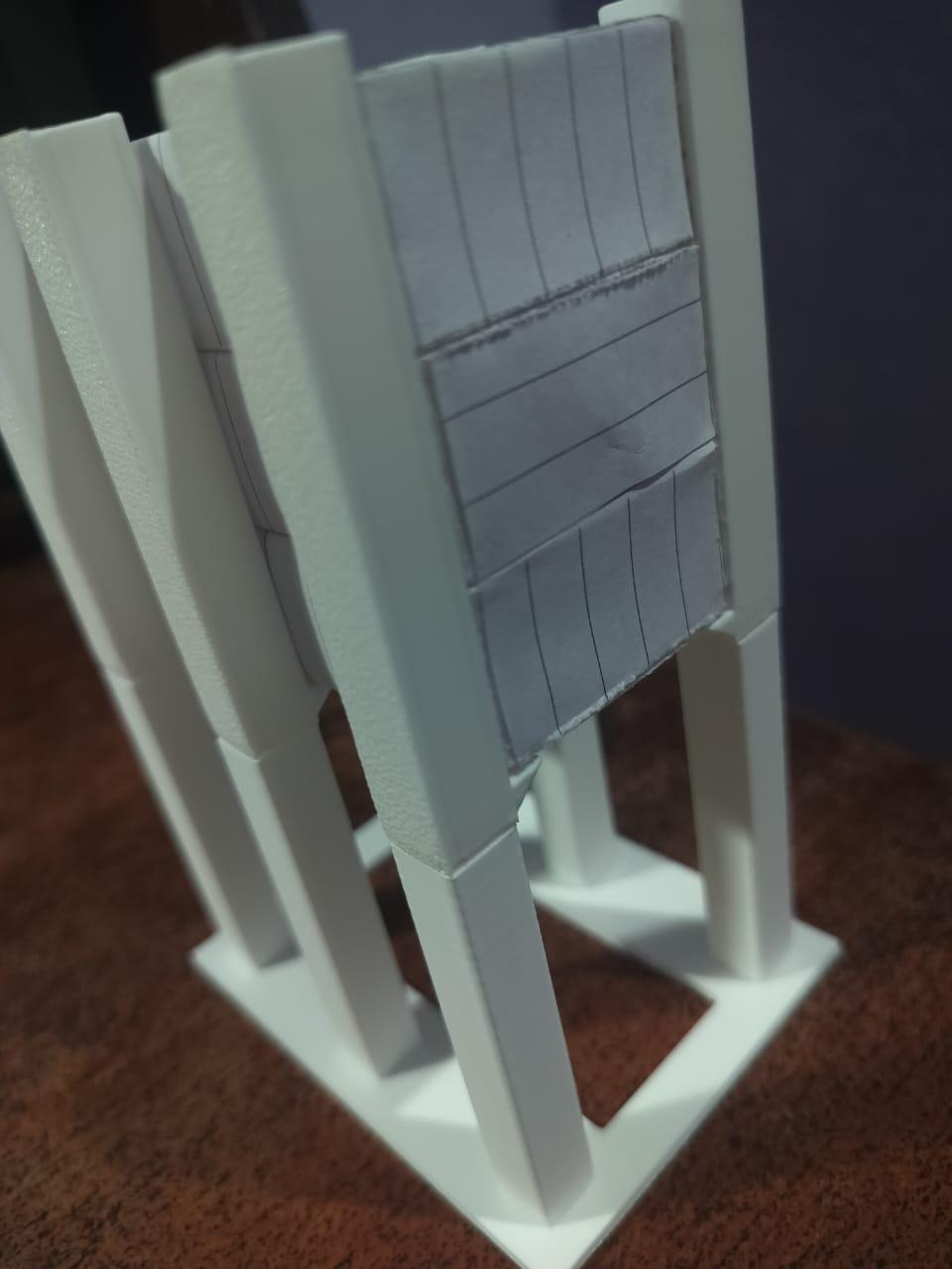

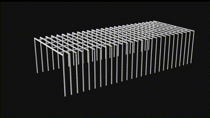

Step 10: Structural Stabilization
To Stabilize the structure of the container and also to make it more stronger:
  1. At every 2nd corrugation of the container wall, we install galvanized steel struts before the containers are cut open.
  2. The struts runs along the 2 sides of the container (The side wall that is not cut and the roof).
  3. When the container is joined, we can weld all the struts together to form a series of ribs like structure that support the weight of the roof.
  4. Additional steel struts is added in the interior walls of the container home once the layout is decided.
  5. The layouts that I came up with all have at least 3 interior walls that can support the roof.
Structural Stabilization is complete!!!

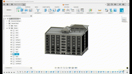

Step 12: Designing the Container Home
from here on I design the container home.

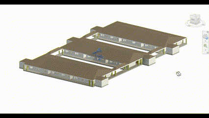

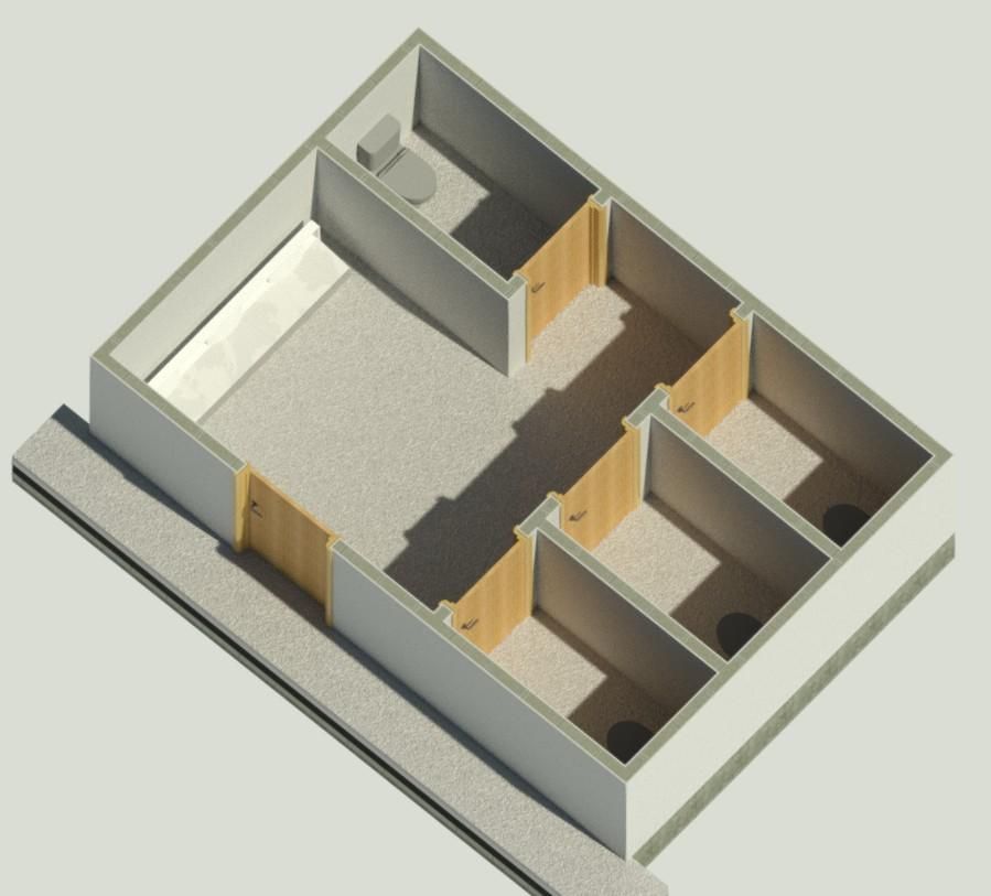

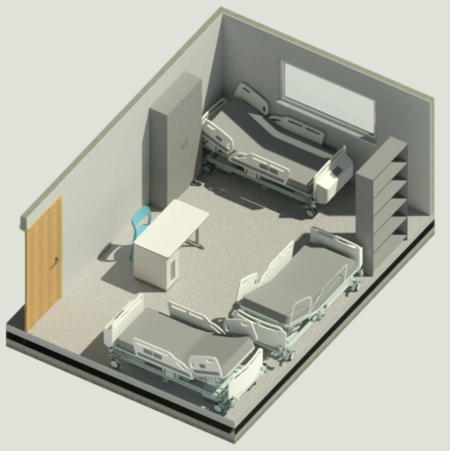

Step 13: Revit Floor Plan
Designing the floor plan using Revit.

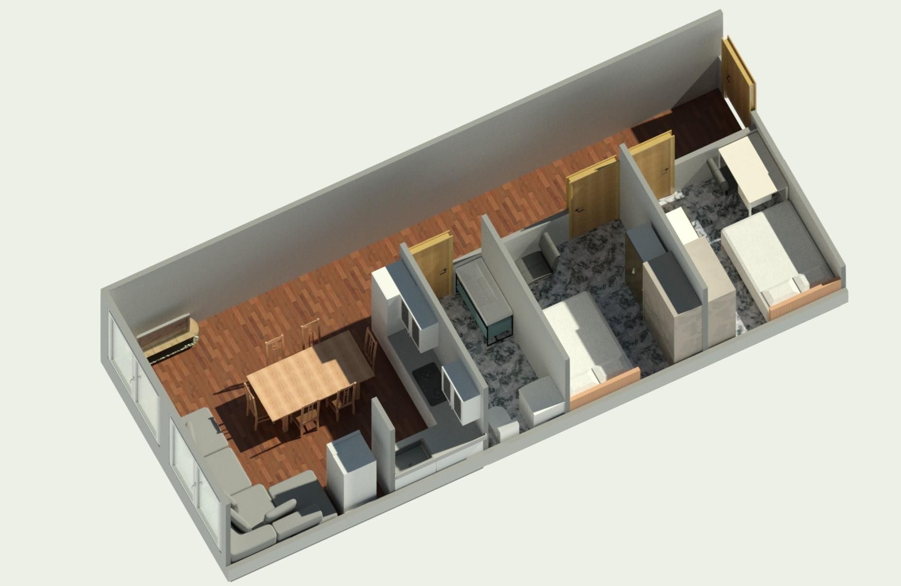

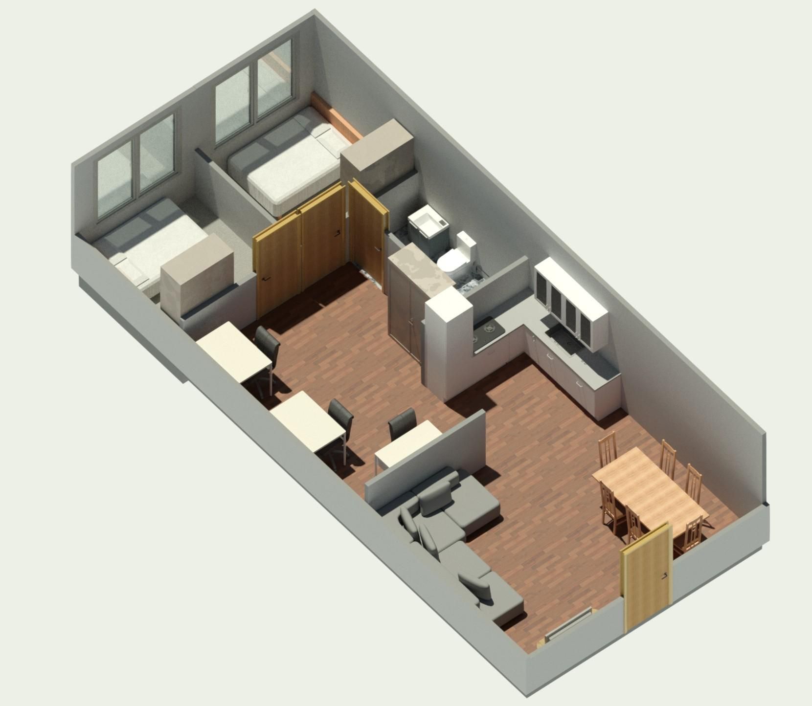

Step 14: Floor Plan Types
I designed the floor plans using Autodesk 'Revit' (Amazing app!!!)
The design is done using a few things kept in mind:
  1. The apartment needs to have rooms kept side to side to meet the target population density per hectare.
  2. The apartment can have a maximum of 6-7 floors due to structural constraints.
  3. Hence only 1 side of the rooms will have access to windows.
  4. 2BHK, 1 bath w toilet room.

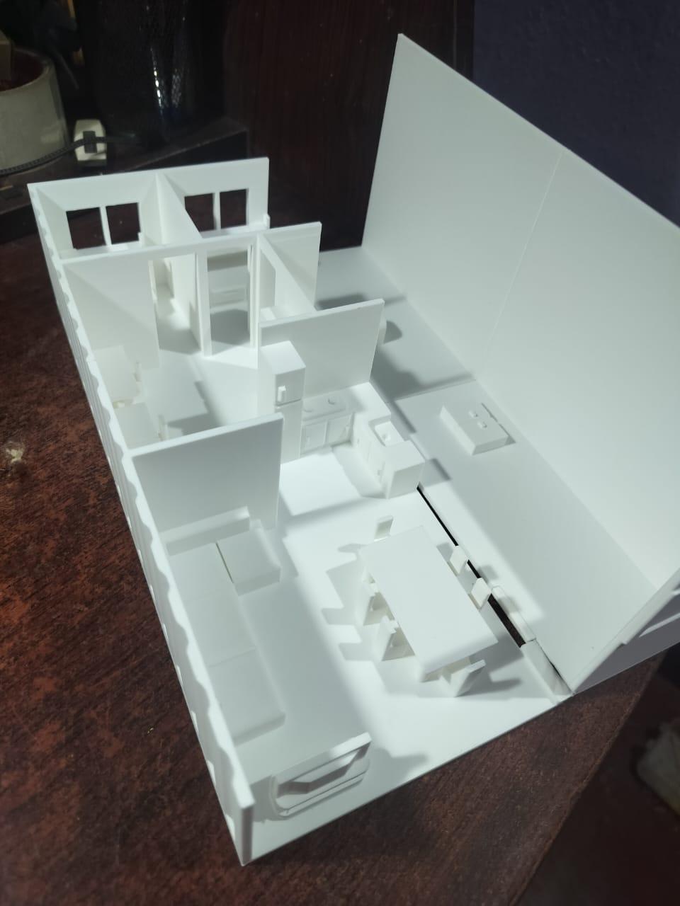

I made 3 types of floor plan that emphasises on 2 main ideas:
First Type - The Living/ kitchen is at the end which makes it the only room with windows. In this layout, the room where the family is going to spend the most time has the access to sunlight and the outside.
type 1
Second Type- Here the two bedrooms have the access to the windows. This layout emphasises on the kids that may be in the family and their study areas have access to the sunlight. type2
Third Type- Here the Bedrooms again have the windows, but more room is given to a 'study area' in case there is more than 2 kids.

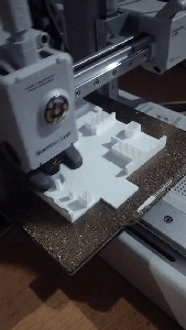

Step 16: 3D Printed the Floor Plan
I 3d printed the model of the layout of the floor plan so that it is easier to see and feel how the layout will be.
Model
Before Printing:
  1. Take sure to adjust for any contacts, gaps and other parts because dimensions in real life is different than that in the 3d modelling app. (due to printer accuracy little errors etc, whereas in the software it is perfect)
  2. The printer is working fine.
  3. you have enough filament.
  4. You slice the model before you print it.
for more details on how to 3d print, pls refer:-
https://www.instructables.com/Dougong-an-Ancient-Chinese-Technique/ (under Steps 9,10, 11)
For those who wish to print it, the stl files are given below:
Step 17: The Apartment
In this step (video) I design the apartment Autodesk Revit.
The apartment has 7 floors in total (6 floors are living spaces) and a roof top garden.
The ground floor is open and allows for vehicle parking of cars and bikes (mostly a bikes and cycles) and has multiple access points.
There are 2 staircases and 4 elevator shafts in the apartment, 2 elevators on each side. Each floor has 2 garbage chutes that are connected to the ground floor in the waste collection and disposal area. The ground floor also has a mail room and two security rooms.
The roof top has plenty of green spaces and open spaces too for kids to play in. The open spaces are in the in the middle so that kids will not play around or near the railings. There is also a large, covered terrace that can be used primarily for hanging clothes as that is an important feature in the Indian culture.
Speciality: ---
  1. Each floor has 12 - 2BHK rooms which can house up-to 6 peoples each. This makes it 72 people in each floor and a total of 432 people in one building.
  2. The building has a net footprint of 1146m^2 hence by calculating the density (432/1146 m^2) is about 2.65m^2 per person.
  3. In the slum condition, the average space per person is: 5.832m^2 per person, taking there are 25000 persons in an area of 145,880-meter square.
  4. This is a major advantage as it reduces the area occupied by the slum hoses of 145,880 m^2 to about 65,646 m^2 of buildings, which gives plenty of space (80,234 m^2) to non-housing buildings like schools, hospitals, roads, parks etc.
  5. Removing spaces for the roads and spaces around buildings, there is still about 55,321 m^2 of space left (if the apartments are placed side to side with minimal gaps, it saves even more space).
Step 18: The Apartment Frame
Concept:
I plan to stack the each room 3 times on top of each other twice. So a total of 6 floors. The containers will be supported on steel beams that will take the weight of all the 6 containers.
  1. Stacking System:
  2. Containers are stacked three times, one on top of the other.
  3. Steel Beam Support:
  4. Containers are slid into steel beam frames, which bear the weight of the containers.
  5. This ensures Each container only carries the weight of two containers above it at maximum.
  6. The steel beams take most of the structural load.
  7. Load Distribution:
  8. Once three containers are stacked, another steel beam support is added on top.
  9. This repeats for the next set of stacked containers.
  10. A total of 6 floors (6 container homes).
  11. The steel beams disperse the weight of the containers and any above structures directly to the ground and foundation.
  12. This prevents excessive stress on individual containers.
Step 19: Stress Testing the Frame of the Apartment
We will be using the HSS or Hollow Structural Section (HSS) – Square, rectangular, or circular steel tubes for columns. (Square ones to be more precise)
The steel support beams will be the 'HSS 350 x 350 x 16 mm square steel column' and they will be the main backbone of the apartments. The joints can be either welded or bolted, but I prefer it being bolted just in case we need to disassemble it for renovation or other purposes. Also, welding it all will cost a lot of money.
For reference, A single average HHSS 350 x 350 x 16mm beam at 40 ft tall can hold more than 79 tonnes at safety factor of 1.7! (That is if we apply all that weight on the very brim of the column which is not very ideal in real world conditions... But that is strong enough!) And if the column is braced at every few intervals, it can easily hold 4-5 times that weight.
So, for my model, we will have 6 columns 3 on each side of the space where the container homes will be. At the height of 11.8m, which is a little higher above (30cm) the height of 3 stacked containers, will be I-beams (HEM 550) welded to the columns which will support 3 more containers that is stacked on top of each other.
When I tested the model (as in the video), the platforms can support all the weight at a safety factor of 2+.
This makes the concept of using steel columns for sacking containers very strong and stable. This is also much easier to install and construct than conventional building methods.
The Stress Test: ---
Here, for my stress test, I used Fusion360's inbuilt 'static stress' simulator.
The specification of the test is given as such:
  1. 6 HSS 350 x 350 x 16mm HSS steel columns are pinned at the perimeter of the space where the container home goes.
  2. between each pair of HSS columns an I-Beam (HEM 550) goes across. Thus giving 3 pairs of columns joined with I-Beams. The I-Beams help in transferring the weight of the stacked 3 container to the columns.
  3. 9 loads are distributed evenly at 9 locations i.e. the ends of the I-beam where it is connected to the columns and the centre of it.
  4. The net load is 238 tone force.
Result: ---
  1. Maximum stress of 71.38MPa is at the joints of the I-Beam to the columns and the centre of the I-Beam.
  2. Max displacement of 14.338mm is at the tips of the columns since it sags inwards in between the columns. Adding I-beams or struts or floors will prevent the bending in the columns. (for the test I left it open).
  3. Minimum safety factor at 2.9 at the joints of the I-Beam to the columns and the centre. Maximum is 15+.
Step 20: 3d Printing the Apartment
I 3d printed the apartment at size ratio of about 1:133
I printed the apartment in 18 total pieces as my print bed is only 155mm by 155mm.
In the F3d and the STL file, I have sliced the entire apartment into 4 parts.
to know more about 3d printing, check this out! : 👇(STEP 9)

Step 21: Primary School
The school shall be in 'Site A'.
I designed this school keeping in mind the primary school that I used to go to. I felt that the school I went was good enough to make me who I am today. I never felt there was anything lacking nor the layout or the design and facilities to be bad. Hence what I got back in my tender days, I wish others to get that too as in my experience of my life, my school is the only place like it that I experienced and will ever get to experience, and I will say I was lucky and blessed enough.
So let's spread that blessing!!!

The School Layout:
Layout
The basic school layout. To the centre is the school building, to the east is the auditorium and to the west is the football ground (SOCCER) and pool! (our primary school did not have one, it would be awesome to teach children how to swim early on). Parking is at the front-east of the school.
Classroom: Classroom A place of learning, memories, and gathering.
Computer Lab: Computer LabThe best part of a primary school!!! miss those flash games.
Library: LibraryBooks! and Books!! that's it I guess...
Staff room: Staff roomThe place where the teachers can gather, exchange chit chat and relax! work too.
The principal's office: principle's officeCommand and Control! the room of atmost importance! and posh! sort of...
This is where the guest can visit the school and also is sort of like a wating room also where the school's principal sits and does principal stuff... (No offence, I loved our headmistress! she was like a grandmother to us all)
Toilets: Toilet boysToilet boysThe place where most kids spend time in between the classes... (I never got that tho...why the toilet? what is there that I never knew??? too old for that now...)
Clinic:Clinic Where the nurse can treat children/staff.
Overall: write notes here- power consumption, water consumption wate management etc.
And that's it! half the future of the children of Kashewadi is set!!!

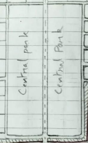

Step 22: Site Plan
I first created a rough sketch in my notebook of the 2 sites.
The slum is divided into 2 areas, here I mentioned them as "Site - A" and "Site - B". "Site - A" has the school and "Site - B" has the central park where a green 4 lane avenue will pass at the middle of it. While designing it, I kept in mind that the area can be developed keeping in mind the essence of walking rather than making large motorways. That is the key concept of this development. Sure, there are roads that lead to the apartments as some space for cars (few... very few) and bikes are a convenience too! The people of the slum might not be able afford vehicles to begin with. There are multiple spaces for plazas so that the people can directly have access to it from the apartments.
In both the sites, where there are 'main roads' i.e. roads where there are public buildings to one side and apartments at the other can have mixed use apartments having commercial at the ground floors (except for the ones behind the school, as having residential behind schools is a good and safe idea).
Since both the site are quite near the city centre of Pune, I felt that it is not required to have separate or specific office buildings as not only the space is limited, but some office space can also fit in the ground floor space too. Tho I have added only some office spaces as having offices requires highly educated workers that takes a long time to sprout.
Also, I do not plan on adding a wall or gates around the sites, as separating the people of the slums from the rest of the populations is meaningless. Walls will be around those areas where there is either a lot of trees or shrubs that are growing at the borders or near areas that are not safe to access.
Let's Dive into the details!!!
SITE A
>>>School Area:
Clinic
  1. The school has an area of about ~9700 m^2.
  2. Has a capacity of up to 1000 students depending on the class layout.
  3. 1st to 5th grade.
  4. Has a football (SOCCER) ground of 25m by 50m (Which can be used for other purposes too).
  5. A basketball court
  6. A pool area having 2 pools of dimensions 15 x 8m one is 1m deep and the other is 60cm deep.
  7. Auditorium that can accommodate all the students.
  8. A parking area.
>>> Green Spaces:
Clinic
  1. The areas that are given by slanted lines spread around the Site is green spaces.
  2. Net area of about ~8260m^2 (11%) of the Site - A.
  3. This area is comprised of plazas and parks with few playground equipments, few pavilions and benches.
  4. This area is made accessible directly to all connected apartments. This creates social and green spaces wherever possible. Since these are open social spaces, there is effectively lesser "Shady spaces" where "shady" things can happen, hence making the society as a whole a nicer and safer place to live.
  5. This area is similar to the picture given below: - (Notice how the plaza is accessible from all directions)
Clinic
image source: South City Square | OCULUS
>>> Roads
  1. 2lane roads that are 7m wide.
  2. No footpaths as the apartment block has enough space around it to accommodate pedestrians.
  3. Simple road with led light post every 38m.
  4. Total length of approx. ~833m. Covering an area of approx. ~4000m^2.
SITE B
>>> Central Park
Clinic
  1. The "Central Park" is composed of 2 halves divided by a 4-lane green avenue.
  2. Total area of approx. ~20,800m^2m (25.8% of Site B).
  3. The central park instead of playground stuff, can have benches, fountains, pavilions and maybe a small (17mx17m) empty space with step benches around it where local teens and adults can play casual sports.
  4. The Central Park can look something like the picture given below: -
Clinic
Something like this but much bigger.
image source: Central Park Common – The Residences at Central Park
>>> Green Spaces
Clinic
  1. The areas that are given by the dots spread around the Site is green spaces.
  2. Net area of about ~6700m^2 (8.3%) of the Site - B.
  3. This area, like site A is comprised of plazas and parks with few playground equipments, few pavilions and benches.
  4. This area is made accessible directly to all connected apartments. This creates social and green spaces wherever possible. No more shady stuff!
>>> Green Belt
Clinic
  1. The areas that are given by the thin striped area surround Site B.
  2. Net area of about ~6600m^2 (8.1%) of the Site - B.
  3. This green belt is mainly a bicycle path with plants benches and other facilities depending on the thickness of the belt in that area.
  4. This area is made accessible directly to all connected apartments. This creates an easy access and transport facility all the way around Site B.
Clinic
image source: Cycling infrastructure - Wikipedia
>>> Roads
  4. 'Site B' has 2.1Km of roads. Covering an area of approx. ~14,700m^2.
Hence in total, Site A has 11% reserved for green spaces.
Site B has 42.2% reserved for green spaces.
That is a LOT of improvement compared to the almost 90-98% spaced used solely for housing in slum conditions.

  7. Design: Container apartment layout, green space, roads.
  8. Demographics: no. of units, estimated families, floor plans.
  9. Utilities: Water, sewage, power supply plan.
  10. Sustainability: Solar integration, waste mgmt, water harvesting.
  11. Phasing Plan: How to build without displacing everyone at once.

  3. 2× 40ft high-cube containers = 1 unit (approx. 600 sq. ft.)
  4. 7 floors, 12 units/floor (except the grnd floor), 2 stairwells + 4 elevators, etc.

  5. Roads (as per 7m width plan with drainage).
  6. Parks, public seating, tree plantation (using low-irrigation species like Neem, Jamun, etc.).
