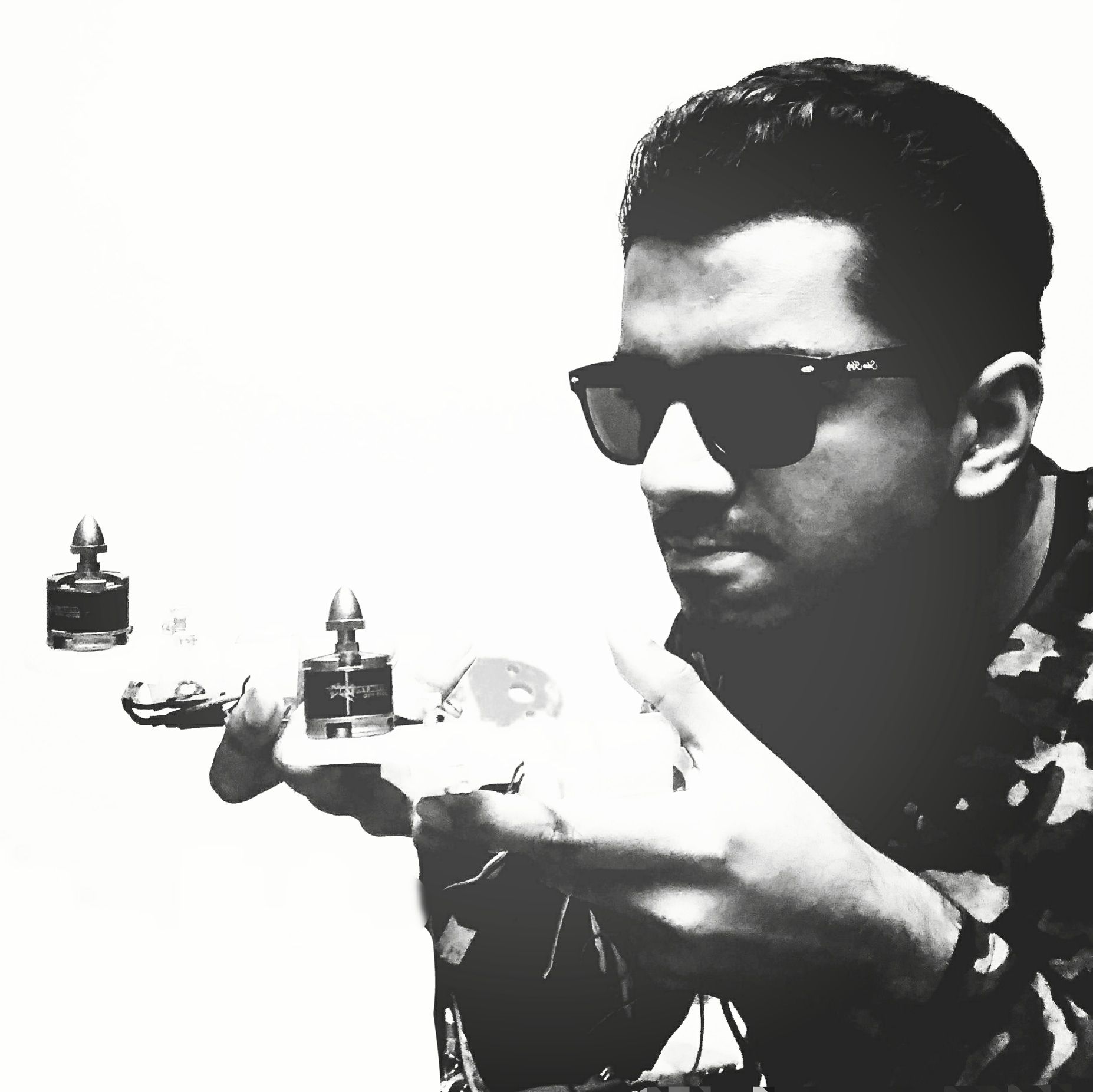

Introduction: Project DEEP
This is a continuous bi-copter project aimed at making low cost & repairable UAVs.
The reason this is concise is that there's already lots of info on other sources & I don't want to drag away from the main focus.
Planned Upgrades-
WebRTC FPV using smartphone & CardboardVR
Battery Swapping Bay
Hand Grips
New design to bring props closer & fuselage even lower.
Present Features include-
WiFi control using ESP8266- using webpage at 192.168.4.1 of the hotspot
MPU-6050 IMU for balancing
Arduino MEGA2560 since we never fully utilise an 8-bit controller.
Major Parts-
2x E-MAX 1KGnm Servo motors
2x Turnigy MK1100 BLDC
1x 1600mAh Turnigy LiPo Batteries
1x ESP-01 ESP8266 module
Misc - Regulators 3.3V, Male & Female Header, 24AWG cables & Berg strips
