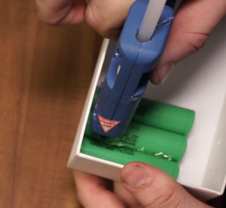

Step 1: Preparing Batteries
In the two pictures that I have shown you can see a few different things. The first thing that I did was find a box that was big enough to fit three batteries side by side. Once I had a box that could fit all three side by side in a corner of the box I did the following things:
- Make sure the single cell 18650 batteries could line up and be level
- Then I would make sure that all of the positives and all of the negatives were lined up correctly
- Making sure that they were lined up I took a hot glue gun and applied a liberal amount of hot glue so that they would stay stuck together
- Then I would flip over the batteries so that I could repeat the last step on the other side of the batteries
- Once the glue was dry I would make sure that they stayed straight then I would remove them from the box and set them aside
- I would repeat this step 10 more times
- Once I was done glueing all of the sets of three batteries I would take electrical tape and tape around them so that the groups of three batteries would stay together

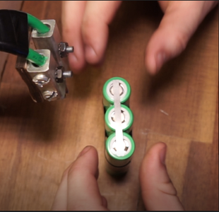

Step 2: Spot Welding Batteries
The next step was to take nickel strips that I cut and line them up on both sides of the battery packs, making sure that they did not extend out over the contact points on each side. Once I had the correct size nickel strips I used our DIY spot welder, set to max power, and did one single weld on each of the leads. Each group of three batteries is welded together in parallel.
Step 3: Cleaning the Spot Welder
Since we built the spot welder ourselves, we had some occasions where the nails that the current flowed through would get a little corroded and they would make it so that the weld joint wouldn't be very strong. To fix this, every now and then we would take a piece of sand paper and clean the nails. Cleaning the nails was quite a bit faster than the alternative option of replacing them.

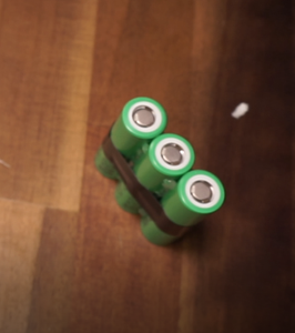

Step 4: Soldering the Batteries
Once I had all of the leads spot-welded, I grouped 5 sets of batteries, so 15 total, using solder and 8 gauge wire. I soldered the sets of batteries in series to create two 5s3p battery packs.

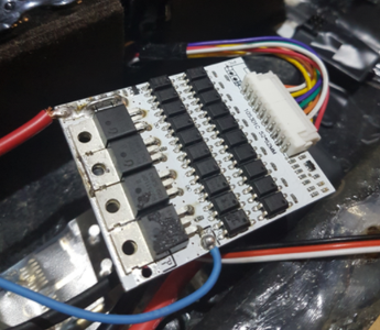

Step 5: BMS Leads
The BMS that I have chosen to use is made for a 10s3p battery, meaning that there are 10 cells in series and 3 cells in parallel. The BMS has 10 different leads coming out of it, each of which will go to the positive sides of the cells. There is also one negative wire that you will have to solder onto the board yourself and ensure that it is connected to the negative side of the overall battery.

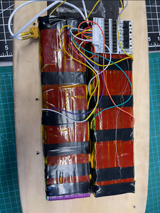

Step 6: Taping the Battery Cells
Once soldering was completed I used Kapton tape to seal the batteries so that once the two batteries were lined up side by side there was no chance for them to touch and short circuit.
You can also see that there is electrical tape over the Kapton tape, this is because I had to solder the leads from the BMS onto the battery packs. I cut through the Kapton tape to feed the lead through, and used electrical tape to secure the lead.

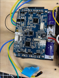

Step 7: Electronic Speed Controller
On the top side of the ESC you can see 6 different leads coming out of it. These leads will connect to the barrel connectors on your motors. This ESC will also connect to the BMS for power and monitoring systems. You do not have to use this exact ESC if you would like to use a single motor. This specific ESC is suggested for a 10s battery configuration and the dual motors that I am currently running.

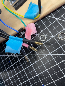

Step 11: Taping Leads
In the picture above you can see I used 2 different colors of tape that correspond with the female end of the barrel connectors on the ESC. I found the correct order of the phase wires before I fed the wires through the box to make it easier when connecting the ESC and motors. Finding the correct orientation before adding them to the box allowed me to make sure that the motors would spin in the correct direction before I tucked everything away.

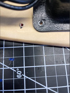

Step 12: Screwing the Box to the Deck
I used normal wood screws that were 1/4 in. thick. These screws were strong enough to mount the box securely but not so long as to go through the deck. One thing that I suggest doing while screwing into the box is to use a heat gun to heat up the edges so that they are flush and you have a better mounting point. Once you have all of the screw holes drilled and everything in the correct place I suggest taking all of the screws out and adding one washer to each screw and using some blue Loctite just for extra safety. This will ensure that none of the screws slip out of the holes while you are riding your board.
