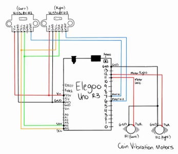

Step 3: Soldering the Wires: Vibration Motors
Attached is a schematic I drew of the whole wiring system. Here you can see that some wires join together before going to the Uno. With every wire you solder together, make sure you put heat shrink on the wire before you solder, that way it will slip over the soldered part easily and shrink well. Keep the heat shrink away from the soldering area until you're done soldering it, otherwise it will be heated up before you need it to. I will start by explaining the vibration motors' wires. For the red wires on the vibration motors, those will stay separated so that they can vibrate independently. Solder one end of one red wire to vibration motor #1. Take one of the jumper wires from the ELEGOO kit that has at least one male end and cut the male end off, leaving a bit of wire at the end for soldering. Solder the male part to the plain red wire that has the other end is connected to the vibration motor. It should be vibration motor with extended red wire with a male end. Do the same thing with the other vibration motor and one of the other red wires you cut.
Next, is the black ground wires for the vibration motors. I would recommend soldering the black wires you cut to the blue wires on the vibration motors first (the vibration motors I listed in the supplies list have blue wires for ground instead of black, if yours have black wires use those). Do the same for both vibration motors. Now, their ground wires are extended. Now, connect the two ends of the ground wires together and add a male end as well. Solder all three together and don't forget your heat shrink! After that, the vibration motors are done!

Step 5: Connecting to the Board
Back in the schematics I included, it shows which wires go to which pins. The red power wire for the sensors will need to go to the 3.3V pin on the Uno. In the datasheet for the VL53L0X, it says to use 3.3V so that's why we are using that pin. The black wire will go to one of the GND pins. The yellow wire will go to the A5 pin. The green wire will go to the A4 pin, and last but not least, the white wires will go to pins 6 and 7. Pin 6 should be for the right side sensor, and pin 7 should be for the left side sensor.
For the vibration motors, the black ground wire goes to one of the GND pins on the Uno. The left side motor's red wire will go to pin 11, and the right side motor's power wire will go to pin 12.
