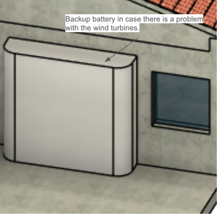

  • The house will have a backup battery to keep it powered if the power grid goes down or the wind turbines fail. The most important function of the battery will be to ensure the air filtration system stays on. To design this battery system as well as how it will be implemented into the power grid, it will take electrical engineers. Electricians will install the battery and circuitry.

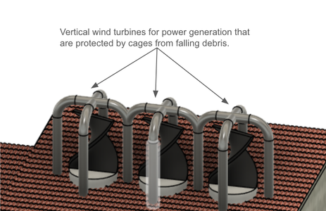

  • Small vertical wind turbines will be put on the roof of the house for energy if the power grid goes out. I chose the vertical wind turbines because a cage can be built around them to protect them from falling debris from trees or larger buildings. These wind turbines will take electricians to install and electrical engineers to design.

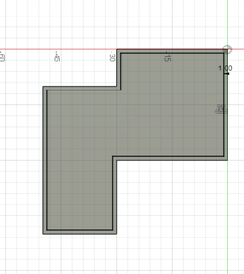

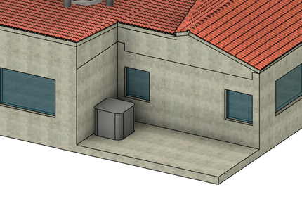

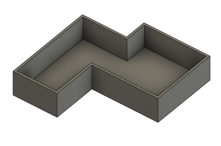

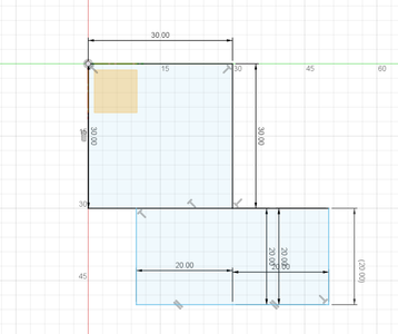

I first made a sketch of the layout of the house. I then extruded that to create the foundation of the house. I then used the offset tool to create the sketch to extrude the walls. At this time, I also added more material to the foundation so there would be room for the external equipment. Lastly, I used the pattern on path tool to create rafters to support the roof.

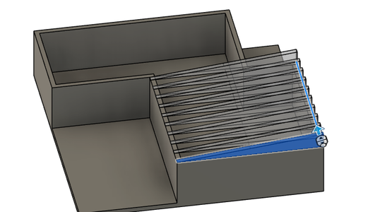

Step 3: Creating the Roof

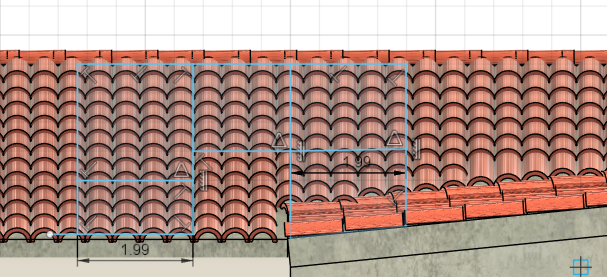

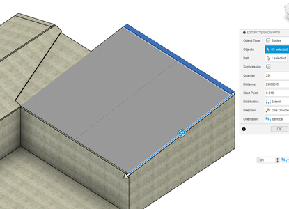

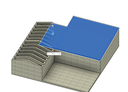

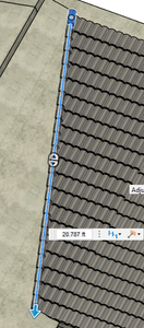

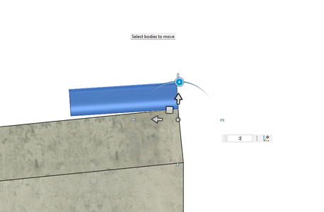

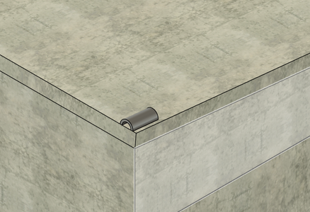

To create a base for the terracotta shingles I first created a sheet that goes over the rafters to attach the shingles. This layer also creates some insulation for the house because it is made out of the same insulating concrete as the rest of the house. I then created a semicircle tube perpendicular to the roof of the house. This is the first shingle. I rotated it upward 5 degrees, then used the pattern on path tool to copy it all over the top of the building. I used tiles in different places to create boundaries and trims where different angles meet.

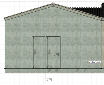

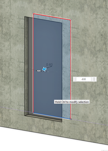

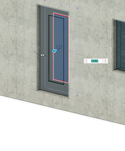

To create the windows and the front door, I first created a hole in the wall. I then extruded this wall outward and colored the new body to create windows. For the door, I did the same thing but then created a window inside the door and a small cylinder to be the doorknob.

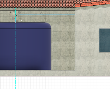

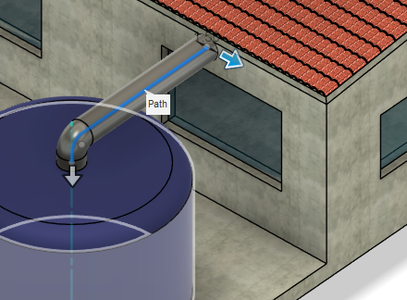

Step 5: Creating the Water Tanks
To create the water tanks, I first made a circle at the base of their location. I then extruded them upward and added a filet on top. To create the pipe for water to flow into the tank, I created a path in the middle of the tank to use the pipe tool. I then used the pipe tool to create the pipe. I repeated these steps to create a pipe for the water to be extracted from the tanks.

First, I created some platforms for the wind turbines. Next, I created a sketch that will determine the thickness of the wind turbine blades. I then extruded the wind turbine blades using the sweep tool. Lastly, I used the pipe tool and the sketch tool to create cages to protect the wind turbines.

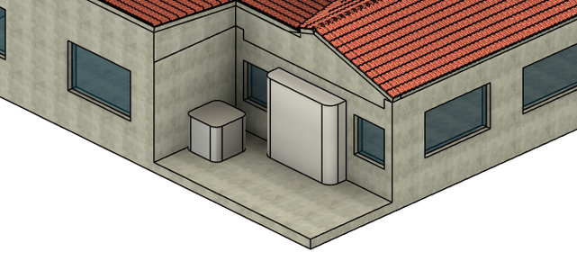

Step 7: Modeling the Backup Battery and Air Conditioning Unit
To create the backup battery, I simply created a rectangular prism and filleted the edges. These steps were repeated to create a model for the air conditioning unit.

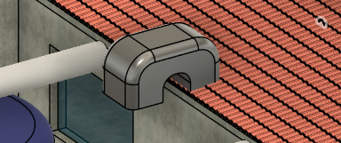

Step 8: Modeling the Vent With the Air Filter
The first step in creating the air filter vent was to make a sketch of the basic shape of the vent. Then, I extruded this sketch, and added various filets to round out the shape.

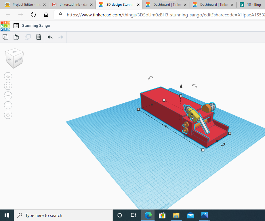

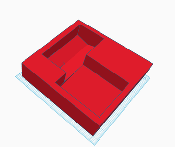

For this model, I really wanted to get a taste of what it would take to create this house in real life. I decided that a good way of doing this would be to cast the main walls of the house out of plaster of Paris, just like how the real house would be cast out of concrete. To make this happen, I first used Tinkercad to make the mold because I can easily use the hole tool make a negative space in a box in the house's shape. Tinkercad was the choice for this step because doing it with the tools I know in fusion 360 would be harder and lead to a less desirable result. then 3D-printed this file to create a mold. I cleaned up the print, then sprayed some olive oil cooking spray on the print to try to keep the plaster from sticking to the mold. I then mixed up the plaster and poured it into the mold. I then removed the plaster from the mold. The mold was printed on weak settings such as, fewer walls and low infill percentage to make it easy to break off the plaster. I am pleased with the detail that was translated from the mold to the plaster.
