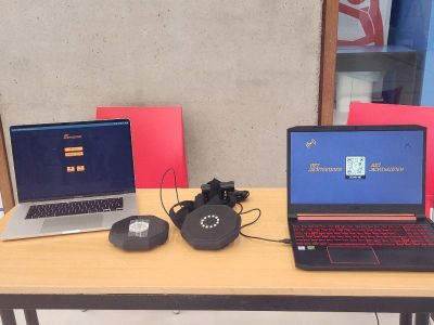

I am a student at Howest studying MCT. This means I had to make my second big project at the end of the third semester. My team and I decided to use electronics to realise our vision. I was the most skilled in electronics so that part was entirely my responsibility. We are creating a game that's a combination of our everyone's beloved childhood "hide and seek" and "tag" that's played in 2 teams (hunters and hunted). In this Instructable I will walk you through the steps of creating the encasing that the hunted will wear so the hunters can tag them.

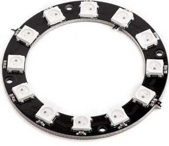

  • led ring with 12 neopixels (50 mm outer diameter, 35 mm inner diameter (!important for encasing))

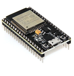

  • esp32 (wroom devkit v1 (doesn't matter a lot, code might differ))

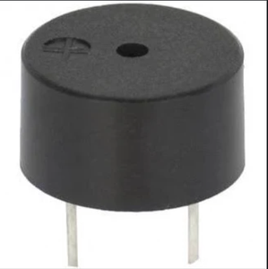

  • passive buzzer

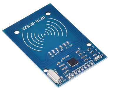

  • rfid reader (RFID-RC522)

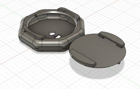

Step 1: Printing the Case
Just like I did with the DogBit I 3D printed the case. A file with both parts is attached to this cell.
We used a GoPro harness to wear the case but a belt will do fine.

For example you will have to solder the LED ring through the small hole on top of the case.
Step 3: Coding the ESP32
The code for the esp32 is fairly simple. I did add more files than I have ever done but this is also the most fun I've ever had coding an esp32.

  • Reading an RFID tag/card (just checks whether or not there is one present. Because that's all we need for this project (don't let this stop you from doing it))
  • LED control: I coded LED's to show system status and for the winning/losing animation.
  • Buzzer: When the hunted lose because they get tagged or win because the timer runs out the buzzer will play a melody. You can take creative freedom here with which melodies you like.
