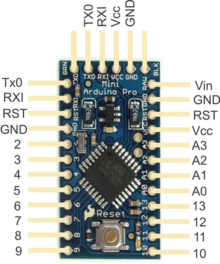

Step 3: Circuit Diagram and Making the Connections:
This is circuit schematics. just connect the components to respective arduino legs and connect the arduino to pc or laptop via usb cable. if you buy genuine arduino board then programming wont be a trouble. it's ftdi chip will take care of the programming via arduino ide program found at arduino.cc website. if you buy cheap clones of it from ebay and amazon which cost only a few bucks, then you need to download and install ch 340 g usb driver. it is available in google. just type it and you will get it. or search it in wooduino.ca website.
