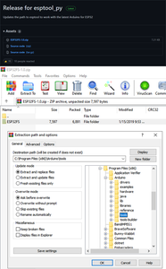

Step 5: Install ESP32 Filesystem Uploader
The primary purpose of the ESP32 Filesystem Uploader is to let you upload files into ESP's filesystem. In this tutorial, the purpose of this tool is to upload an empty SPIFFS image into ESP.
Download the file called ESP32FS-1.0.zip from here: https://github.com/me-no-dev/arduino-esp32fs-plugin/releases/
then extract the content of the archive into the folder: ...\Arduino\Tools\
After that, restart the Arduino IDE.

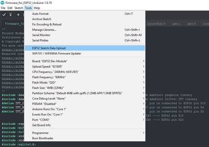

Step 6: Format ESP32's Built-in Flash Memory
Click Tools -> ESP32 Sketch Data Upload. Then click Yes in the pop-up window. The program is going format the built-in flash memory.
Some boards will flash without any problems.
Unfortunately, that's not the case for all boards. If you configured IDE correctly, installed drivers, selected the corresponding port, and still keep getting this error: A fatal error occurred: Failed to connect to ESP32: Timed out waiting for packet header. Connect a 10µF capacitor to the board while flashing.

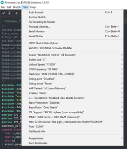

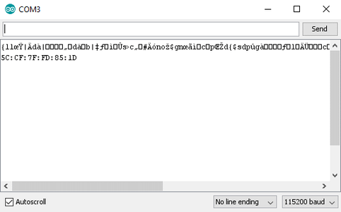

To get the receiver's MAC address, upload this code into the ESP8266.

Then open the Serial Monitor, and reboot the board.
If done correctly, you should see the MAC address in the console.
The MAC address of this board is 5C:CF:7F:FD:85:1D

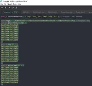

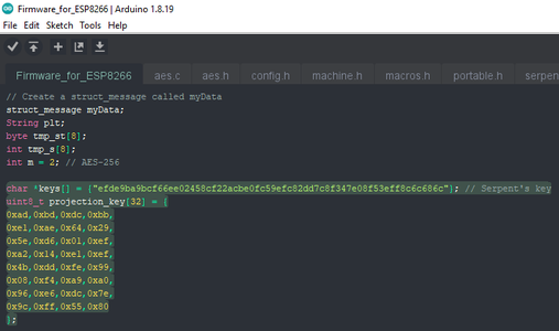

Step 9: Modify the Firmware

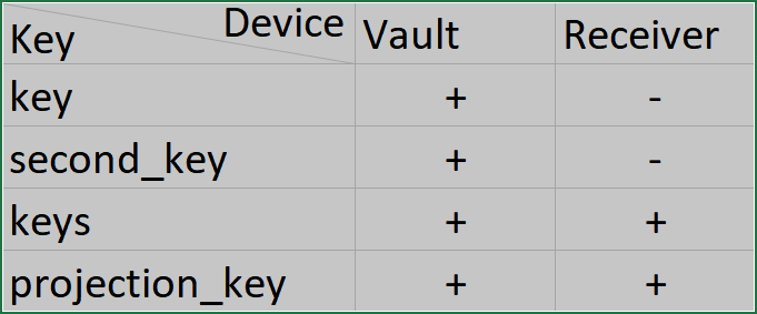

Open the files Firmware_for_ESP32.ino and Firmware_for_ESP8266.ino and then replace my keys with those you've generated.
Vault requires four keys, while receiver only needs two. Make sure that skey and projection_key are the same on both devices.
Don't forget to replace the receiver's MAC address in the line
uint8_t broadcastAddress[] = {0x5C, 0xCF, 0x7F, 0xFD, 0x85, 0x1D}; // Receiver's MAC address
in the file Firmware_for_ESP32.ino

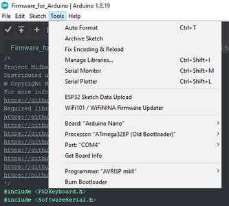

Step 10: Flash the Arduino
Upload the firmware from the folder Firmware_for_Arduino into the Arduino.

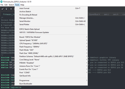

Step 11: Flash the ESP32
Upload the firmware from the folder Firmware_for_ESP32 into the ESP32.
Step 12: Flash the ESP8266
Upload the firmware from the folder Firmware_for_ESP8266 into the ESP8266.

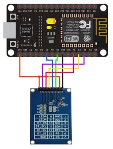

Step 15: Assemble the Receiver
The receiver is even easier to assemble. Just connect the display to the ESP8266.
Ignore the 3.5 mm jack socket and the socket for the WS2812 stripe. These are the remnants from one of the previous projects.
Step 16: Circuit Diagram for the Receiver
