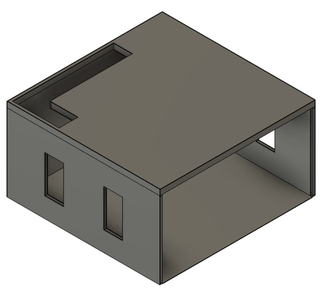

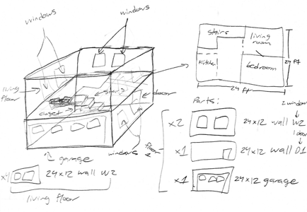

However, before I get to the instructions for building the house. Here is a sketch of the initial design before I turned it into a CAD model using Fusion360. A standard house, comprised of a garage and a living space, requires six 24x12 ft walls with two windows, one 24x12 ft wall with a door, one 24x12 ft wall with a garage door, a floor, and a ceiling piece as well.
Step 2: Building the 24x12 FT Wall With Two Windows (Part #2412W2)
To build this frame, cut out two 24.33 ft pieces of 2x4. Then cut out nineteen 12 ft 2x4's. Then space them evenly as shown in the picture above. With a 1.176 ft distance in between each one. Then, to create the windows, cut out some of the 2x4s in the middle and place 2x4s around it to support it, as shown in the image. Repeat this 6 times to build the standard house. Also, ideally, these parts would be mass-produced and assembled in factories so that contractors can order and easily assemble them.
Step 3: Building the 24x12 FT Wall With 1 Door (Part #2412D1)
To build the back side of the house with the door, you will need to cut out two 24-foot pieces of 2x4. Then cut out nineteen 12 ft 2x4's. Then space them evenly as shown in the picture above. With a 1.157 ft distance in between each one. Then, to create the door frame, cut out some of the 2x4s on the side and place 2x4s around it to support it, as shown in the image.

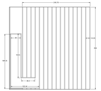

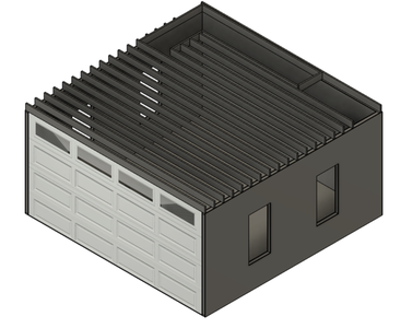

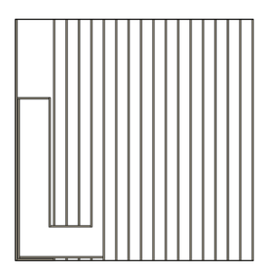

Step 4: Building the Roof/Ceiling (part #17J1S0)
Building the floor for the second level of the house is a bit complicated, but it is crucial to get this part right to prevent people from falling through the floor on the second level. I included a sketch with dimensions on it to help aid the process of building this. To begin, you will need seventeen 296 in 2x10 in joists. Begin from the right side of the building (opposite side from the stairs), and begin placing joists about 13.23 inches apart. Then begin framing the hole for the stairs using the dimensions from the sketch shown above. Additionally, this part also doubles as the roof for the top of the house. The only difference is that the hole for the stairs is removed, and the number of joists for the roof increases to 21. Additionally, since this house has a flat roof, it is modular and allows owners to expand their house to another floor, or install solar panels to improve the environment and support local sustainability goals

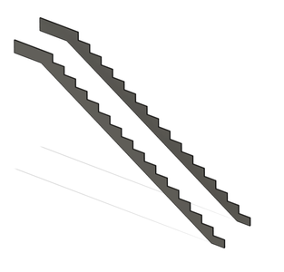

Step 5: Building the Stairs (Part #S16T50)

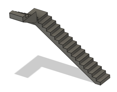

To create the stairs, it is a bit complicated. Let's start with defining the terms. The rise is the vertical component of the steps, while the run is the horizontal component of the steps. From experience, when building stairs, when the rise is not consistent and one rise is even a quarter of an inch taller or shorter than the rest, it will cause people to trip. So, it is crucial to get the rise correct on all of the steps to ensure safety and prevent tripping. The rise is 0.63 ft or 7.56 in for every step, and the run is 0.875 ft or 10.5 in for every step. Using the dimensions for the steps, create two stringers with 16 steps (a side profile of the stair as shown in the picture above). Then cut out sixteen 0.938x3 ft pieces of plywood for the run of the steps, 16 0.567x3 ft pieces of plywood for the rise of the steps. Additionally, cut out a 3x3 ft piece of plywood for the top of the first set of stairs in order to allow the stairs to turn at the corner. For the second set of stairs, near the corner, cut out the same stringers as before with the same rise and run, but only for 5 steps. Also, you will need 5 more of each rise and run pieces of plywood.

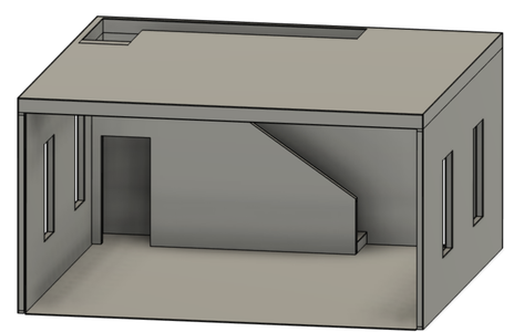

Step 6: Building the Stair Wall (Part #11933S)

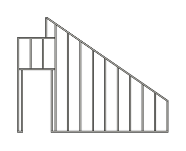

This part is a little complicated and has a lot of dimensions, so I included a sketch with dimensions, in inches, on it to better explain how to build it. I did not use ladder dimensioning because I felt like it was going to be very crowded with numbers and confusing to look at, so I just included the main dimensions that will guide the rest of the dimensions. This part goes under the stairs to create a small closet space for storage. To summarize, the way to build this part is to cut out the appropriately sized 2x4 studs and then cut some of them at a 55.53-degree angle using a miter saw. Then, place a 187.66 in 2x4 on top of that and build the rest from there. Also, once this is installed on the bottom of the stairs, you will need to cover the bottom of the steps using a piece of plywood, which is about 15.376x3 ft.

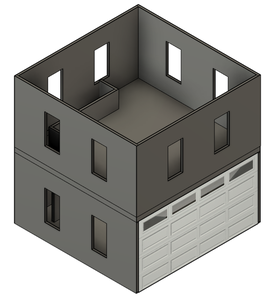

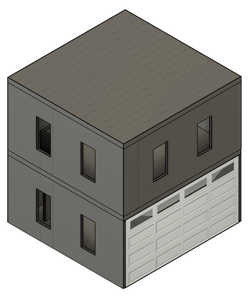

Once you have built all of the parts listed above, you can begin assembly of the house. Starting with the first floor, the garage floor. To do this, first, you put the two 24x12 ft walls with two windows (Part #2412W2) parallel to one another and put the 24x12 ft wall with 1 door (Part #2412D1) in between. Then, you install the garage door, which can be bought off the shelf. Then, you install the roof/ceiling (part #17J1S0). Next, the stair wall (Part #11933S) and the stairs (Part #S16T50). Lastly, the upstairs wall (Part #SW2416).
Step 9: Living Floor Assembly
After assembling the garage, you can begin assembly on the living floor. This is a relatively simple step. It requires four of the 24x12 ft walls with two windows (Part #2412W2) placed on the perimeter of the top of the garage. Then, the roof/ceiling (part #17J1S0) can be installed. There you have it! The standard Project Modularity House. The standard house can then be expanded in any way. Such as having three floors, or three garages, or 1 garage and 10 floors, or 4 rooms and only 2 floors. The possibilities are endless.
