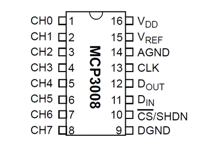

as you can see i already put my T-breakout board, MCP3008 and level shifter on this board only my mcp3008 will do a 180 later in this project because it fitted better.
  1. put your T-breakout board, mcp 3008 with the notch pointing at the breakout board, and the levelshifter on the breadboard
  2. connect your ground, my breadboard has 4 independent power 'zones' so i will need to connect them and the pi to eachother
Step 2: Routing the Cables-device Ground + Power
now i connected the ground to the wrong side of my mcp3008 so if you put that notch to the t-cobbler it will work
  1. connect the 3.3V to the top right power zone
  2. connect the 5V from the pi to the left power zone and connect them
  3. connect the AGND and DGND from the mcp3008 to the ground of the breadboard
  4. connect the grounds from the levelshifter to the ground of the breadboard
Step 3: Routing the Cables-MCP3008
In this step we are going to connect the rest of the wiring for the MCP3008
  1. connect the SC/SHDN pin to the SPICE0 of the T-cobbler
  2. connect the DIN to the MOSI(Master Out Slave In) pin
  3. connect the DOUT to the MISO(Master In Slave Out)pin
  4. connect the CLK pin to the SPCLK pin
  5. and lastly connect the VREF and the VDD to the left power zone(5V)

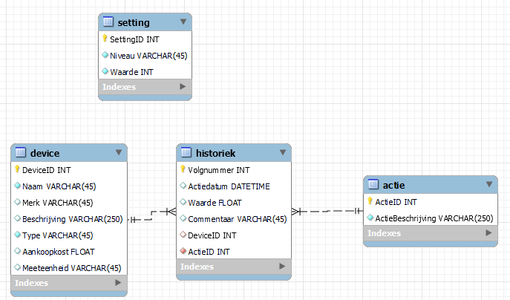

Step 12: Last But Not Least the Database
This is my Normalized database, which I have put on the raspberry pi itself using MySql
