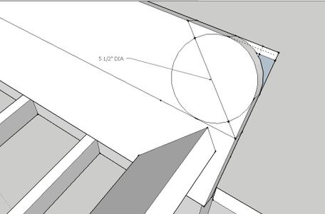

This next Step can be skipped if you want a square end and not rounded but don't skip the other steps below it.
Now using a pencil, mark then draw with a compass on one of the bottom pieces for the front, then draw and cut the larger radius on the ends. These are 2 3 1/4" radius from the mark to cut using a jig saw. (this is optional) See pictures
Now draw the smaller radius for both sides in the center. These are 2" radius from the 1' 4" mark. Then draw a line 2" from one radius to the other radius See Pictures. Cut out using a jig saw. Don't skip this required step if using a thin mattress pad.
Draw and cut the ends of the back bottom large radius the same way you did on the first piece. See picture.
Note: The back piece don't need the smaller radius and lines like the first piece you cut, just the ends have radius cuts only if you want them rounded. Look at the pictures for better reference...

Grab some 2x6 and cut two pieces to 7' 0" long. Then on one board mark the 5 1/2" mark to one side to find the center for the radius. With a compass draw the radius from the center mark then repeat the same for the other end. See pictures
With a jigsaw cut the ends on the radius lines.
