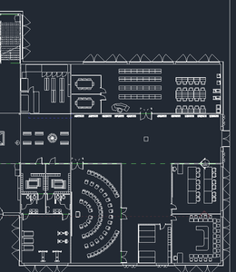

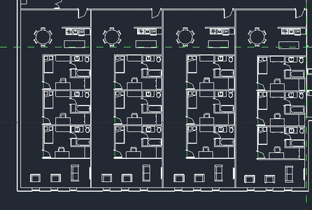

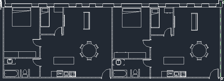

The second phase of the project involved determining who this housing would serve. I didn’t want this to be just a shelter. I envisioned this building as a blend of community school and transitional housing—supportive, educational, and resilient. I studied trauma-informed design, community-centered architecture, and case studies from nonprofits.

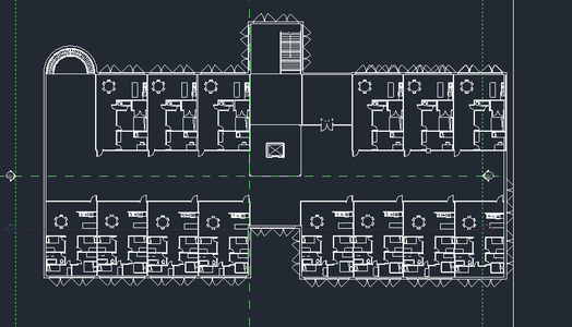

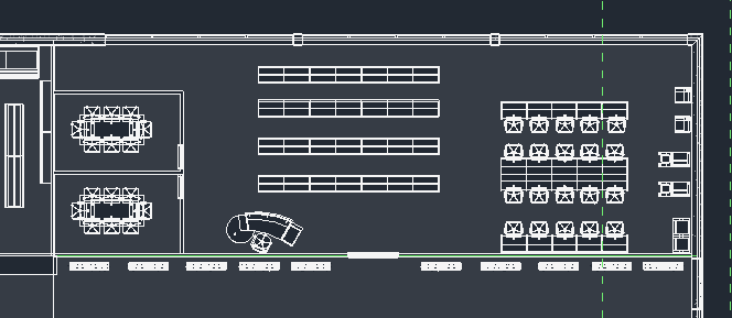

This layout blends housing with support infrastructure. The lower level serves as a shared school and service hub. It offers classrooms, counseling rooms, communal kitchens, and a flexible dining space that can double as a lecture or event hall. The upper floors hold compact, private living spaces arranged to maximize light, safety, and acoustic comfort.
Every hallway, every shared wall, was positioned with a human story in mind.
Step 3: Step 3: Building in Revit

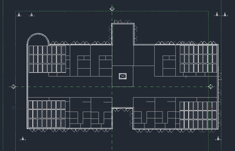

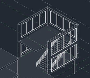

Before this project, I had never touched Autodesk Revit. Now, it’s one of the tools I’m most proud to have learned. I built the entire structure in Revit—floorplans, room schedules, section cuts, and all. The model includes:

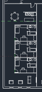

  1. 6 studio micro-units
  2. 2 classrooms
  3. 1 counseling center
  4. Shared kitchen/dining area
  5. ADA restrooms
  6. Reception and entry vestibule

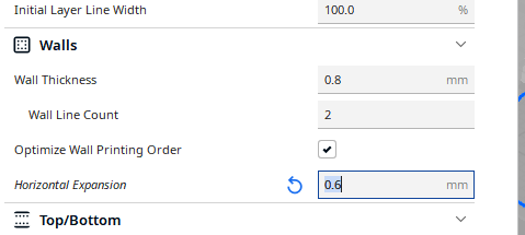

With the design finalized in Revit, I exported STL files floor by floor. Each section was adjusted for FDM printing—hollowed to fit LEDs and sliced for print volume limits. Cura handled slicing, and I added structural wall reinforcement where necessary.
Settings:
  1. Layer Height: 0.2 mm
  2. Infill: 15%
  3. Wall Count: 4

I incorporated universal design:
  1. 36” clearances
  2. ADA-compliant bathrooms
  3. Elevator shaft with backup battery slot
  4. Multi-sensory navigation (Braille, visual contrast zones)
