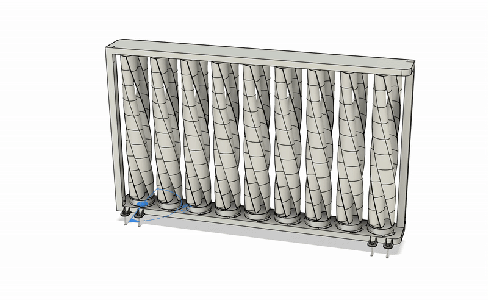

The Wind Wall is a modular, wall-mounted system of Vertical Axis Wind Turbines (VAWTs) designed to generate clean electricity from ambient wind, especially in urban or space-constrained environments. Unlike traditional horizontal wind turbines, which require open fields and large structures, the Wind Wall can be installed along building facades, fences, or rooftop edges — transforming otherwise unused vertical surfaces into renewable energy generators.
Depending on size, wind conditions, and number of turbines, a WindWall unit can produce anywhere from 300W to 1kW, with the potential to scale higher in favourable conditions. here in my project, I have gone for a Wind Wall that is 2meters wide and 1meters tall. each of the VAWT being 17cm in diameter. The power produced (hypothesised) is at about 600-800W.
Step 2: Idea/Inspiration
The idea of a Wind Wall was inspired by Sir Robert Murray Smith from his YouTube channel : https://www.youtube.com/@ThinkingandTinkering
The concept:
Using several Vertical Axis Wind Turbines (VAWTs) and grouping them together in a pattern to form a 'wall' that will generate electricity.
The Turbines are arranged in a linear pattern and housed in a framing. The blade type is similar to the Savonius turbine type that uses the different forces on the side of the blade to spin i.e. one side has more drag and the other has lesser drag. Hence Savonius blades work in the basis of drag difference. There is another type that uses lift as the spinning force but that does not work very well in low wind speed conditions.
The similar-to Savonius type of blade that I choose has a specific 'blade profile'. Now what is blade profile? --- When we cut the Blade of the turbine into thin slices (like chips or crisps), the shape of that plane is called the blade profile.
Here I used the "Ugrinsky" type of profile. the reason why I chose it is because it has high efficiency and ability to produce positive torque at all angles (which is very important as unequal torque can cause 'pulsing' effect on the shaft and also it becomes inefficient). Studies have shown that the Ugrinsky turbine can achieve a maximum power coefficient of 0.170, which is 54.5% higher than the Savonius turbine (given below in 'references').
Ugrinsky profile
The 'Wind Wall' shall have 9 turbines in a frame (Why I specifically chose "9" is given in the "Testing for efficiency" Step), each turbine being 100cm tall and 17cm in diameter.

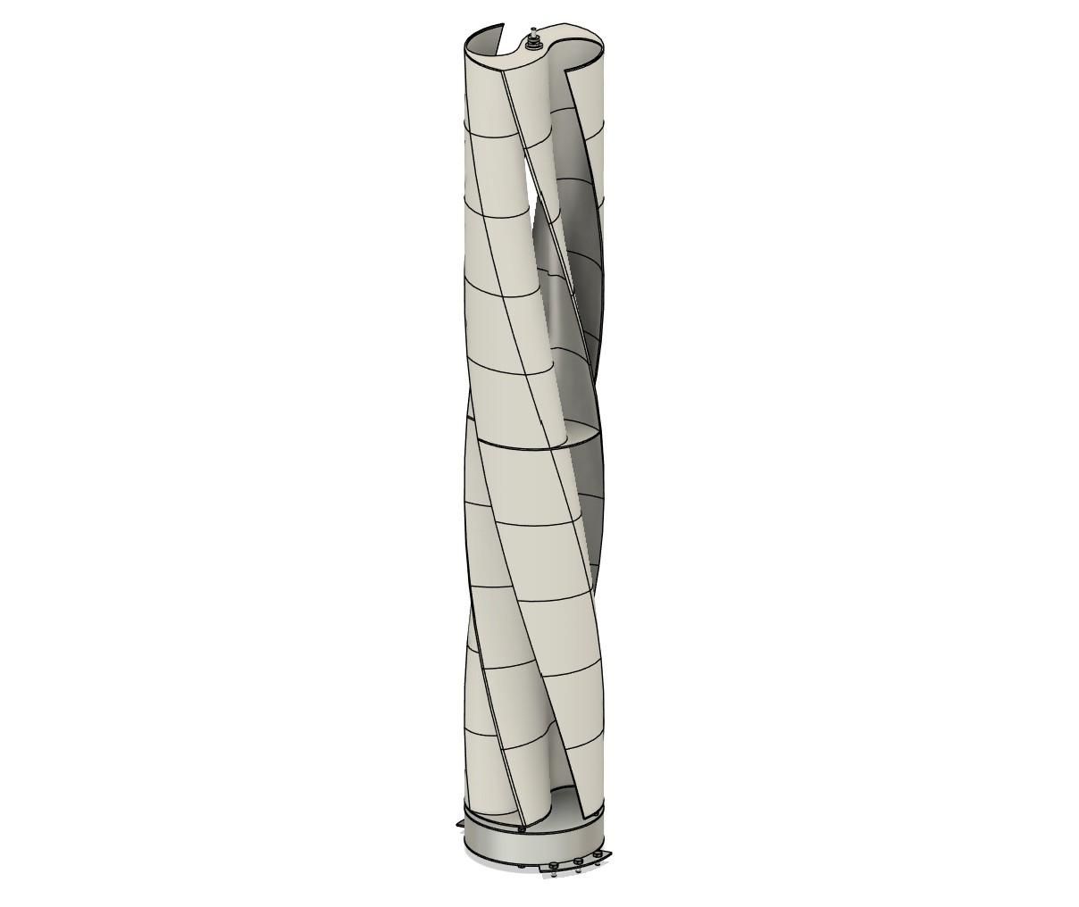

Step 4: The Blade
The Steps are:
- First we select the xy plane.
- Then we draw the outline of the Ugrinsky profile.
- After that we copy the outline while in the sketch and move it vertically up about 5cm and once more using the original up to 10cm.
- We need to twist the first copied profile by 10degrees and the next one above it by 20degrees.
- Making two such profiles rather than 1 single profile makes sure that when we use the 'Loft' tool, it makes a smooth and continuous blade section length-wise. If we do not do this, it makes the between parts of the blade length (As shown in the video). Make the loft and mirror it twice to get the second part.
- Then we copy the section we made and move it 10cm upwards and rotate it at 20degrees. Repeat till it is 10 such blade sections making a 100cm blade.
- Use the combine tool to make the blade into 1 big part.
The Blade is Done!!!

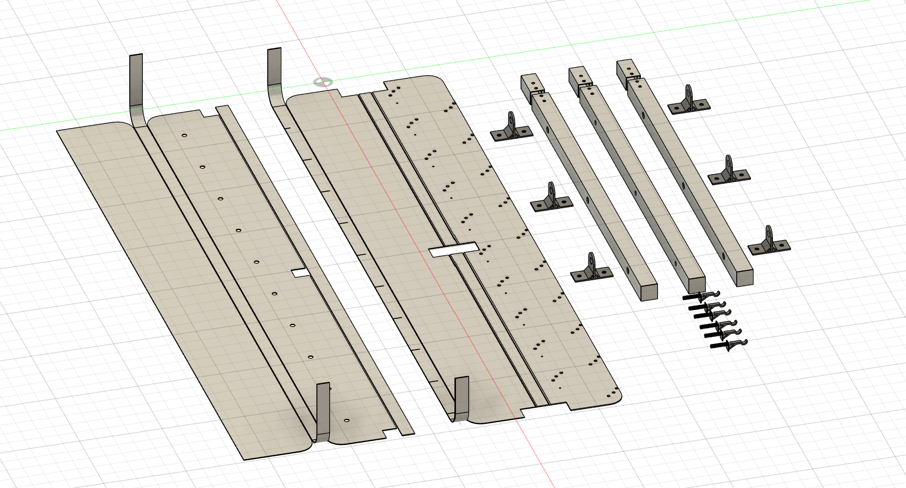

Step 6: The Frame
The frame is pretty simple part, it is mostly a uniform sheet of thickness 2mm.
To make the frame I mostly used the 'extrude', 'move' and the 'create sketch'.
The Frame is Done!!!

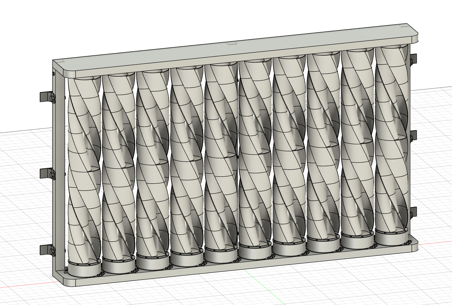

Step 7: Assembly
To assemble the 'Wind Wall'
1 Assembly of the Generator:
- In the Casing of the generator, the serpentine coil is fit in the inner surface of the ‘Generator Cover’. The ‘Generator Cover’ is placed upside down for this.
- The ‘Bottom Cover’ is screwed down onto the ‘Generator Cover’ with appropriate screws in the given screw hole.
- Now, the Stator and the axial is assembled separately. The Axial is put through the axial bearing, the stator, the axial bearing and the thrust bearing respectively and held together with glue.
- The Assembled stator and axial is placed in the generator.
- The ‘Top Cover’ is then placed on the generator and is screwed closed in its respective position. Put the thrust bearing on top of the generator lid and secure its lower portion using glue.
2 Assembling the VAWT:
- On the assembled Generator and axial, the blade is slid down the axial till it is in firm contact with the thrust bearing. Glue is applied to the shaft of the axial to connect it to the blade.
- The top axial bearing is then affixed to near the tip of the axial in such a way that when the ‘Top Frame’ is fixed to the ‘Frame Body’, the bearings are in the same level with the lower surface of the ‘Top Frame’.
3 Assembling the Frame:
- The Frame is manufactured from metal sheets.
- The ‘Top Frame’ is divided into 8 pieces.
- They are welded in order as shown in the report attached at the end of the step.
4 Assembling the Wall:
- The VAWT is first placed in its intended position given by the cutouts in the ‘Frame Base’.
- The VAWT is then screwed into position.
- The ‘Top Frame’ is then secured in position using screws.
- The Wind Wall is now fully assembled.

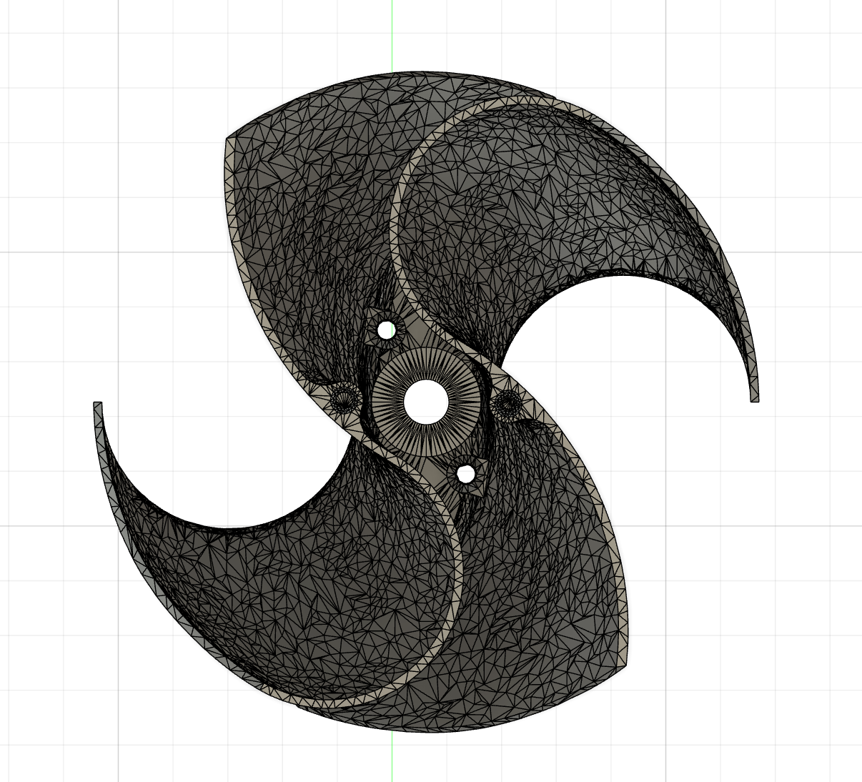

The objective of this test is to analyse the wind flow patterns and the force exerted on the “Wind Wall” and the structural stress and strains the “Wind Wall” can handle. The main objective is to prove that the design can handle day to day stress and loads most importantly the designs can withstand certain limit of unfavourable conditions. The safety factor and stability of the design shall be also looked upon.
Simulation Setup Details:
in Autodesk CFD---
- 141958 Total Nodes, 104003 Fluid Nodes, 37955 Solid Nodes} For single VAWT
- 725455 Total Elements, 573228 Fluid Elements, 152227 Solid Elements} For single VAWT
- 1 Inlets (Velocity 3m/s, 8m/s, 17m/s, 20m/s), 1 Outlets (Pressure 0), 0 Unknowns} For single VAWT
- 1225606 Total Nodes, 1201788 Fluid Nodes, 23818 Solid Nodes} For “Wall”
- 4777785 Total Elements, 4090471 Fluid Elements, 687314 Solid Elements} For “Wall”
- 1 Inlets (Velocity 11.5m/s), 1 Outlets (Pressure 0), 0 Unknowns} For “Wall”
- Turbulent Compressible Flow is ON
- Turbulence model: Standard k-epsilon
- Solver Settings: 100 steps, each step 1 iteration. Temp 33degrees Celsius.
- Solver Settings: 200 steps, each step 1 iteration. Temp 33degrees Celsius.

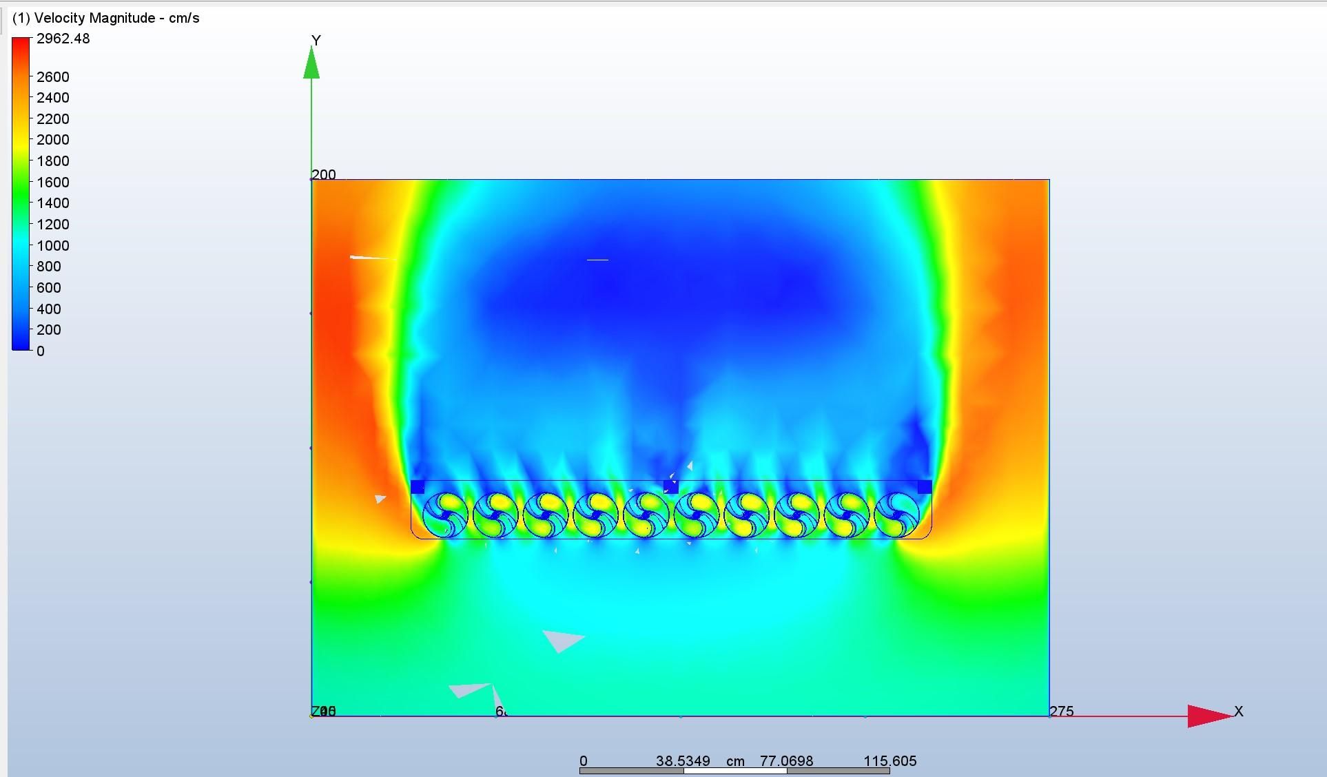

CFD Simulation:
Blade at 17m/s
Wall at 11.5m/s
At 17m/s, The net force on the VAWT is approx. 87N.
For the whole 'Wall' the net force at 11.5 m/s is 875.722N.

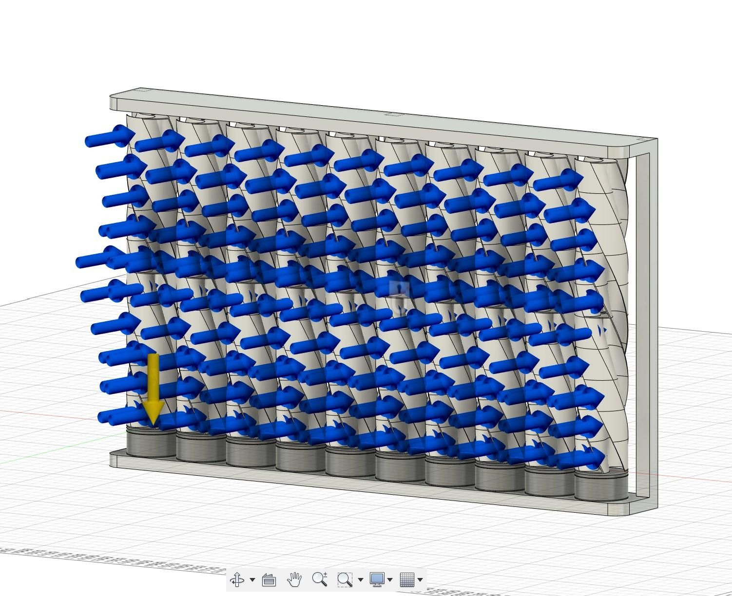

Using this data from the CFD software, we can apply these forces in fusion360 'static' load test and work out if the model can handle the force of the wind.
Representing the force on the wall
For a single VAWT, Maximum displacement is 1.564mm, minimum displacement is 0mm.
For the whole Wall, Maximum displacement is 3.216mm. Minimum displacement is 0mm.
Average safety factor is at 8.591 and the weakest being at the bearings and axial connections (tho it is above 5 at the weakest parts). Usually the average safety factor for small scale turbines is at 3.
This proves that the turbine is more than strong enough to face everyday stress and strain (and more too!).

So the idea is that the VAWTs are placed linearly in the frame as seen in the pictures above and all of them face the incoming wind. Since they are placed close to each other, a 'venturi' effect forms that makes the wind go faster in between the turbines.'
This increase in speed can also increase the power output of the wind turbines, and if the turbines are spaced properly, then we can find out the optimal spacing which gives the strongest venturi effect.
Now that we have this concept in mind, we need to make a corelation with this increased velocity, incoming velocity and the spacing of the turbines.
I have written a research paper about it and waiting to publish it tho and for those who wish to check it out I have attached it at the end of this step!

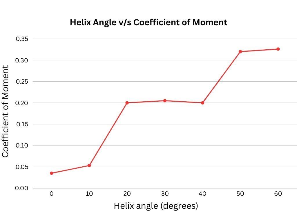

Approach1 (Finding optimum helical twist):
My model of the turbine blade has a helical twist. This is to make sure that when the wind is blowing on the turbine, it is evenly distributed and hence the force on the blades is even throughout the cycle. Hence there will be less pulsing effect on the blades when it rotates. It also improves the efficiency of the turbine.
To check this, I created different blade models and ran CFD test on each of them and calculated the 'torque' generated on each blade with a different helical twist. According to the test, the torque increases when the helix angle increases. But we shall take the helix angle of 20degrees as making a blade with very high helix angle (60 degrees +) can be very difficult and expensive and defeats the purpose of creating cost-effective electricity.
Hence optimal angle is 20degrees!

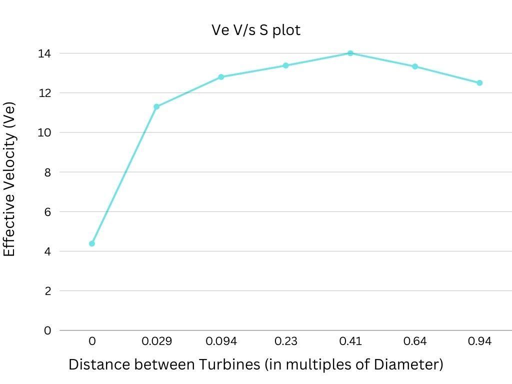

Approach2 (Finding optimum spacing):
To find the optimal spacing, we need to test the whole wall with different spacing between the VAWTs for each different helical twist angle that we tested for. This is done for consistency (and it took a very veeerrrryyy looonnng time).
At the results and after plotting a 3d plane graph, we can see that for 20degrees helix, there is a very specific spacing that produces the maximum efficiency. For higher helix angle, the spacing is greater to get the similar efficiency.
The Final Result:
Now that we have all the comparisons done, we come up with the corelation:
Ve=V.(1+(Kv.D)/Sp)
taking S=Sp/D
Ve=V(1+Kv/S)
or
S=Sp/D
S=|(V.Kv)/(Ve-V)|
Where 'Ve' is effective velocity, 'V' is the incoming velocity, 'Kv' is a coefficient, 'D' is the diameter of the turbine, 'S' is the spacing coefficient, and 'Sp' is the spacing.
Hence;
Sp=S/D
or
Sp=(|(V.Kv)/(Ve-V)|)/D

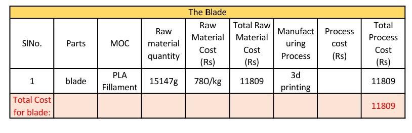

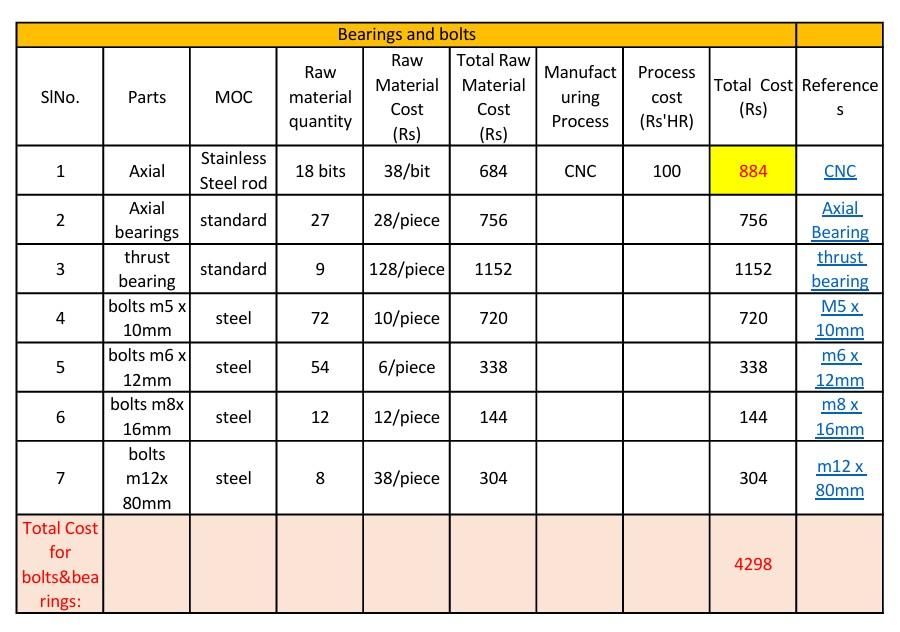

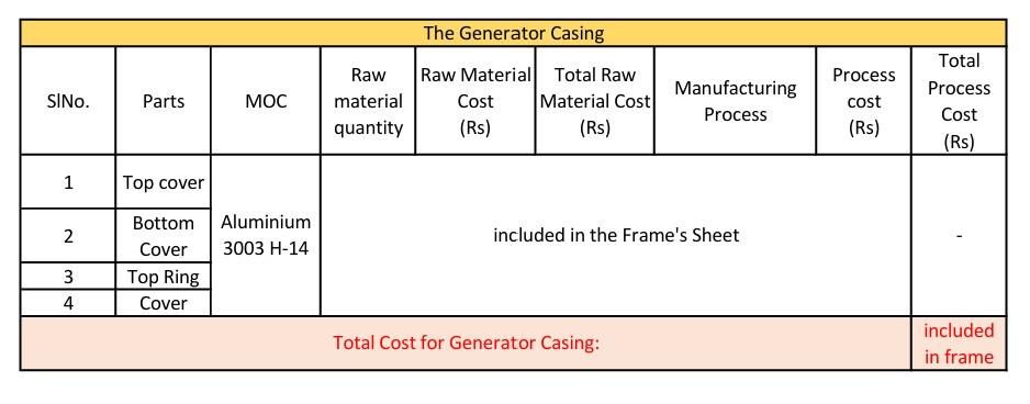

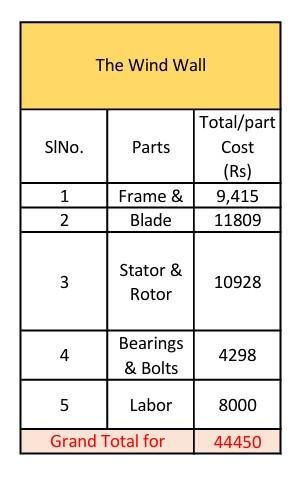

Step 10: Costing
Costing is also attached at the end of this Step.
The Cost of the Wind Wall should not be tooo high as it will be not a reliable source of electricity. For that we need to understand how ROI (Return Of Investment ) works.
ROI:
ROI is a financial metric that helps you measure how profitable an investment is relative to its cost. It’s one of the most widely used tools in business and finance to evaluate the efficiency of an investment.
Where ROI= ((Net Profit)/(Total Investment Cost))*100
Net Profit= Total Revenue – Total Costs
Ideally we do not want the ROI to be below 25%

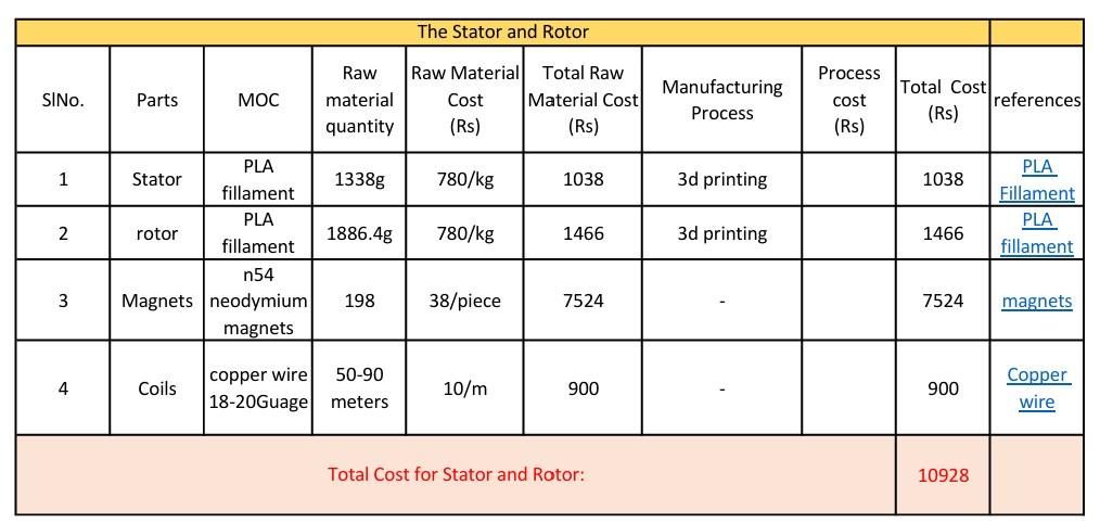

Costing:
First we need to make a prototype to check if it is feasible in the real world scenarios. Usually the prototype would be more expensive that making it in bulk as making a single or a few parts is expensive.
For example: if I have to 3d print all the 9 blades, it will be around 15Kg of filament and at ~800Rs (9.36 $us) a kilo, that is a grand total of 12000Rs (140$). THAT is a lot of mony... ( in India that is the equivalent of someone's salary a month!)
But if we make in bulk:- let's say that the mould of the blade is at 300000Rs (3,510.$) and we make about 100 Wind Walls in a year, that is 3000Rs (35$) for each wall! (AND the cost keeps decreasing as the number of blades produced increases!)
That is a 25% drop in cost of just the blades per 'wall'. (And the Blades will be the most expensive part.)
The targeted cost of mass production of the 'Wind Wall' is at 20000-25000Rs (292$) per 'Wall'
(an average turbine of 1Kw power sells for about 1000$).
Below is the costing for the 'prototype' of the wind wall.
