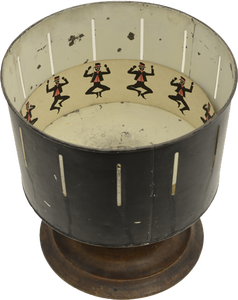

This is a Zoe, short for Zoetrope. It is a cool, old-school device that creates the illusion of movement from a series of still images. It’s a spinning drum with slits around the sides, and inside, there’s a circle of pictures or drawings. When you spin the drum and look through the slits, the pictures seem to come to life, kind of like a simple animation.
Not much practical use to it, but if you also want to make yourself a Zoe, here is how to easily make one (If you can easily access a laser-cutter and 3D printer that is, of course).

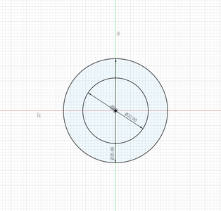

Draw a final sketch to house the metal bearing for image 3.
(All dimensions are adjustable to preference)

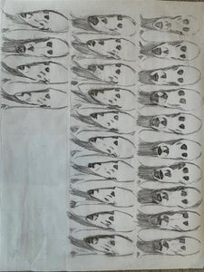

After the frames are all cut, we need something on the frames for the animation to be played when we spin the Zoetrope.
Obviously, if you are feeling it you could draw each frame on Adobe Illustrator and engrave it with laser cutting, but here I chose to draw all the frames out by hand on sticker papers.
Then stick each sticker frame by frame onto the plywood frame.
