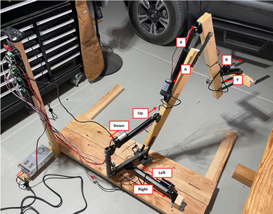

Introduction: Project_A: Robotic Arm
Nowadays, for us robotics enthusiasts, there is a wide variety of hobby projects available online: wheeled robots, legged robots, robotic arms, etc. A rich variety, indeed, but if there is something most of those hobby projects have all in common is that they are small… and not easily scalable, either! As soon as you put in any weight or demand any force, the joints break and the motors stall; they are not meant for any kind of heavy duty.
So, what if I want to build a robotic arm that is capable of lifting something heavier than a few ounces? What about a few pounds? Yes, but also, you do not want to buy an industrial robotics arm that will set you back some serious bucks, require you to buy and/or learn proprietary software, and then collect dust after you are done playing with it. Is there a middle-of-the-road option?
The purpose of these instructions is to show you how to build a robotics arm that can lift up to 10 pounds, that is not made of plastic, but of iron and wood, that is not insanely expensive, that you can control directly or via a programmable Arduino, and that you can later easily modify to better suit your goals - or even break down into parts for other projects once you are done with it.

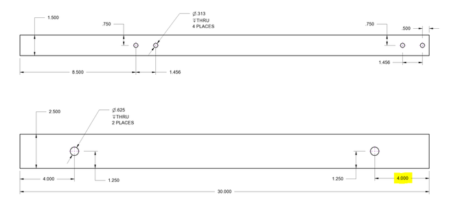

Step 1: Make Metal Parts
Above is a table and a photo of all the metal make components that need to be fabricated for this project, and the material list for each. Note that the material information is also available in the drawings for each part.
Access the Shared Drive, and navigate to:
Project A – Robotic Arm > Drawings > PDF Files
Download all the drawings in the PDF Files folder and print them; these are the drawings that contain the information you need to fabricate the parts. In the Shared Drive you will also find a folder with all drawings in STEP format, in case you have any trouble reading the drawings and wish to visualize the parts in 3D software.

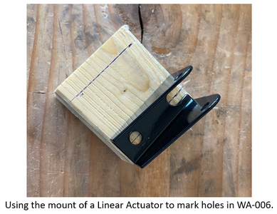

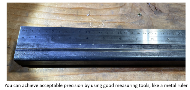

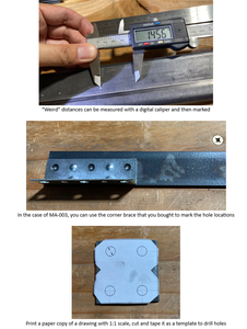

Step 2: Tips to Make the Metal Parts
The photos above show some maybe useful tips to fabricate the metal parts.
The metal parts look simple enough: some metal material cut to length, and then a bunch of holes drilled to it. There are not any requirements for welding, precise milling or CNC machining – this simplicity is intended to make the design buildable by hobbyists without specialized tooling.
However, and realistically, the better the equipment you have, the easier it will be to fabricate these components: a drill press is a must; and while you could cut all the material with a hacksaw, an electric bandsaw would make the job much easier. So, if you have a friend with a small shop, this would be a good time for a visit (or team up!)
The bent components may also be tricky to fabricate if you have not made bent parts before. Happily, all bents are 90o, and we are using thinner steel for these – steel nevertheless, and it’s not like you can bend it with your fingers. A bending brake would be ideal for this operation, but there are also some cheaper vise-mount bending brakes. Whatever tool/technique you use, I recommend you bend some practice pieces before fabricating the final parts.

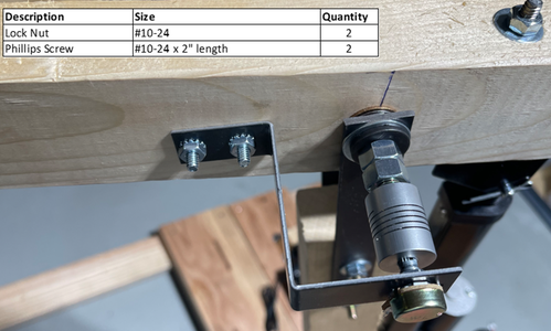

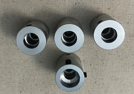

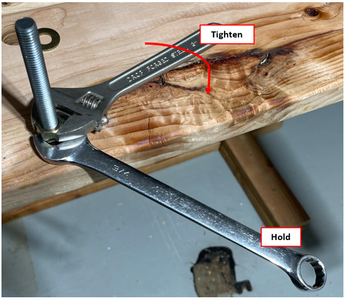

Step 3: Modify the Flexible Couplings
Besides the parts you need to fabricate from the drawings, you also need to modify the Flexible Couplings 6mm to 8mm as follows:
·      On three of the Flexible Couplings, on the 8mm side, drill a 3/8inch hole, 1/2inch deep.
·      On the last Flexible Coupling, on the 8mm side, drill a 1/2inch hole, 1/2inch deep.
·      Basically, you are expanding the 8mm holes to a custom size.
·      If using a vice to hold the parts, it’s recommended to use a vice jaw pads with round grips.

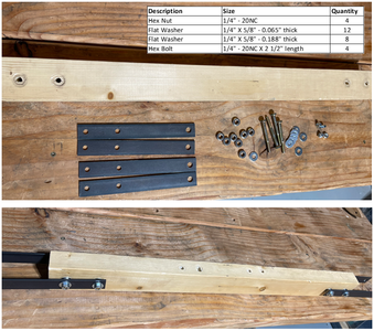

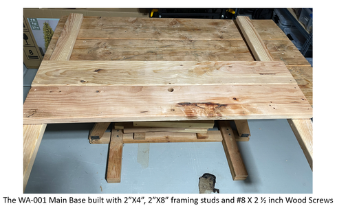

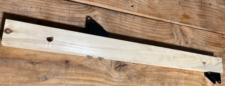

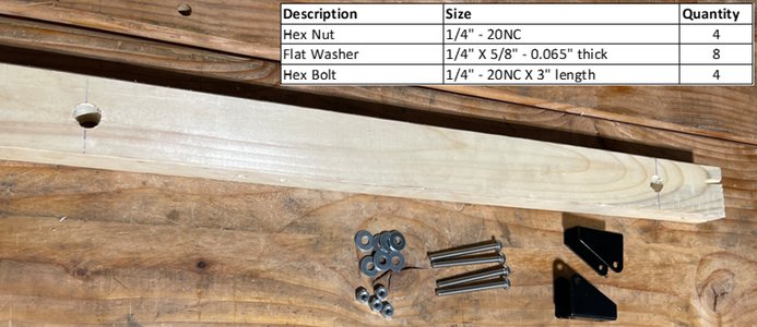

Step 4: Make Wood Parts

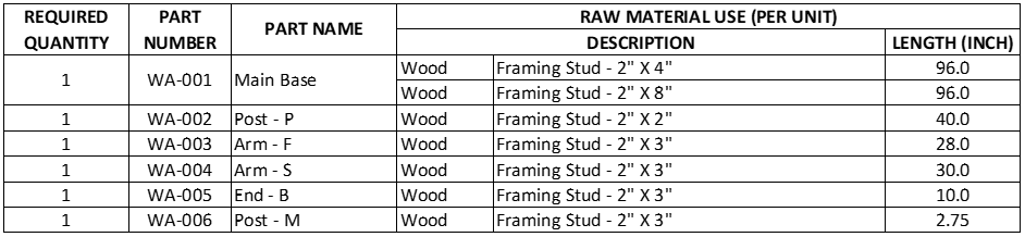

Above you will find a list of all the Wood Parts that need to be fabricated, and some helpful photos of some of the items.
Download the drawings of the wood fabricated parts from the PDF Files folder, if you have not done so already. Note that there's no drawing for WA-002, because it is just a piece of wood cut to 40" length.
Now, a robot made of iron and wood? Isn’t that a bit too retro? Maybe, but the reason I chose wood for certain components is that is readily available, inexpensive, and easy to work with. This will become evident to you too as you build your robotic arm.
Can you swap the arm materials for something nicer, like aluminum tube? Certainly, but I recommend you first build with wood before you try with any metal, metal being much more unforgiven if mistakes are made.
In general, the PDF drawings of the Wood Make components should suffice to build all wood components. If you screw up somewhere at some point, do not worry, you can always drill more holes on wood or even cut a new part and make it from scratch.

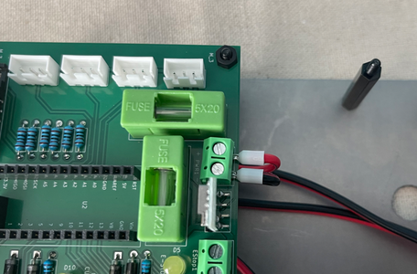

Step 5: Prep Components for Soldering
Before soldering any component to the PC Board, prepare the following components:
Prepare the 5V Regulator by cutting the “ADJ” connection, soldering a jumper for 5V output, and soldering 4 Right-Angle pins to the regulator outputs, as shown in the photo above.
Prepare the ItsyBitsy by soldering male pins to all connection terminals, except the middle terminals “En” and “G”, as shown in the photo above.

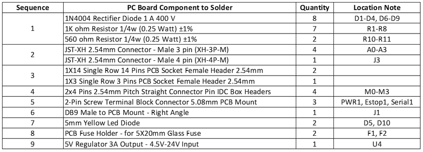

Step 7: Solder Components to the PC Board
The table above shows you the sequence to solder the various electronic components to the PC Board, and the photos show you the PC Board in its various stages of soldering.
After you finish soldering, install the 250mA fuses and the prepared ItsyBitsy as shown on the photo.

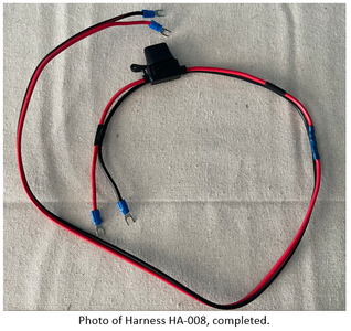

Step 10: Make Harnesses (Group 3)
To build harness HA-008, you are going to do the following:
1.      Cut a 36” length of the 14AWG – 2 Conductor wire.
2.      On one end of the wire, separate red and black wires, and cut 12” of the red wire.
3.      In the instead of the cut red wire, splice in the Fuse Holder with a Butt Splice connector.
4.      Crimp 16-22AWG Fork Terminals to both ends of the “modified” wire.
5.      Insert the 20A Fuse to the Fuse Holder.

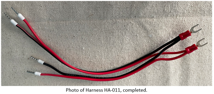

For example, for HA-011 you are going to do the following:
1.      Cut two lengths of 18AWG – 2 Conductor wire: one 8”, and the other 6.5”.
2.      For each wire, on one end, crimp 18AWG Insulated Ferrules to red and black wires.
3.      Join the other ends by red-red and black-black wires.
4.      Crimp Fork Terminals to the Red/Black joint ends.

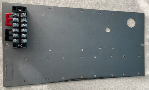

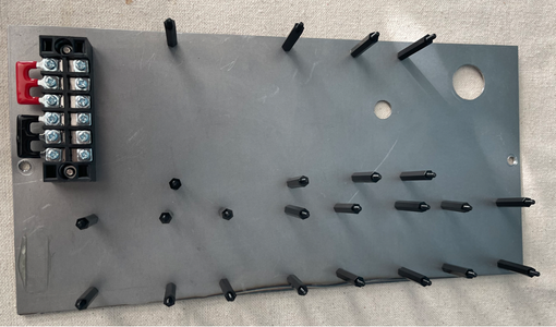

Step 13: Prepare the Terminal Strip
Retrieve the Screw Terminal Strip - 6 Positions, and install to it one red (positions 1-3) and one black (positions 4-6) 3-Position Shorting Strip, as shown on the picture.
Step 14: Mount the Terminal Strip
Install the Terminal Strip to the MA-011 Panel C with two M4x10mm Screws and M4 Nuts, as shown in the picture.

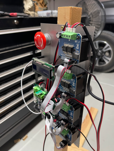

Step 15: Mount Nylon Standoffs
Retrieve all the M3X30mm Nylon Standoffs and M3X6mm Nylon screws, and pre-install them to the MA-011 Panel with the stud side facing up. Pre-install means that you are not going to tighten the screws and going to leave all standoffs somewhat loose.

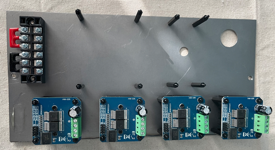

Step 16: Mount BTS7960 H-Bridges
Retrieve all 4 of the BTS7960 - 43A H-Bridges, and mount them to the MA-011 Panel. Secure them with M3 Nylon Hex Nuts, and tighten their standoffs and nuts in place.
Step 17: Connect Harnesses to H-Bridges
Connect the indicated harnesses to the H-Bridges as follows:
1) Retrieve harness HA-011 and connect it to the terminal strip and the two bottom H-Bridges, as shown in the photo. Mind correct wire polarity as shown!
2) Retrieve harness HA-012 and connect it to the terminal strip and the two top H-Bridges, as shown in the photo. Mind correct wiring polarity as shown!
3) Retrieve harness HA-009 and connect it to the terminal strip as shown. Mind correct wiring polarity as shown!
Step 18: Mount & Connect the Control Board
Retrieve the completed Control PC Board, and mount it to the MA-011 Panel; secure the board with the M3 Nylon Hex Nuts, and tighten its standoffs and nuts in place.
Then, connect the available end of harness HA-009 to the Control Board, “PWR1” terminal. Mind correct polarity: Red to “+”, black to “-“, as shown on the photo. Mind correct wiring polarity as shown!

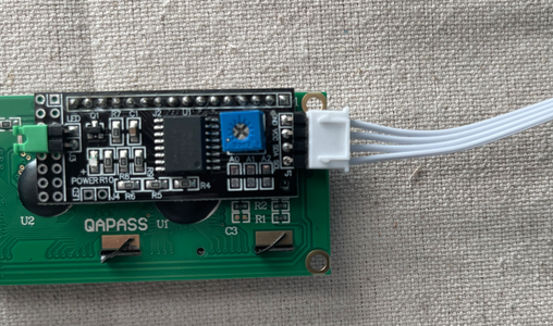

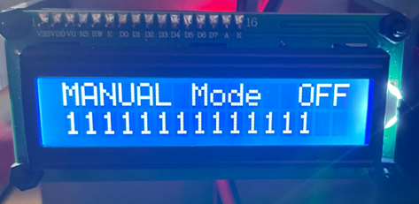

Step 19: Mount & Connect the LCD Display
Retrieve the I2C LCD Display Module, and connect to it the JST-XH 2.54mm Female to Female Harness 100mm - 4 pin, as shown below. Mind the correct position of the JST-XH connector, with tabs facing upwards.
Now mount the LCD Display Module to the MA-011 Panel; secure the module with the M3 Nylon Hex Nuts and tighten its standoffs and nuts in place.
Finally, connect the JST harness from the Display Module to the Control Board as shown in the photo; note that the harness only connects to the Control Board in one way.

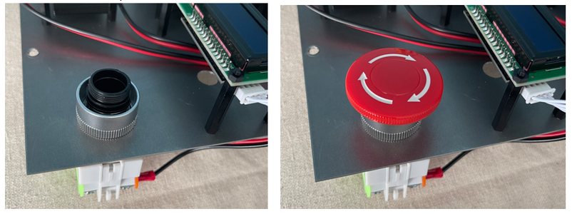

Step 20: Prepare EStop for Mounting
Retrieve the Emergency E-Stop Switch and figure out which contact terminals are the Normally Closed ones (the terminals that have continuity when the button is NOT pressed). In the case of this switch (and most switches), it is the orange block.
Then remove the top cap and the silver plastic nut by unscrewing them from the switch, as shown in the photo.
Lastly, install harness HA-010 to the E-Stop Switch, as shown below. In this case, polarity is not important.

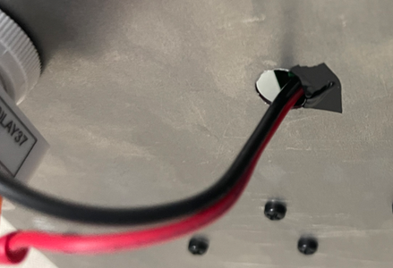

Step 21: Mount & Connect EStop Switch
Mount the E-Stop Switch in the MA-011 Panel as shown in the photos.
Then route harness HA-010 from the E-Stop Switch towards the “EStop1” Terminal in the Control Board, as shown in the photos.
Add some electric tape to the hole thru where HA-010 passes, so that the harness does not rub against the metal sharp edge (as shown in the photos).
Connect harness HA-010 to the “EStop1” terminal in the Control Board. For this connection, polarity is not important.

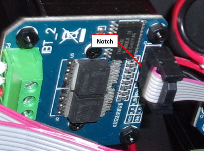

Step 22: Connect Ribbon Cables
Retrieve the 8-Pin (2X4) Flat Ribbon Cables and connect them from the Control Board to the H-Bridges in the sequence shown in the photos. On the H-Bridges, mind the notch in the Ribbon Cables to point towards the modules’ resistors.

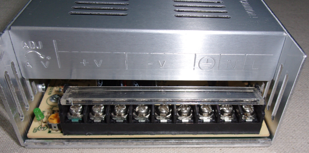

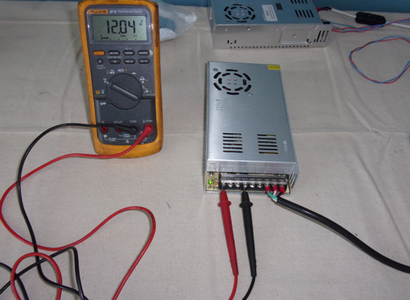

Step 23: Inspect Your Power Supply
Retrieve the 12Vdc/360W Power Supply and inspect it. Read all applicable manuals for your unit! While most power supplies are very similar to each other, there might be some differences with the model you purchased.
Note if your unit has an input voltage selector switch; set it up to the correct voltage for North America, which is 110V.
Inspect the input/output block for your unit. The three terminals, L, N, and Earth are where we are going to connect our AC input from the wall outlet. The terminals +V and -V are the 12VDC voltage output terminals for our machine.

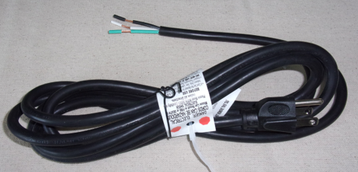

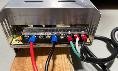

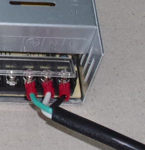

Step 24: Install the Power Cord & Test the Power Supply
Retrieve the 3-Wire Appliance Cord. You can crimp 16-22AWG For Terminals to each wire, but this is optional (if you do, inspect your crimps to be strong/secure).
Install the Black Wire to “L”, the White Wire to “N”, and the Green Wire to the Earth symbol, as shown in the photos. This Black to Line and White to Neutral follows the color sequence standard for North America.
Connect the Power Cord to a wall outlet and measure the DC Output Voltage (from +V to -V) of the Power Supply; it should be around 12VDC. Your unit may have a small adjustment know, which can be turned to adjust the voltage.

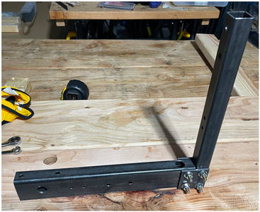

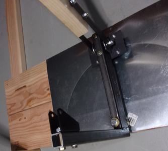

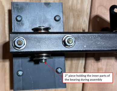

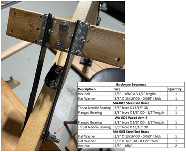

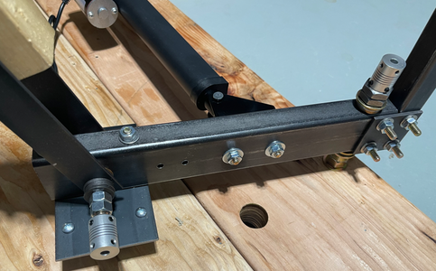

Step 25: Metal Base Assembly (Part 1)
Retrieve made components MA-012 Base Tube-H, MA-013 Base Tube-V, the two MA-014 Base Brace-V, and the indicated hardware in the photos. Assemble MA-012 and MA-013 using the MA-014 braces and the hardware, as shown
Step 26: Metal Base Assembly (part 2)
Retrieve the MA-004 Base Brace-F and the indicated hardware for this step. Assemble the MA-004 Brace to the Base Tube Assembly, as shown in the photos.

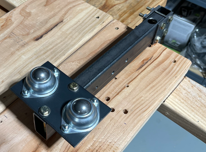

Step 27: Metal Base Assembly (Part 3)
Retrieve the 1” Roller Ball Bearings and the indicated hardware for this step. Assemble the Roller Bearings to the Base Brace as shown in the photos.

a) Insert the Hex Bolt through the 1/2" hole in the Wood Base, pointing upwards. On the “Up” side of the base, fasten the bolt with a washer and a Hex Nut.
b) Add a second Hex Nut and “lock it” in place by holding the bottom nut with a wrench and tightening the top nut (see example in the photos).
c) Insert a Flat Washer, the Thrust Needle Bearing (together and in-between its two skinny washers), another Flat Washer, and a Flanged Bearing pointing upwards, as shown in the photos.
d) Mount the Base Tube assembly on top of the Flanged Bearing.
e) Slide in the Flanged Bearing pointing downwards. If you notice that the Bolt is off-center from the top hole in the Base Tube, in such way that you can’t even insert the Flanged Bearing through, you may fix this issue by adding/removing a washer in the lower stack.
f) Add the next hardware in the sequence: the other Thrust Bearing (together and in-between its two skinny washers) and a Flat Washer.
g) Add one Jam Nut and secure the assembly in place. Do not tighten the nut hard, as the assembly should be able to rotate freely, but do not leave loose either.
h) Add the last Jam Nut and “lock it” in place using the same technique we used to lock in the bottom Hex Nuts.
i) Inspect your work. The Base Tube Assembly should rotate freely, while being secure the Wood Base.
Step 29: Install Actuator Mounts to Base Tube
Retrieve two Actuator Mounts from your Linear Actuator kits, and the indicated hardware for this step. Assemble the Actuator Mounts to the Base Tube assembly, but only hand-tight all screws (all screws will be tightened later). Mind the orientation of the Actuator Mounts as shown in the photo.
Step 30: Assemble WA-006 to Wood Base
Retrieve the WA-006 Post-M, two Corner Braces and the indicated hardware. Assemble first the Braces to the WA-006 Post, and then to the Wood Base, as shown in the photos (mind the washers go underneath between the locknuts and the wood).
Step 31: Install Actuator Mount to WA-006
Retrieve one Actuator Mount from your Linear Actuator kits, and the indicated hardware. Assemble the Actuator Mount to the Post-M assembly, but only hand-tight all screws (all screws will be tightened later). Mind the orientation of the Actuator Mounts as shown in the photo.
Step 32: Assemble Brackets to WA-003
Retrieve the four pieces of MA-005 Mid Bracket and the WA-003 Arm-F, and the indicated hardware for this step. Assemble the MA-005 Mid Brackets to the WA-003 Arm-F as shown, but only hand-tight all screws (all screws will be tightened later).

Step 35: Assemble Corner Braces to MA-003
Retrieve the two MA-003 End Brace-S, and the indicated hardware for this step. Assemble the Corner Braces to the End Braces as shown below, but only hand-tight all screws (all screws will be tightened later).
Step 36: Assemble Actuator Mount to WA-005
Retrieve the WA-005 End-B, one Actuator Mount from your Linear Actuator kits and the indicated hardware for this step. Assemble the Actuator Mount to the End-B, but only hand-tight all screws (all screws will be tightened later).
Step 37: Attach MA-003 Braces to WA-005
Retrieve the two pieces of the MA-003 End Brace assemblies from step 35 and mount them to the WA-005 End-B assembly, with the indicated hardware for this step. Mind the correct orientation of the parts as in the photos below, that the washers go between the wood and the locknuts, and to hand-tight all screws (all screws will be tightened later).

Step 39: Arm-F Swivel Bearing Assembly
Now we will build our first arm swivel bearing. Like before, I will first show you the end-product in the photos, and then explain the steps to achieve it.
a) Pre-assemble the inner components of the bearing with the help of the 2” cut piece tool. Remember that the Thrust Needle Bearing goes together and sandwiched between its two skinny washers.
b) Reach out for the shorter end of the Arm-F assembly (steps 8-9) and align it with the bearing. You may now notice that we previously left the MA-005 Bracket assembly somewhat loose, to assist with this step.
c) Slide in the 3/8” Hex Bolt thru the bearing assembly. The 2” cut piece tool will be ejected on the other side.
d) On the thread end of the Hex Bolt, add three thick washers and secure the assembly with a Hex Nut. Again, the assembly should not be loose, but also not so tight that it cannot move/swivel.
e) Add the second Hex Nut and “lock it” in place with the technique discussed during the Base Swivel assembly.
f) Have both pieces of the MA-005 Brackets aligned, and now tighten the bolts that fasten them to the Arm-F assembly.
g) Inspect your work. The Arm-F assembly should swivel freely.

Step 41: Arm-S Swivel Bearing Assembly
By now, you should be a pro in this swivel bearing assembly business, so next you are going to reach for the short end of the WA-004 Arm-S assembly (step 10) and attach it to the Arm-F assembly, with a similar process as in step 15, and per the hardware sequence shown in the photo below. Mind that the thread side of the bolt should be on the same side than the swivel assembly built in step 39.

Step 43: End Piece Swivel Bearing Assembly
By now, you are ultra-pro in this swivel bearing assembly business, so I am just going to provide you a list and a photo of the last bearing assembly, which attaches the End-B assembly (step 37) to the Arm-S. The process is similar as in steps 39 and 41. Mind to tighten all the #10 screws in End-B assembly once the swivel is correctly built and aligned.

Step 47: Mounting Flexible Couplings
Retrieve the modified flexible couplings and mount them to the thread end of each swivel bolt, as shown in the photos.
Step 48: Mounting Potentiometers to Braces
Retrieve the four 10K Potentiometers and mount them to the MA-007 & MA-008 Sensor Brace pieces, as shown in the photo. Hand tight the Potentiometers, they will be later fully tightened.
Step 49: Mounting Sensor Assemblies to BaseTube
Retrieve the Sensor assemblies and the indicated hardware shown in the photos. Mount them to the Base Tube assembly, while being aligned to the Flexible Couplings. Note the 1/4” Nuts acts as spacers between the Sensor Brace and the Base Tube. Make sure the Potentiometer is perfectly aligned to the Flexible Coupling before tightening all the hardware.
Step 50: Mounting Sensor Assemblies to Arm-S
The other two Sensor Assemblies mount as follows:
a) Align the Sensor assembly to the Flexible Coupling and mark two holes to drill in the wood, as shown in the photo.
b) Drill 7/32” thru holes at the marked locations into the wood.
c) Mount the Sensor assemblies using the indicated hardware. Make sure the Potentiometer is perfectly aligned to the Flexible Coupling before tightening all the hardware.

Step 53: Mount Control Panel to WA-002
Mount the Control Panel assembly to the top of the Post-P using two #6X1” wood screws, as shown in the photo.

Step 55: Installing Base Sheet (optional)
The next step is optional: retrieve the 24”X36” Sheet Metal plate, and, using some steel-cutting scissors, cut it to size so it can slide underneath the Base Tube assembly, as shown in the photo below. Mind to make “U-shaped” cuts at areas like the 1/2” Pivot Hole and the Post-M brace. Then fasten the panel to the Wood Base with nails or staples.
The idea of the plate is that it makes the arm’s lateral motion much more smother than if the rolling bearings rolled over the rough wood. I am not entirely happy with this solution, but it is better than nothing (you are encouraged to figure out some alternative smoothing scheme).

Step 57: Connecting Harness HA-008
Retrieve harness HA-008 and connect one end, red & black wires to the Control Panel, as shown on the picture (red to red & black to black).
Then connect the other end of harness HA-008 to the Power Supply, as shown on the picture (red to V+, black to V-).

Step 59: Connect All Harnesses
Route and connect all harnesses according to the table above. Reference the photos and mind the following tips:
a) Reference the table for all harness routings.
b) For harnesses HA-001, HA-002 & HA-003, red lead connects to the M+ terminal in the corresponding H-Bridge, and black lead connects to M-.
c) The other end of harnesses HA-001 thru 003 connect to the Linear Actuator leads red to red and black to black.
d) Linear Actuator M0 connects directly to H-Bridge M0 (red lead to M+, black lead to M-).
e) Lay harnesses loosely at location where the assembly moves during operation, anticipating the robot’s movement.
f) The 5-Pin Housings of the harnesses HA-004 thru 007 should insert easily to the terminal pins in the Potentiometers; if the Potentiometer pins are bent/crooked, use some Needle-Nose pliers to straighten them up. Don't mind polarity for now, as the Potentiometers work with the connector plugged in either way.
g) Use cable ties as necessary.
h) Do not worry if you do not get the routing perfect the first time; you can always cut the cable ties and improve your work.
Step 60: Install 16-Bit Controller
Plug in the 16-Bit Controller to the DB9 plug in the Control Panel
Step 61: Machine Startup
Plug in the Power Cord to an electrical outlet or (better) to a power strip. Power strips have switches that you can use to turn the machine’s power ON/OFF. Whether you disconnect the machine from the outlet, or your turn the power strip’s switch OFF, you MUST power off the equipment when not in supervised use.
The machine has two operational modes:
MANUAL (default): the machine can be operated via the 16-Bit Controller
REMOTE: the machine can be operated via commands from another Arduino.
Provided everything was connected as per the instructions, the photo here shows how to control the motions using the 16-Bit Controller (if some motion is backwards, you can fix it by inverting polarity at the Linear Actuator in question).
Step 62: Check the E-Stop Light
When you power the machine for the first time, the first item to check is that the E-Stop LED light is turned ON. If you push the E-Stop button, the LED light should turn OFF. The E-Stop is a hardware electrical stop and will disable all outputs from the H-Bridges. If the LED is ON, motions are enabled.

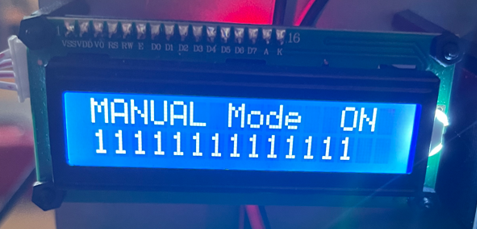

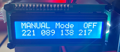

Step 63: Test Motions in Manual Mode
Let’s test our machine in Manual Mode:
Our default screen is in Manual mode, being OFF, and a series of 1’s, which represent motion commands - more on that later, but what you need to know now, is that they should all be 1’s.
If you press the “Start” button in the controller, Manual mode changes to ON, and now motions are enabled. Use the controller to test all the motions.
While testing motions, note the following:
a) Pay attention to your cable routing and verify the cables don’t get damaged/pulled.
b) Some of the 1’s in screen change to 0’s when pressing certain buttons.
c) Actuator motions cannot all occur simultaneously, but in pairs: M0 & M2; M1 & M3. This is a software feature meant to limit current demand.

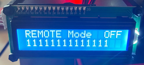

Step 65: Inspect Remote Mode
Press the “Mode” button in the Controller to switch to Remote Mode. The Remote Mode screen looks very similar to the Manual Mode screen:
The difference is that the 1’s here represent motion commands being received via Serial communications. The default value is 1’s (no motion is commanded). If you count the 1’s, there’s 14 of them, or 14 bits.
The left-most bit is Bit 13, and the right-most bit is Bit 0. The attached table shows you the Bit and “button press” in the controller they represent.
If you press the “Z” button in the controller, the Remote screen also shows a series of blocks of numbers, but here the first two blocks having a value (255 is default) and the last two blocks are all 000.
The first two blocks represent PWM references for M0 and M1, where 255 is full ON, and 000 is OFF. In this design, only M0 & M1 have the option for PWM regulation, and PWM regulation is only allowed in REMOTE Mode (MANUAL Mode is only full ON/OFF).
