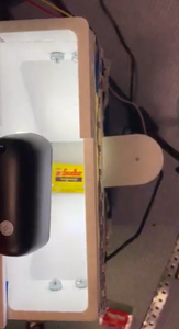

Step 3: Attaching the Building Sorting Mechanism and Detection System
This mechanism is for detecting what type of candy is present and directing the candy in the proper box.
  1. Fit the Candy Sorter Lever Chamber below the final version detection box.
  2. There should be a space between the candy Sorter Lever Chamber and the final version detection box for the candy sorter rotator to fit.
  3. On the arms of the Candy Sorter Lever Chamber sticking up the sides of the detection box, drill two holes through each arm and through the detection box.
  4. Insert screws through the four holes (two on each arm) such that it goes through the arm and into the detection box.
  5. Secure screws inside the detection box with screw nuts.
  6. In the rear of the machine, hot glue connectors to a servo holder (with a VEX servo inside) onto the back of the storage candy holder, with the shaft hole facing upward.
  7. Attach the candy sorter rotator to a VEX drive shaft, and fit the drive shaft securely into the VEX servo.
  8. Align candy sorter rotator such that it fits into the space between the detection box and the lever chamber.

Step 9: Final Assembly and Test
Use the Black Round Rocker On/Off Switch to turn on the 12V LED light and the LED string light. Start by placing candy one by one down the ramp to start sorting. Please wait until the candy finishes sorting before placing the next piece of candy.
Step 10: Decorate As You Desire!
Once the project is completed and everything works as you wish, feel free to decorate the project as you wish. Add a Halloween spin with spooky ghosts, flying bats, or jack o’ lanterns. The options for creativity are endless!
