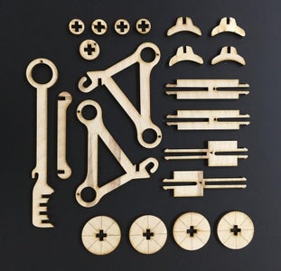

Step 1: Getting a Reference Image

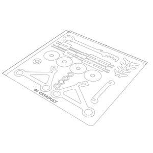

One of the key steps of reverse engineering is to figure out the components of the catapult. For my case, I broke down off-the-shelf catapult schematics from an online image of a figurine and laid them out for visualization. Using a top-down image basically shows the entire blueprints of the design.
Next, open up illustrator or Rhino 5.0, and make traces of the image using vector lines and curves. A tip is that I had to size a relative dimension of the size of the design which I want and scale the design accordingly.
A few pointers to note:
  • Interfacing elements (e.g. slots) has to match the thickness of the material sheet
  • Tolerances for certain snap-fits have to be fine-tuned as well
  • Fortunately, with a lasercutter, iterative prototyping is extremely fast
Step 2: Understanding the Mechanics
From tracing and iterative process of prototyping, I managed to understand how each component interacts with the other. The concept of interlocking joints, laser-cut collar shafts and bearings are really interesting concepts to take note of. This will definitely bring me to the next level to create new toys from these learnings.
A few pointers to take note of:
  • Wooden materials are isotropic, making sure that you cut along/across grain depends on the mechanical load that the component is to take.
  • Compliant snaps should not have thicknesses that are less than 1.5mm else the beam will have a high risk of breakage (have to negotiate the clearances and tolerances)
  • The catapult slots have to be a tight fit to snug in place else it will be loose and glue is required (undesirable)
  • Once your blueprints are sorted you may scale it to other materials too!
As some of you have noticed, I have quite a few failure pieces. The point about reverse engineering is not about the outcome but the process of learning from it.

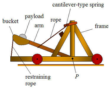

For convenience, I have attached a graphic on the different components of an Onager Catapult. (By Rpanjwani3 - Own work, CC BY-SA 3.0, https://commons.wikimedia.org/w/index.php?curid=1...)

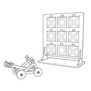

Step 4: Further Explorations
Feel free to drop down a comment, if you think I should scale this bigger or bring this further! Drawing inspiration from online material, I have some plans to design target boards as well as creating projectile balls (which is already proven to be doable) and possibly make this a carnival game for my future kids? What do you think?
