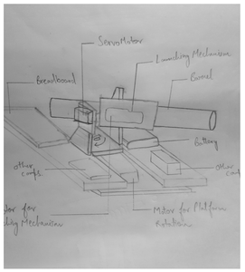

Step 1: well step 1 would be to test your components, but let’s not beat around the bush.
I have attached several of 2D drawings, including hand and CAD models. I have also tried adding one Isometric view of the model which was sketched during the early days by one of the partner in this project dont get confused by it
Since I am lacking final project pictures (there is a reason for that) for better understanding I revisited all of the sketches and made few with more clarity in them i.e. a Top view and a Side View
we tried simulating with the same length ratio to the arms in the slider crank mechanism used, here for simulation motiongen came in handy (Before 3D printing the arms, it’s better to simulate them first—but this step can be skipped if necessary)
below is the sim.

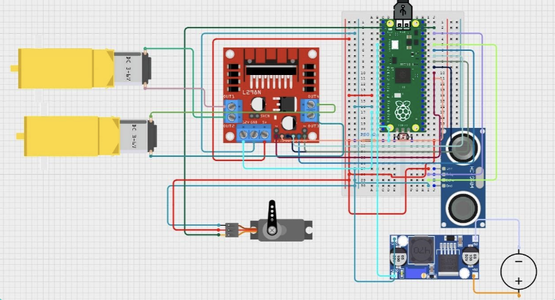

basic synopsis of the circuit diagram: refer it for connections
Raspberry Pi Pico (top right)
L298N Motor Driver (red board)
2 DC Motors (yellow)
Servo Motor (grey, bottom center)
Ultrasonic Sensor (blue with two round eyes)
Buck Converter (blue rectangular board bottom-right)
Step 4: From the Above Step, Circuit Integration:
1. Motor Driver (L298N) Connections
Power:
  1. VCC (12V input): Connected to buck converter output (regulated power).
  2. GND: Common ground shared with Raspberry Pi Pico and other components.
  3. 5V ENABLE Jumper: Appears to be connected (this allows the driver to internally regulate 5V logic).
Logic Pins (to Pico):
  1. IN1: Connected to GP14
  2. IN2: Connected to GP15
  3. IN3: Connected to GP16
  4. IN4: Connected to GP17
  5. EN1: Connected to GP12 (PWM to control Motor A)
  6. EN2: Connected to GP13 (PWM to control Motor B)
Output to Motors:
  1. OUT1, OUT2: Connected to Motor 1
  2. OUT3, OUT4: Connected to Motor 2
2. Motors (Yellow DC Motors)
  1. Connected to OUT1/OUT2 and OUT3/OUT4 of L298N respectively.
3. Servo Motor (Gray)
  1. GND (Brown) → GND rail
  2. VCC (Red) → Connected to Buck Converter’s 5V Output
  3. Signal (Orange) → GP18 on Raspberry Pi Pico
4. Ultrasonic Sensor (HC-SR04)
  1. VCC → Connected to Buck Converter 5V
  2. GND → GND rail
  3. TRIGGP3 on Pico
  4. ECHOGP2 on Pico
5. Buck Converter
  1. Input (left side):
  2. VIN+ → External power supply (e.g., battery)
  3. VIN- → GND of external power
  4. Output (right side):
  5. VOUT+ (5V) → Powers Servo, Ultrasonic Sensor, and optionally logic of Motor Driver
  6. VOUT- (GND) → Common ground with Raspberry Pi Pico
6. Raspberry Pi Pico (Main Controller)
Digital GPIO Connections:
FunctionPin (GPIO)
Motor EN1: GP12;
Motor EN2: GP13;
Motor Direction: GP14-GP17;
Ultrasonic TRIG: GP3;
Ultrasonic ECHO: GP2;
Servo Motor Signal: GP18;

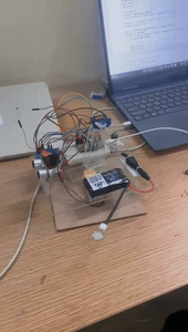

so for the reason of not having a final photo of the project: each member on this project i.e. 4 including me were overdue on something or the other on their schedule and at the day of the presentation of this the Prof was unreasonable and pretty much did not see our presentation which really spoiled our next 24hrs in amidst of all this we totally forgot on clicking the completed bit. this project was fun nonetheless and had alot of learnings in it
