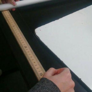

Step 4: Step 5: Put Measurements Into Acton
In the next picture we have taken our meter stick and measured out 10 cm apart that way horizontally they are all evenly spaced because of the constant acceleration. Then lining our pipe up at 80 (because its our max height) we were able to find each individual point.
So starting at 80 we measured back to 0 and cut a line.
Then we taped the string to the pipe.
Then we continued by taping the ping pong ball to the end of the string.
Our net line we did the same thing except measuring to 18 cm, the next line 34 cm, and so on.
Until we arrived on our final result (Last Picture)
