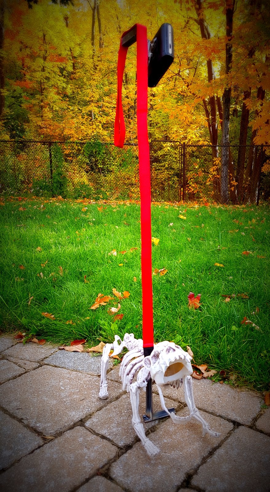

This project has been haunting me since I found this skeleton dog decoration in the clearance bin at my local pharmacy after last Halloween. I had just completed my Projection Mapping Mask and was looking for a more practical way to carry around this mind-blowing illusion. I also had a blast walking with my daughter's stuff dog on a fixed leash on vacation a few years back (pretending to have it pee on poles and sniffing other dogs).
If you haven't figured it out out yet, the dog leash is a length of steel angle bar upon which I have attached a projector near the grip. The geometry is fixed so I was able to map (or trace) each individual bone in a software designed mainly for use in art installations or DJing (HeavyM). I recorded the video as a screen capture, and I play it back on a loop on the projector (which is also an Android "tablet"). Please watch the video for instructions on how to use the software (there is a free version).

Step 1: Look Up Dog
The dog skeleton was looking rather forward, and I figured it would look better if I can project onto its face, including the teeth. So after some prying it came right off; so I predrilled the plastic and screwed it right in at the angle I wanted.
Step 2: Decide on a Geometry
Getting the distance is essential with this type of project, because the projector needs to be far enough to get the whole target; but too far and you lose precious lumens. I also played around to get the angle just right, I wanted it to appear that the dog was leading me; but I couldn't go too far back, or I would lose the optimal projection angle. I ended up going around 8 degrees back from the vertical.

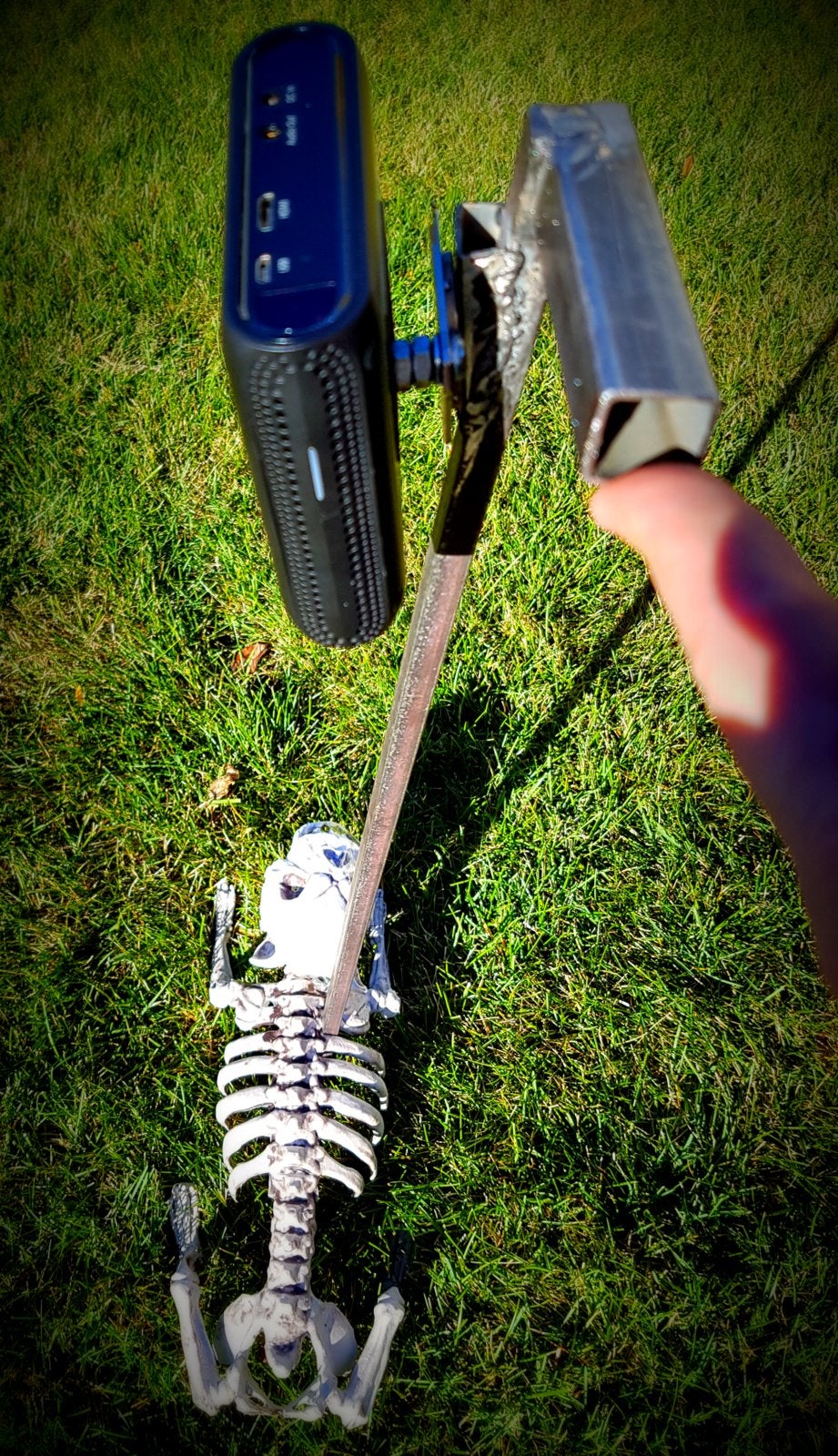

Step 3: Steel Work
A big challenge with projection mapping on a moving object, is that the projector and the target have to be fixed in 3 dimensions and all the angles. I considered several materials and geometries but settled on steel angle bars, for the absolute stiffness. Aluminum would have been lighter, but I don't have the tools to fabricate with Aluminum. It is really important to get your angle right, I did quite a bit of adjustment of positioning to see what were the angles I wanted and how I was going to thread it through the dog. There are only three pieces of steel basically shaped as a "C". The vertical piece goes all the way to the ground which helps provide support. The second piece runs along the inside of the spine. I drilled several holes along the length to fasten it to the dog with screws.
You need to weld these first two pieces together before you thread it through the gap in the dog's back. Once you are happy with this geometry, you can weld on the handle. See the photos, it should be quite self explanatory.
Step 4: Fastening to the Dog
A series of short screws are used to fasten the frame to the dog.
Step 5: Projector Mount
The projector needed to have a slight angle to the support to keep the projection onto the dog. To deal with this, I welded a wedge of square tubing onto the vertical piece. I was quite challenging to get the right angle and keep it from moving while I welded, so I stuck a screw down the wedge to help keep the gap fixed.
The projector is actually magnetically attached with a mount that I have used for several previous projects using magnets harvested from old hard drives: Magnetic Projector Mount.
