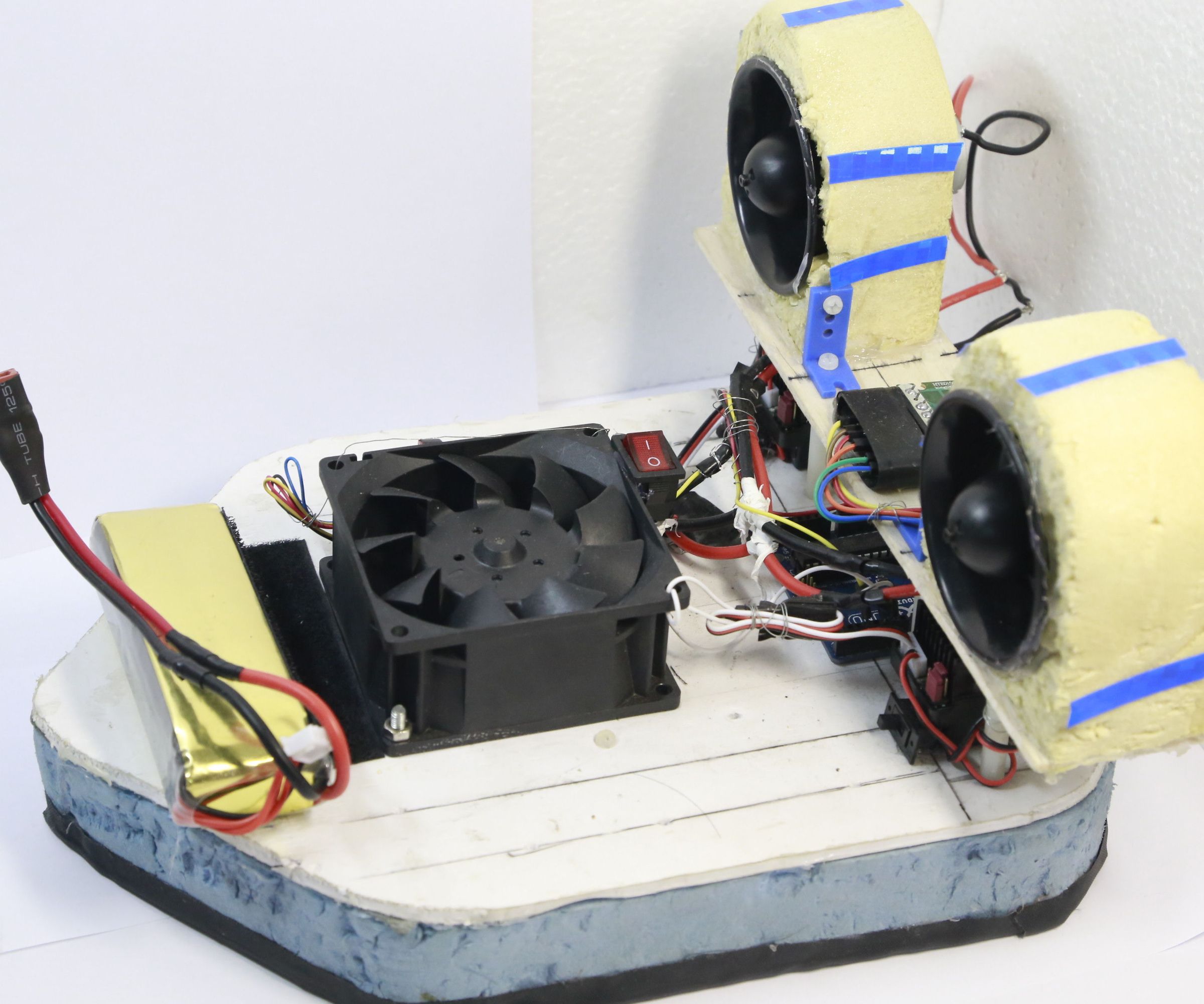

We wrote an instructable about Remote-controlled hovercraft last time (https://www.instructables.com/id/Remote-controlled-...). This time, we will introduce how to make a projection-making advertising blimp.
