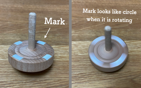

Stick a mark around the top. Then, when it is rotating, the mark looks like a circle, and when it stops rotating, the mark becomes a point. By detecting this difference with the camera, I should be able to detect whether it is rotating and the position of the top.
The image of the field is taken by a camera mounted on the ceiling and processed by Raspberry pi. Python is used for programming, and the OpenCV library is used.
Since the top is circular shape when viewed from above, camera will detect the circle shape even if it is stopped. It is difficult to detect only the mark on the top.
I came up with the idea of using an IR camera to detect only the marks. Install an infrared light next to the camera and install a filter that allows only infrared rays to pass in front of the lens.
Reflector is used as mark on top, you can detect only the mark without seeing the outer shape of the top from the camera.

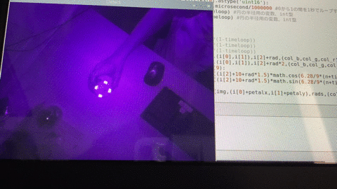

Step 3: Programing and Test the Function
Make a draft program and test it on desk top.
OK, it looks working good!
Attached program is the finalized one.

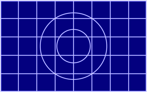

2 background image are attached. The image width and height are depends on your projector. Please make the image as you needed.
To make full screen of the effect image, there are 2 option.
First is to make the program to be able to full screen. But, from my experience, this way makes processing speed very slow.
Second option is to use projector's function. Most of projector have a function that zoom the part of screen area. By using this function, zoom the effect window then you can show pseudo full screen. This way doesn't effect to the processing speed.

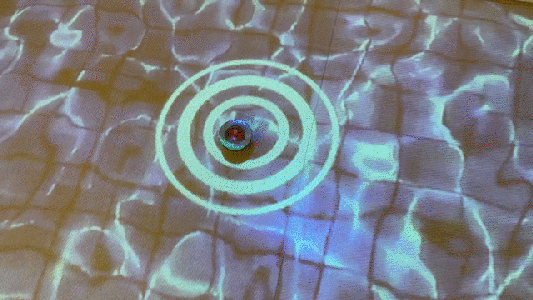

Step 6: Enjoy the Spinning Top
Now you can enjoy spinning top with effects!
