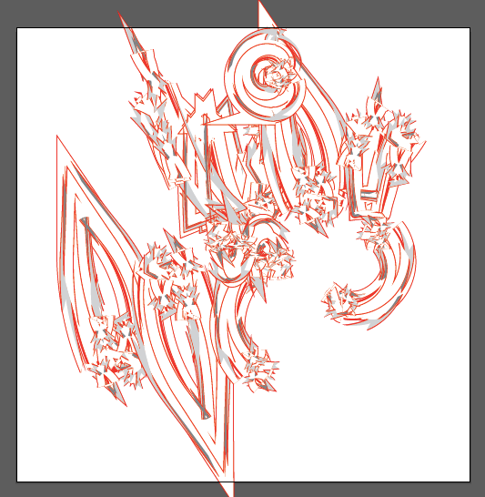

Step Three: Preparing the digital image.
- Open the digital media in a image manipulation program. Make sure you can locate the image projected on the wall and on the screen: Its necessary to read these two images against each-other. The projected image will be a distortion of what is on the screen.
- Place the image in the middle of another blank file several times as many pixels in width and hight as the media.
- Find the top bottom left and right limits of the image you want to project and then make a outlined box incasing these limits.
- Divide this box vertically with lines the same number and way as the parallel lines marked on the wall wall.
- edit the color of the image if the contrast with the wall is not good enough.
Step Two: Scaling the digital canvas with the physical canvas.
- Locate the top left corner of the intersection between the furthest top and left parallel and vertical lines.
- select a masking or selection box just bigger than the limits of the image.
- Drag the same corner of the digital coordinate to hover over the physical coordinates.
- Resize the image maintaining the ratio of width to hight (fixed aspect ratio) so that the the second line down at the intersection of the left hovers over the physical version of the same coordinate. (Note: its important to note the zoom level the image is being sized to)
-find the ratio between the length and width of the digital box
-find the ratio of the scale of the physical & digital hight of the image, you can then use this to locate the rightmost boundary line of the digital model in in the physical space of the wall. This step will only work roughly and the best measure is by eyeballing it, but locating this line well will mean less eyeballing.(O)
Step Three: Distort the digital image on the screen so it looks as if it Isn't distorted on the wall.
- Select the binding box on the digital image with a masking rectangle
- Use the distort function to turn the corners of this box into movable anchor points. By dragging these, you can distort the box into a trapezoidal shape where everything bound by them gets pushed and pulled in the direction the anchor points are moved.
- While looking at the projection on the wall, drag the anchor points so they hover over and correlate to the corners of the box on the wall. If you haven't found the coordinates closely you can move the lines until they are parallel with the lines of the line marked up on the wall. Making the lines parallel is most important because it ensures the image is parallel with the plane of the wall; matching the anchor points to the corners is secondary as it ensures that the hight to width ratio is maintained.
(tip: if your image is too big to distort easily, you can zoom out to a level where you can see the whole image and then go on to moving the lines of the digital box so they are parallel with the physical ones. when you zoom back in to the original scale the width to hight ratio will be off and need further eyeballing and edits )
- At this point you need to asses how acceptable the projecting image is for mapping the physical media to the wall. You maybe have to resize the width hight, distort, zoom out and in several times till you are happy with the image.
