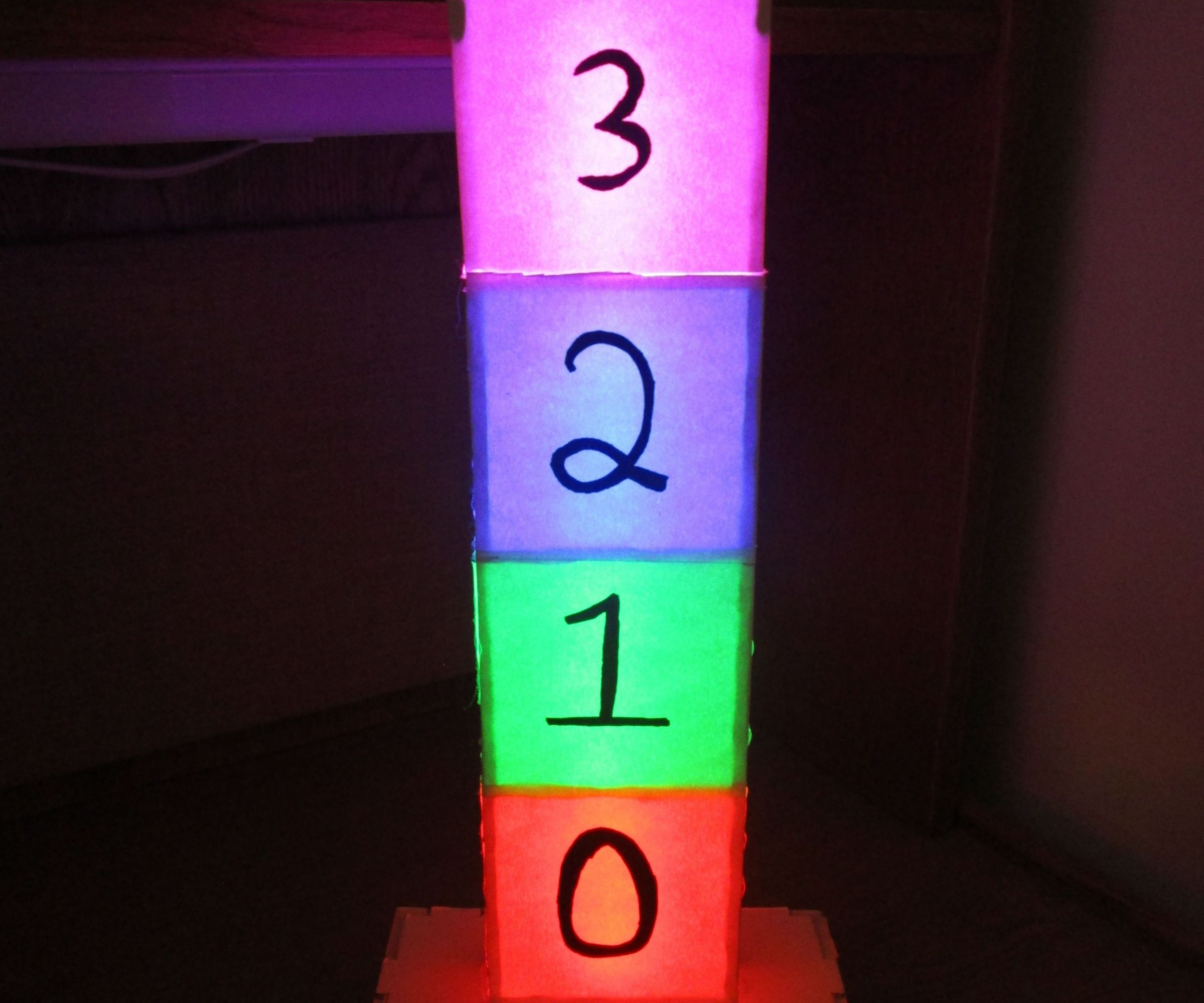

Projects that Change Light was a project inspired by all of the connected devices that are around us. Often times we don't want a loud BEEP to go off whenever a device (or several) needs to get our attention. Lights are an excellent way of solving this problem because they can be subtle in everyday life. With a range of colors to use they would make a great addition to any home device (or project!) so can it be done? This project shows that it can be done by using Webhooks to interact with any internet connected device. Let's dig right in!

Now that you have your key, follow the pictures above to setup your very own light app. Trigger your app by using https://maker.ifttt.com/trigger/{EVENT FROM PICTURE}/with/key/{YOUR KEY HERE} in any internet connected device.
