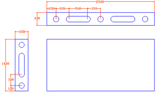

Step 1: Base Construction Detail
I first made some plans regarding dimensions and cutouts required for the base. The drawing shown illustrates dimensions for the base top and the 4 sides that were made. The wood is ¾ “poplar that was obtained from Home Depot. The circles were drilled using a 1.5” hole saw. To get the oval shape, two 1.5 “holes were drilled and a jig saw was used to remove the wood that remained between the two holes.

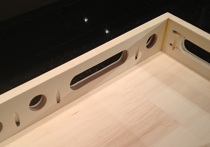

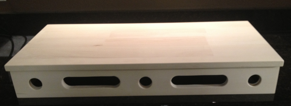

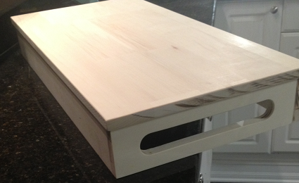

Step 2: After Drilling, Cutting, and Sanding
With the boards cut and the end pieces sanded down, the base front, sides, and back will look like the pictures. Both sides have the same pattern. As you can see, I went with one long oval instead of the two circles and oval shown in the layout drawing. The back is not seen and i just solid.
All boards are ¾” thick. The openings are for the back-lighting and have an opaque lens mounted to the back of each opening after the base gets hydro dipped.

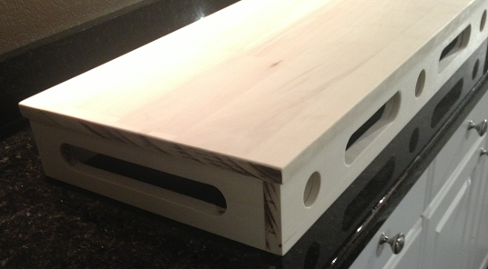

Step 3: Underside Construction Detail
The base is screwed and glued so it will not will not come apart and is very sturdy. Notice that I used pocket holes for the screws. I accomplish pocket holes with a Kreg jig. I use the Kreg jig for all wood working projects. The Kreg jog is easy to use and makes a rock slid hidden connection that is much easier than biscuit joining. You can get the Kreg jig, screws, square head bits, and everything you need at Lowes or Woodcraft.
The picture illustrates the pocket holes made to join the base top and sides together. I also use a woodworking glue and then screw it all in place.

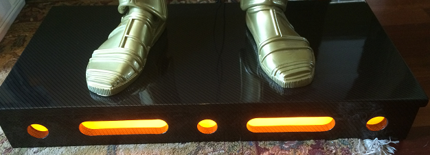

Now that the base was complete, I mailed it to Chrome Fish Customs in Florida to be Hydro Dipped. While I waited for the base to be finished, I got everything needed for the base backlighting.
Step 4: Backlighting

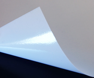

The goal was to have light emitting from the cutout areas of the base. Once the base returned from Hydro Dipping, I affixed .020 “LED light panel flexible acrylic sheet material on the inside of the base to cover the cutout areas. I just drilled small holes in the acrylic sheet and attached the acrylic to teh base with small wood screws. The material provides a diffuse matte white area that the light can transmit through. The material shown can be cut with scissors.
I ordered this material from www.tapplastics.com, it is sold as a roll that is 25” x 50” and it is not expensive.
