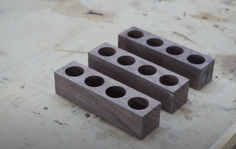

Step 4: Layout the Holes
For the Small Blocks (open design)
  1. Using a double square, layout the holes for the smaller blocks. Each block will have 4 holes for the tubes.
    • The thickness of the sides will offset the hole placement here.
  2. At the drill press, use a 1" Forstner bit to drill all the way through the blocks (make sure you have a sacrificial board at the bottom to drill into).
    • You can build a small fence that ensures all of the holes stay centered on the blocks.
    • Use an F-style clamp to hold the workpiece down while drilling will help reduce tearout.
    • Periodically, remove the bit from the hole completely to clear out the chips.
