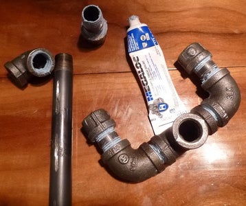

Step 2: Assembly
The burner itself was assembled by putting together the steel
fittings as pictured with Megaloc pressed into all of the threads. I cut burning ports into the sides of the 16in nipple using an angle grinder. I cut breather slits as well in to the caps on the ends of the legs because apparently that’s something you’re supposed to do with propane burners.
The copper line feeds the propane from the regulator line in to the burner. A hole is drilled in to the butt side of the burner. This hole matches the size of the outer diameter of the copper line and is stuffed ¾ of the way into the burner. This seems to give the ideal evenness of burn.
The other end of the copper line is stuffed into the rubber hose coming from the valve and is secured with steel clamps. I pulled this regulator assembly off of my camper, so use your own resourcefulness to find your own or put one together and adjust the size of the copper line accordingly.

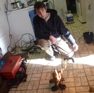

Step 4: Usage
I placed the propane tank on the opposite side of the wall from the
burner for that extra touch of possible safety. Then I neatly bent the copper line to trace its way along the walls’ mouldings and in to the burner. The resulting flame is actually pretty effective at heating a space and burns squeaky clean.
