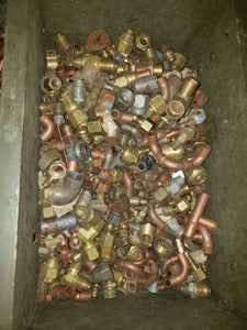

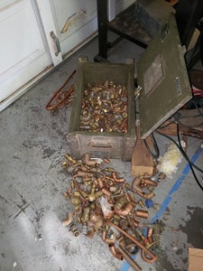

I've had a bot of copper and brass fitting laying around at my mom's house for decades. I built another instructable out of some of the pieces and thought I might as well build another. From the first picture you can see I built a fire pit and had a couple of the burners still laying around. We have a bbq that uses the little green Coleman cans and I got the idea to build an art lamp from the fittings, burner and propane can.

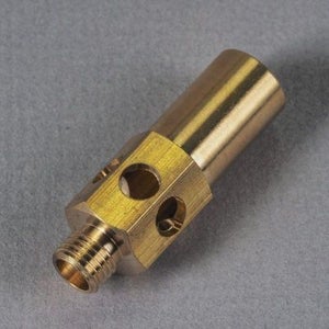

Copper pipe, copper joints, a burner, special fittings for connecting the propane can to the copper wire

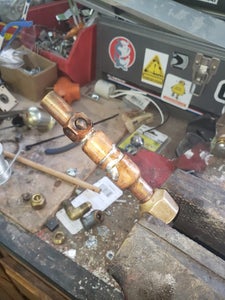

So I had all all these copper and brass pieces laying around and Just started futzing around with what I wanted my lamp to look like. Some of this, some of that, what pieces I really wanted to incorporate.
When I initially figured out what I wanted I cut the copper pipe to length. You can use a tubing cutter or hack saw. The tubing cutter is nice because it rolls the end of the pipe making it easier to put in the joint. With a hack saw you have to do a little sanding/maybe filing. Still easy stuff though.
Step 3: Assembly!
With soldering copper joints together, 'cleanness is next to godliness' is the the name of the game.
There are videos out there how to do this - and practice a few time until you understand the process. Also practice un-soldering a joint.
With that said, any copper being soldered together needs to be sanded so it's bright and wiped clean of dirt, grit and oil. Then any connection fluxed very well before putting the heat on a connection.
For the burner - that was 4 solder joints. I was also able to solder copper to brass - the burner. A little sloppy on the solder but very happy will pulling that one off!
