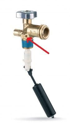

    Slightly off topic, but wondering if anyone can suggest a way that I can be acertain a stanar propane tank isn't pressurized? I'd like to remove a head off of a tank that I'm 99% sure is empty. (I'm making a hank drum) I can open the twist valve, and no sound or hiss, but i believe there's a 'safety' valve that only allows a release when it's attached to a hose/stove/whatever - which I don't have. Can I take it into a home depot and just attach a hose and try the valve? Is there a special tip that engages that safety valve?
    0
    amachinetech
    amachinetech
    Reply 5 months ago
    All portable propane tanks have this little screw. Some of them are star shaped. it connects to the dip tube that shows the level of liquid propane in the tank. If you open this it will vent the tank around the float overfill protection valve. If your tank is somewhat full it will take awhile but it will get it done.
    0
    Big Texun
    Big Texun
    Reply 7 months ago
    The propane quick-connect has a safety valve, it won't leak unless connected. So yes, your tank may be pressurized. They stopped putting purge valves on propane takes 30 years ago, so you pretty much need to open the tank up to purge it. Try removing the quick connect fitting with the valve closed, then crack the valve outside to see if anything comes out.
