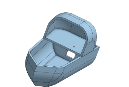

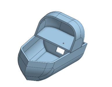

Our final CPX design is an operational propeller boat. A CPX is a micro controller that you can program to make a moving part which will be activated by a Servo Motor. The Servo Motor is a motor that can rotate or move parts with high precision and efficiency. Our final product has an attached 3D printed propeller that makes it functional in water. Our boat incorporates a cabin top, to hold our CPX and ensure it stays dry. Our final design features boat lights that illuminate from the cabin top and are accompanied by a boat horn. Our final product has been tested in water to ensure that it floats and keeps the wires and CPX dry.

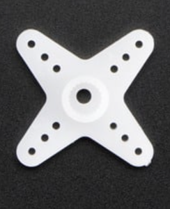

- Continuous Rotation Micro Servo

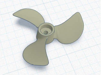

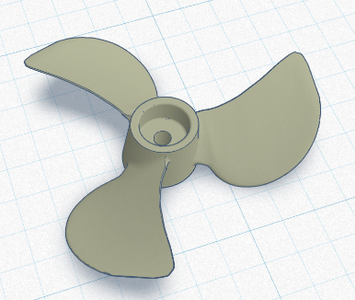

- Propeller Attachment

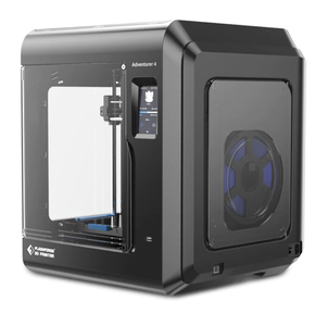

- 3D Printer

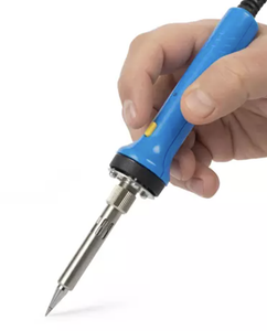

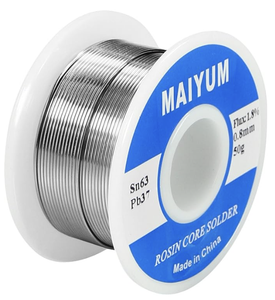

- Soldering iron and Solder

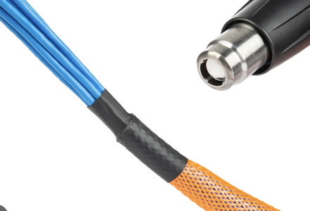

- Heat Shrink Tube and heat gun

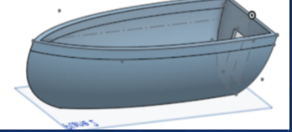

Step 1: Downloading the 3D Design

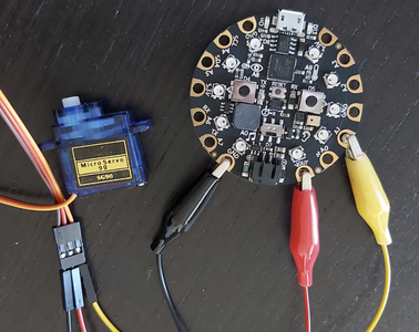

Step 3: Attaching & Connecting the Servo Motor
- Wiring
- Begin by Identifying the wires of the Servo Motor Wires; you'll find a green or black wire, which serves as the ground connection, a red wire for power, and a yellow wire that carries the signal.
- Connect the servo to the CPX:
- Connect the green or black ground wire to the ground pin on the CPX, labeled 'GND'.
- Attach the red power wire to the voltage output pin, denoted as 'VOUT'.
- Hook up the yellow signal wire to the analog input designated 'A1' on the CPX for signal control.
- Heat Shrink
- Select an appropriate size of heat shrink tubing that fits over the electrical connectors.
- Slide the heat shrink over the exposed areas of the wiring where the servo connects to the CPX.
- Use a heat gun or a lighter to carefully shrink the tube around the connectors

Step 4: Final Assembly of the Boat
- Make sure all parts are printed and ready for assembly
- Grab servo motor and glue to the rear hole in the back from the inside of the boat so the axel is sticking out of the boat
- For a tighter fit, put hot glue on the edges of the opening before inserting servo motor

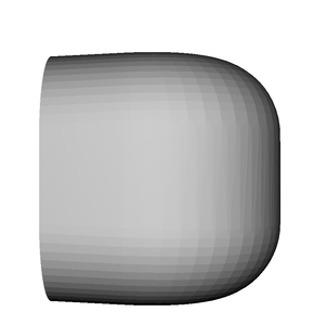

- Grab a hot glue gun and glue the bottom of the cabin to backside of the boat above the servo motor
- Glue the back of the propeller to the axle of the servo motor
- Take CPX and insert it into the cabin
- Make sure all wires are tightly tucked through the hole in through the front of the cabin
- Hot glue the cover for the boat so that it covers the frontside of the design
