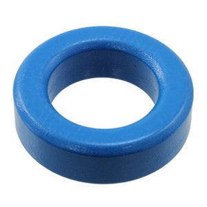

1x Toroid Core (Buy from reputable sources like Digikey / Mouser)

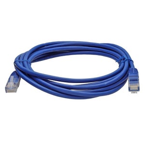

1x Cat 5 cable

Step 1: Choose Material for Toroid
Ok materials:
3C11, 3E6, 3E12, 3E10, 3E15, 3E25, 3E26, 3E27, 3E65
Ideal materials:
PC40, PC200
N27, N30, N35, N41, N49, N51, N72, N87, N88, N92, N95, N96, N97
T35, T37, T37, T38, T46, T57, T65, T66
3C90, 3C91, 3C92, 3C93, 3C94, 3C95, 3C96, 3C97

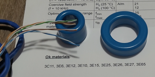

Step 3: Winding and Configuration
Wind the number of turns on toroidal core. Taking above example: 13-15 turns is ok. Less than 12 turns is not ok.
Wind the wire tightly. It’s important to use twisted cable to keep league inductance low.
Configure the wire for Half/Full H-Bridge configuration and connect them to appropriate pins of MOSFETs / IGBTs
