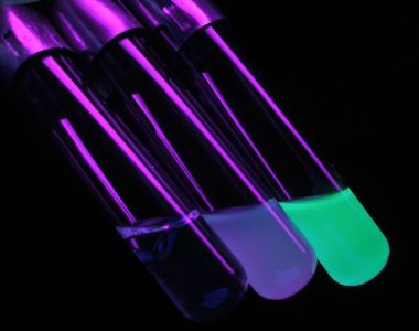

Microbiology is a very important part of science utilized by every sector of biology, whether that is to study medicines or create special substances that we need, such as insulin (the title picture above is not mine, but this is a colony of GFP, green fluorescent protein, producing bacteria). The "instructions" for these cells to create such useful products is contained on plasmids, small circular strands of DNA separate from the bacteria's main genome. The plasmids can be created by biologist and then inserted into bacteria such as E. coli, where they will be maintained and copied into future generations of bacteria. These special bacteria can be held in a -80 C freezer until needed and then thawed out and put into a broth solution, facilitating their rapid growth. Overnight, a scientist can have millions of copies of a plasmid-containing bacteria ready to produce the desired product.

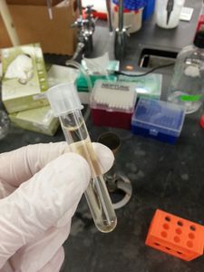

Now we want to aliquot our Kanamycin-spiked LB broth to a small BD Falcon 5 mL polystyrene round bottom tube. This has a special lid that doesn't tighten fully, allowing for some gas to escape, which is why we use this to grow our bacteria since they produce gas as they grow and live. This means, though, that we must be careful not to tip it over or mix it through inversion.
So use the same technique as before to add 4 mL of our antibiotic LB broth to 5 mL Falcon tube, keeping everything near the flame. Then we need to add our bacteria. We store our bacteria glycerol in a -80 C freezer and this gives the solution a gel-like consistency. Therefore, we can just stick in the tip of a pipette into our mother colony and then dip it into the broth. This won't transfer very much bacteria, but enough to form a colony overnight.
Step 5: Finishing Up
To finish up, we leave it overnight on a shaker in an incubator set at 37 C. In the morning we can retrieve our colony which will have a hazy look to it. Congratulations, those are our bacteria with our GoI!
