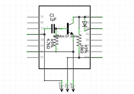

Step 3: ESP-now: Transmitter
I use a Wemos D1 mini with external antenna connection as transmitter.
If you have a Wemos D1 mini (pro) with an antenna connection and want to use an external antenna, you must first desolder the zero resistor facing the internal antenna. Then solder the resistor or a piece of wire towards the external connection.
To be independent from the power grid, the device is driven by a solar cell with a 18650 Battery Expansion Shield V3. The shield consumes a little more energy than a homemade charging device, but our Wemos D1 does not need much power.
Principle: The Wemos D1 is in deep sleep to save power. It is woken up by a movement/signal from our PIR sensor and sends a message to the receiver in the house. When it gets an acknowledgement from the receiver, it goes back into deep sleep. If it gets no confirmation, it tries four more times, then it still goes into deep sleep.
Then the solar cell can recharge the battery.

Step 4: Transmitter/PIR Hardware
In order for the PIR sensor to wake up our ESP, we need a small circuit. I found a circuit diagram on the internet and modified it for my use. I could just fit the components between the pins of the Wemos. So I now have a compact device on a circuit board.
