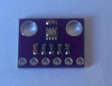

* Optional environmental sensor: BME280 (pressure, temperature, ambient humidity).

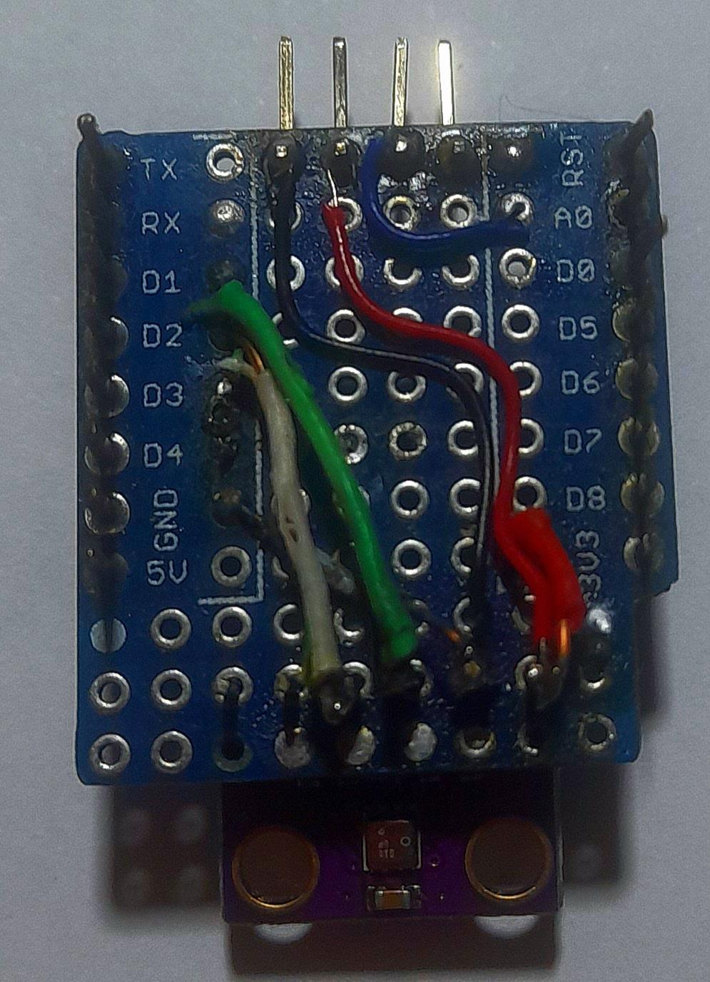

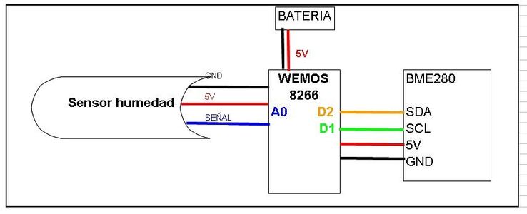

Electrical Connections
The CPU is powered with 5 V and supplies energy to the sensors. The connections are as follows:
* Capacitive sensor:
* `VCC` → `5V`
* `GND` → `GND`
* `SIG` → `A0` (analog input)
* BME280 sensor (I²C):
* `VCC` → `5V`
* `GND` → `GND`
* `SDA` → `D1`
* `SCL` → `D2`

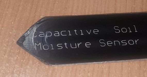

The original sensor, designed for soil insertion, was modified by cutting the curved part of its traces to allow uniform immersion in a plastic tube acting as a water container. The electronic components and the edges of the board were sealed with transparent adhesive to protect them from moisture.

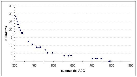

Step 2: Calibration and Data Modeling
The relationship between the ADC reading and water height (in mm) is not linear. Therefore, experimental calibration for each unit is essential, as the coefficients critically depend on the specific geometry of the assembly.
Methodology: The sensor is submerged at known depths, and ADC values are recorded. Multiple measurements at each point are recommended for averaging and reducing error, given the system's sensitivity. The measurements show a complex relationship that does not fit well with standard regressions.

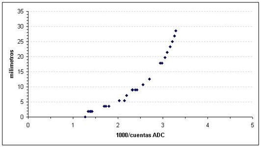

For this reason, a variable change was applied using `1000/ADC` as the independent variable, obtaining the following:
For our prototype, a high correlation (0.994) was achieved using a polynomial model of the reciprocal variable (1000/ADC). The resulting regression was:
`mm = a0 + a1(1000/ADC) + a2(1000/ADC)²`
where:
* `a0 = 8.486309`
* `a1 = -14.3801`
* `a2 = 6.064292`
The ADC values for a fixed height showed a standard deviation below 4 counts.

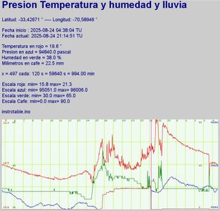

4. Web Server: Handles HTTP requests asynchronously. The `handleRoot()` function generates an HTML page with the latest values and an SVG graph of the last 24 hours, created by `drawGraph()`.

Initial tests were conducted indoors simulating rainfall with a dropper. The basic functionality of the measurement system, web server, and data chart was validated. The “mm of rain” values obtained are for testing purposes and require calibration under real conditions.
The chart displays variables plotted every 2 minutes to cover 24 hours. The lines on the right under the cursor show values from the previous day.

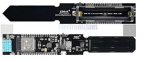

* Dedicated hardware: Use an ESP32 module with an integrated battery to simplify design and power management as shown:
