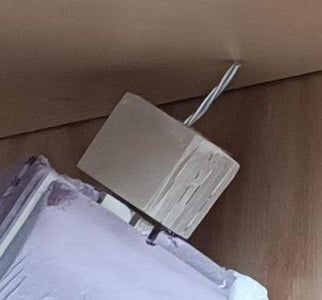

Step 7: Attaching All of Them
Drill a hole in the "Bone" of the arm, and in the hand.
Then put some hot glue in both the holes.
Plug the wire in.
You could also use more wire if you don't want it to spin.

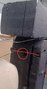

Step 8: The "shoulder"
You could add a block of foam for a shoulder pad, as it helps with covering the attaching of the arm.
But to attach the arm:
Drill a hole in the arm, the thickness of the wooden dowel
Then drill another hole perpendicular from the inside of the arm
Make a loop with the metal wire (don't cut the wire just yet, you still need to wrap it around the neck)
Put the looped wire into the 2nd perpendicular hole you made, aligning the loop to the other hole like shown in the diagram
Insert the dowel into the first hole, "threading" it into the loop midway through the hole, and out the other end.
Add stoppers on either side, and like before you can choose to make it flush to the arm.

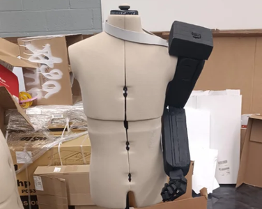

Step 10: Attach the "arm"
Make wrap the other end of the looped wire and loop it around through inside and out the subject of the matter requiring an arm. Add a strap of whatever to cover the wire so it's not as noticeable. There you go! A really nice arm that 'can' move!
