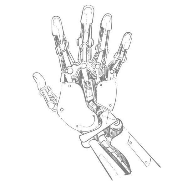

I have always wondered, how something so difficult, like prothesis is made. Well, now as I know a little bit of electrical engineering, I got this the answer. The secret lies in EMG sensor - it detetcts electrical impulses in the muscles, then amplifies and filtrates them and this signals go to the microcontroller. There these signals are evaluate and move servos. Pretty simple, right? But it's true only for cheap prothesis. Advanced one is far more difficult...
I wanted to make something interesting, so I added TFT screen, which can show different information like time, date, tempreture, humidity, gesture controll and battery life (Didn't finish last two thigs, though. I was in hurry as it was for my engineering conference).

Here are 3D models of every part of prothesis (I found them on the internet. You can use different model if you want). After you connect them together, you need to put strings into fingers and wipe them with servos, so they can pull fingers down. You can attach servos to the prothesis using different methods. I used scotch tape.
