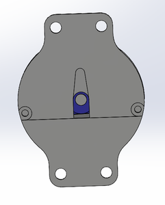

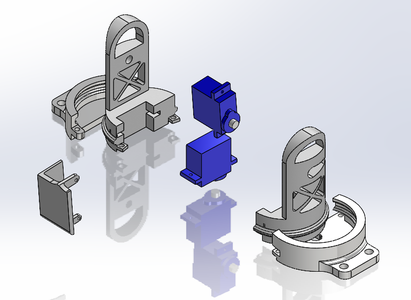

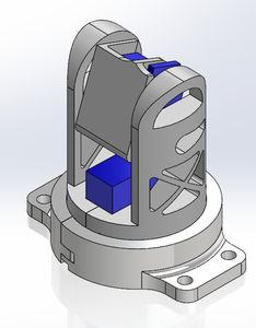

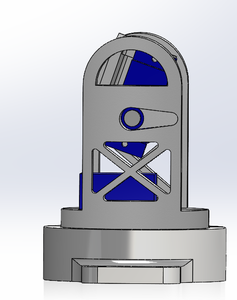

Step 1: Innovative 3-Part Rotating Mechanism With Integrated Protection
The core of this design revolves around a three-part rotating mechanism that ensures seamless movement and robust protection. The system consists of two outer locking components that securely enclose and stabilize the structure, while the central part—driven by a servo motor—enables smooth 360-degree rotation. This configuration not only provides precise control over the camera's movement but also offers enhanced protection against external impacts, ensuring the camera and internal components remain safe during operation. The interlocking design of the outer parts ensures structural integrity, while the servo-driven central mechanism delivers reliable and efficient rotation for optimal functionality.

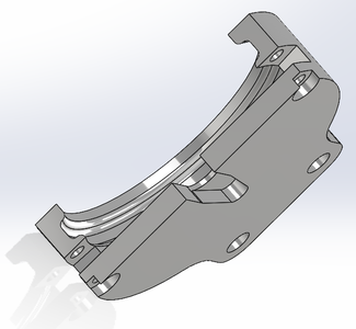

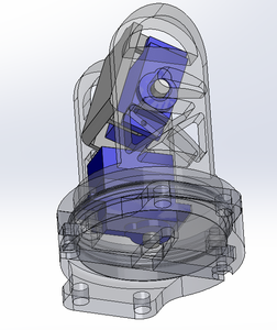

Step 2: Optimized Shaft Clearance for Uninterrupted Rotation
The system operates effectively but occasionally experiences jamming due to the bolt interfering with the base plate or minor loads on the motor shaft. To address this, a precision cutout was introduced at the center of the motor shaft, providing additional clearance. This modification eliminates contact between the shaft and the bolt, ensuring uninterrupted, smooth rotation and preventing any binding or obstruction with the base plate, thereby enhancing overall performance and reliability.

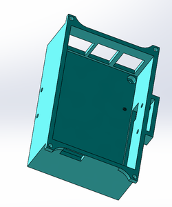

Step 3: Precision Bolt Integration for Seamless Design and Functionality
This section highlights the meticulous design process to ensure all nuts and bolts are fully concealed within the 3D-printed components. By carefully calculating the bolt hole depths, each fastener is securely embedded, maintaining a clean and polished exterior while ensuring structural integrity. This approach not only enhances the aesthetic appeal of the design but also provides sufficient depth for bolts to sit flush, ensuring a seamless and professional finish that aligns with both functional and design requirements.

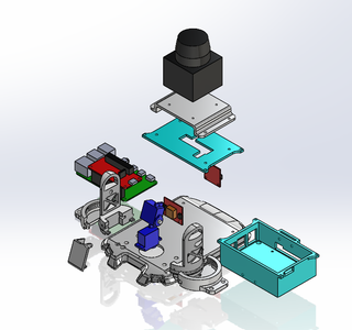

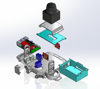

Step 4: Exploded View
Below is a list of key components:
- LiDAR Sensor
- Rear-Facing Camera
- 3D-Printed Structural Parts
- Servo Motor
- Main Control Circuit

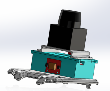

Step 5: Final Product Design Showcase
The final assembled product features a sleek, compact design with seamless integration of the 360-degree rotating camera mechanism and 3D-printed protective enclosure, combining functionality, durability, and aesthetic appeal.
