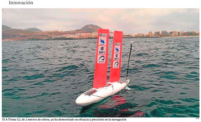

- A-Trima: https://1.bp.blogspot.com/-73tqwqNt_d8/WAZV3n6bStI...

The top 3 ones are companies, they seem to be doing good but their products are very expensive, or / and not publicly documented. Below #3 these are mostly universities efforts and are either not super stable or not fully sharing their documentation - some are open source (hi5!). I would like to bridge that gap.
