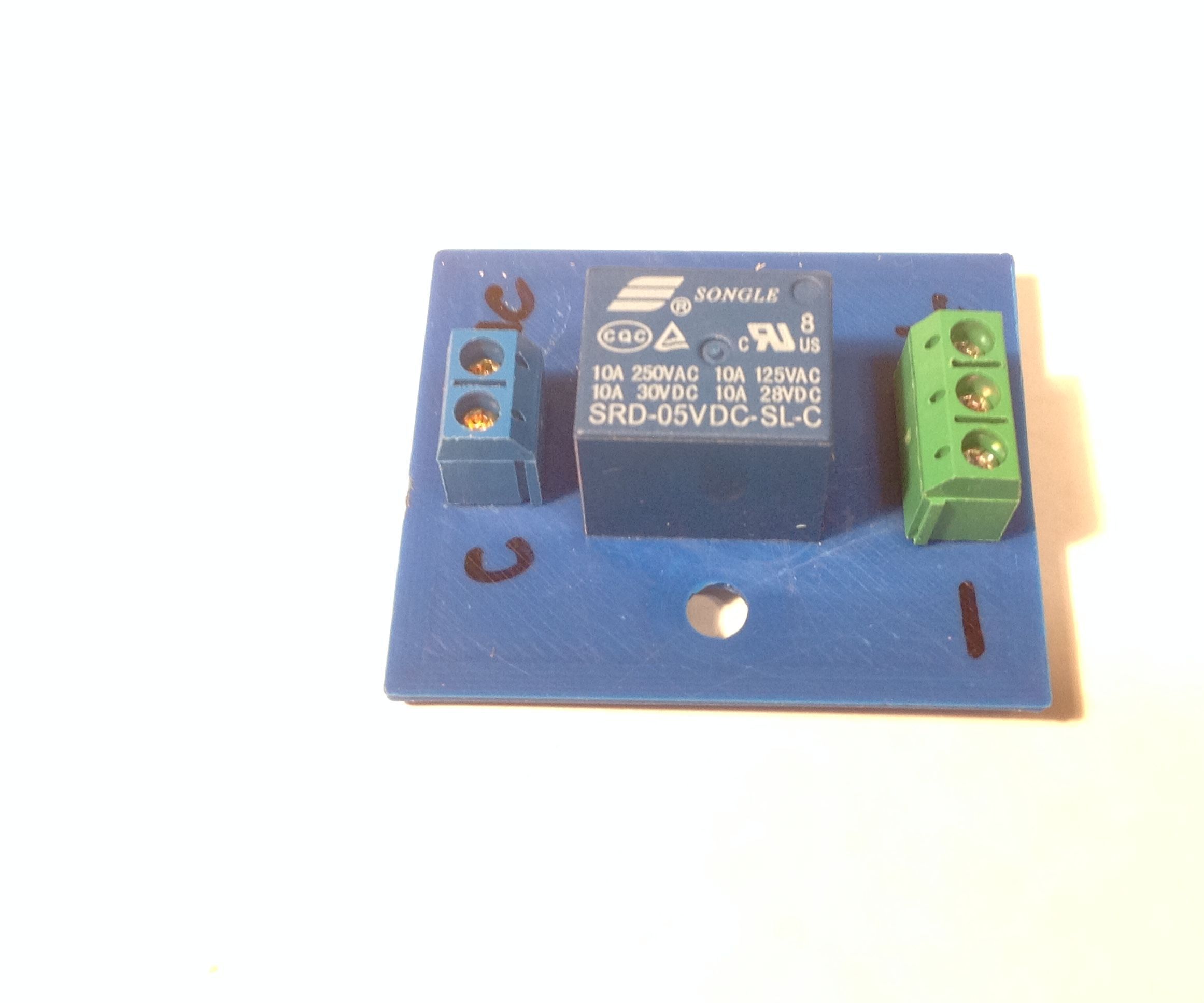

Step 3: Test Bed Setup
This photo shows 2 protoboard adapters ready for attachment to a strip of 3/4 inch plywood. The protoboard on the right contains an Arduino NANO. Between the 2 MB-102s is an Arduino UNO which will not install in a protoboard.
My intention is to use the rest of the plywood strip (not shown) for mounting other electronics parts such as displays, keypads, servos, pots, etc. I'll try to make some type of 3D mounting adapters for these parts so that they also are constrained.
