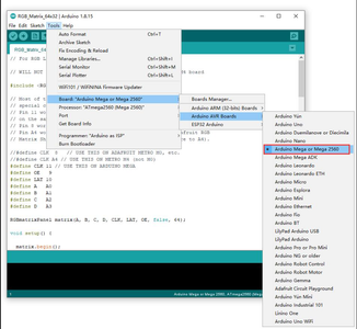

Step 1: IDE and Conections
The arduino mega and display need to be hooked up correctly following this schematic above you can connect everything correctly and when you do connect it up you will notice that the ribben chord is useless if you want to use it, and the chord that came with the RGB matrix is kinda useless as well, that 8$ pack of wires you bought is the replacement for the FtF useless chord and u can now use the shortest FtM chord in the pack to make the connections
when you do so make the changes in your ide software immediately so we can get them out of the way, this will most likely be your problem in the future

Step 5: Install the Correct Library's
Download 2 library's
https://github.com/adafruit/RGB-matrix-Panel
https://github.com/adafruit/Adafruit-GFX-Library
RGBmatrixPanel.h
Adafruit_GFX.h
after downloading go into your ide and follow this short tutorial on those librarys you just downloaded
https://docs.arduino.cc/software/ide-v1/tutorials/installing-libraries
a library is a bunch of code that will give Your code context on some functions and it makes your code easier to read
