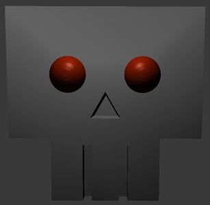

Step 1: Your 3D Model
Create a 3D Model of your idea
The first step in prototyping your project with 3D printing is the 3D model. If you already have a model, skip this step. If you don't, you'll need to create one. I recommend using Autodesk 123D Design, but any 3D modeling software should work. The software will take some time to get the hang of, but it is much easier than some others. My idea was to create a retro skull with flashing led eyes (I didn't model this, just downloaded it from thingiverse here).

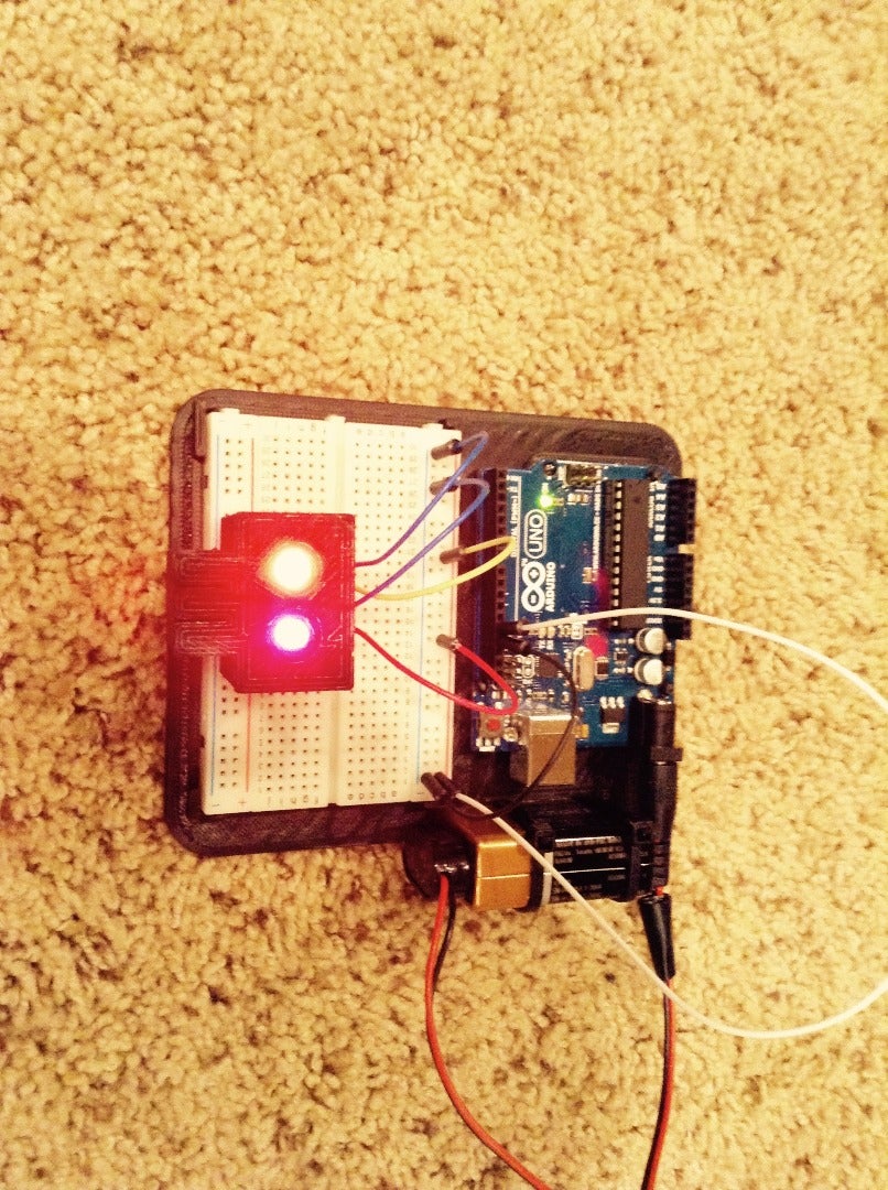

Step 4: Assemble the Prototyping Plate
On the Arduino, there are four holes. Two of them are closer together than the other two. Place the holes on the pegs, aligning the closer holes up to the closer pegs. Next, put a half size breadboard into the holder. You may want to secure it with adhesive, but it should work well without it. Now, take two Zip Ties and place them through the slot as shown. Tighten them around a 9 volt battery with the terminals by the breadboard, then clip off the extra. Last of all, plug the 9 volt battery into the arduino using the power cable.

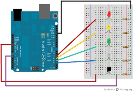

Step 5: Add Electronics to Your Model
Now you can prototype circuits and code on the plate. Once you have a working circuit and code, add the electronics to your model, upload the code to the Arduino, and you're done! Please vote for me and share this if you like it!
