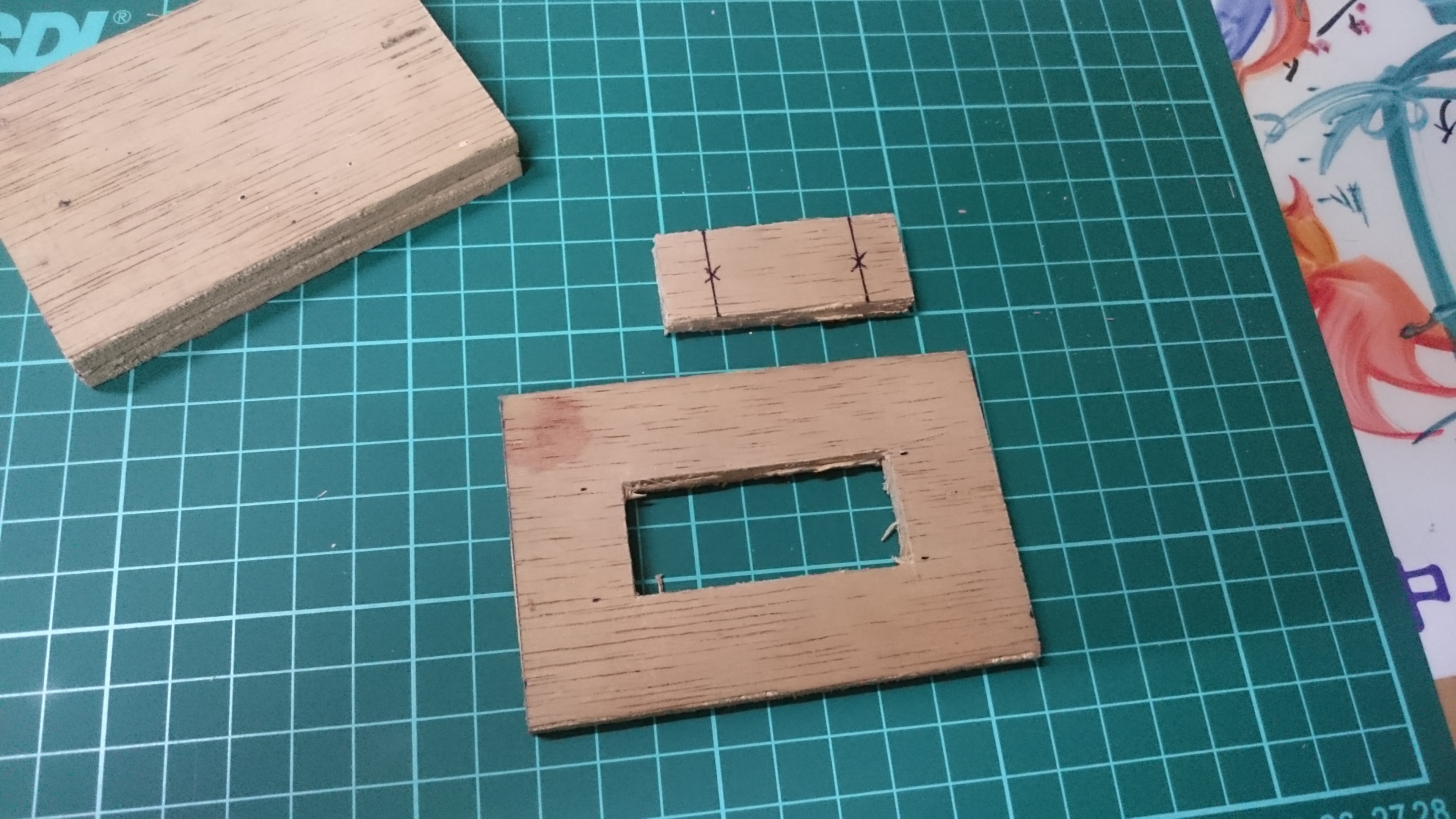

Step 2: Cut Out the Inner Board
The middle board functions as table leg. Because a table can't stand on one leg, then I cut out the center of that board so that it can flip and I can position it vertically to support the table top. The outer board and inner board are connected with a center pin through them.
This is the hardest part of the entire project : cutting out the inner board. Use your cutter/pencil knife and ruler and start digging until your cutter go through the other side. Do it patiently. I was in a hurry, time is ticking and the remaining days to enter the contest is decreasing.

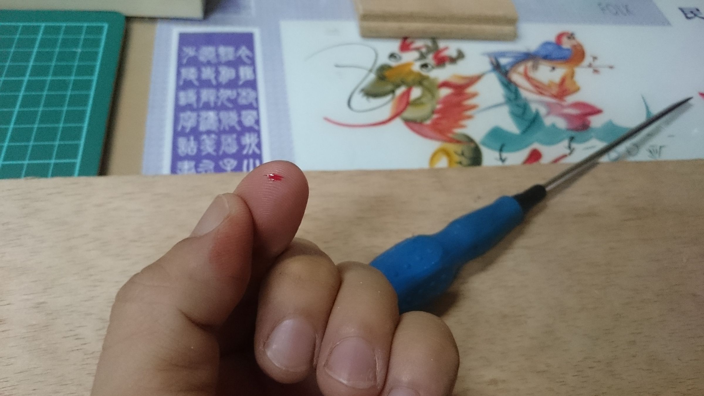

Oouch... Finally I cut my finger ... (-_-")

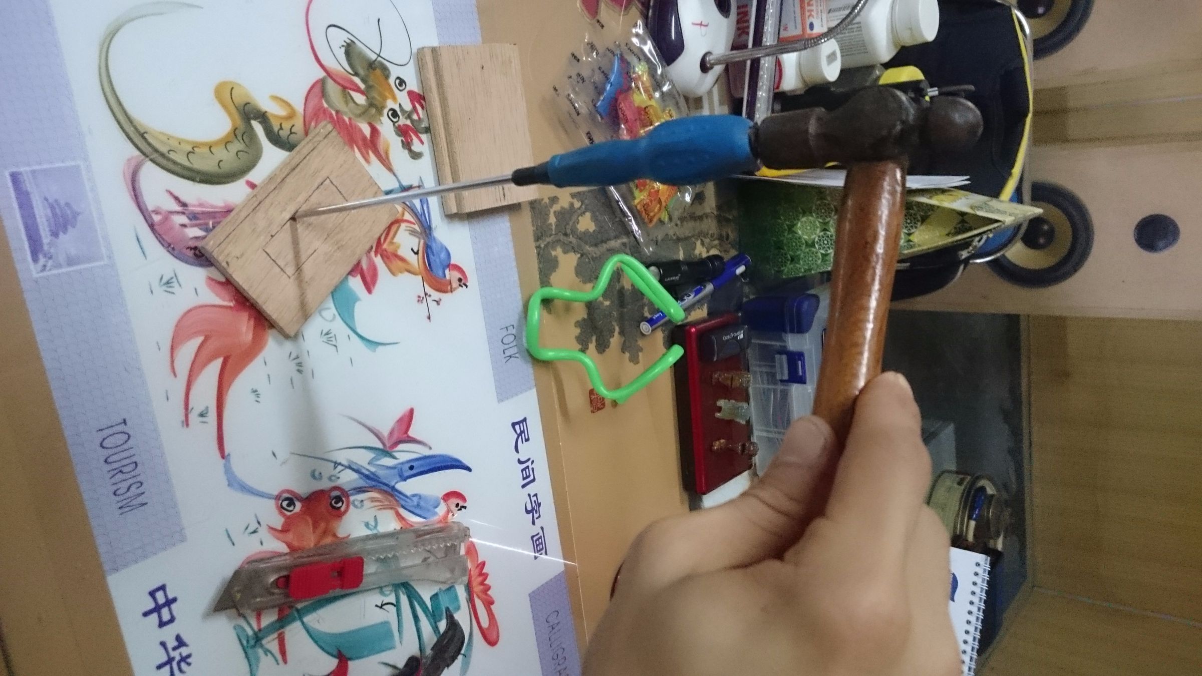

A mini hammer and a thin screwdriver help me dug faster. Remember to do it gently or you will break the plywood.
This is the problem I am facing in making the real size coffee table. I have no power tool to cut out the inner board. It will take me weeks to get the job done with traditional tools. If you have an extra board, making a hole on the main board with a drill and cutting a smaller board from the extra board to fit in the hole is much more easier.
Click to enlarge.
Well, we are done. Now smoothing the edges is easy with a cutter.
