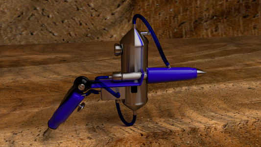

Step 6: Details, Details, Details
Though it's the outward appearance that most will see, it's important, in your 3D model that you detail all of the workings, and not just the exterior textured image. Parts that are internal to your prototype are especially important as you'll need to see how they fit into your finished design, and not end up surprised, later on should you have made a mistake in planning.
As you can see in the image, I've blocked some of the more important parts (the mixing chamber) of my project from view by texturing over them. That's because it is an extremely unique design that I don't want to display openly just yet, or at least until the final prototype is built. However, you'll notice that many of the internals are in place, with a few left to be created. In the final model, all of the internals will be visible in the wireframe for a detailed construction of the prototype.
Inevitably, this will leave less room for error in the final build.
