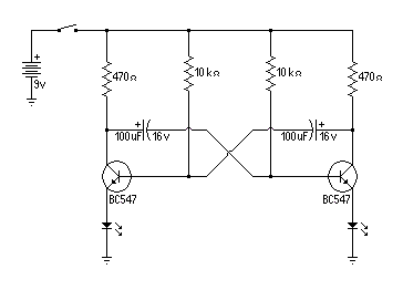

Step 16: Schematic
When you want a schematic of the breadboard circuit; remove anything you do not want in the schematic from the electronics lab work aria. Start by clicking the mouse on the item you do not want in the schematic and highlighting it. Then delete it by clicking the mouse on the trash icon on the left side of the lower menu bar or pressing the delete key on the keyboard.
After removing all the items you do not want in the schematic; click the mouse on the Schematic icon in the upper right menu bar and it sends you to the Schematic page.
Chances are when the schematics page comes up the components in the schematics page are all a jumble and in need of rearranging.
The lower menu bar in the schematics page has four icons on the left.

Highlight the components by clicking the mouse on the components.
Flip or rotate the components by clicking the mouse on the flip or rotate icon.
The wires move automatically.
Position the components by placing the mouse over the component and holding down the left button of the mouse, release the left button when the component is where you want it.
Do this until the schematic looks the way you want it to look.
